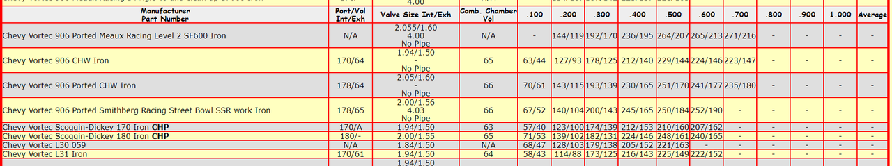

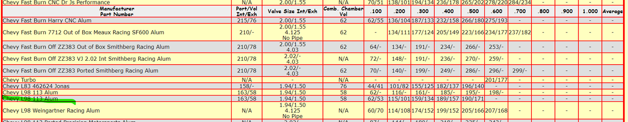

Here are also some flow numbers on the heads. It appears the 059 has a smaller intake valve, but the numbers seem to flow better?
I got these numbers from this site.
http://users.erols.com/srweiss/tablehdc.htm#Chevy

Only Direct drive inboards had reverse rotation. All Stearn drive use regular rotation.
I see a few problems with this plan:
1. IF those are Vortec heads, they'll be iron, so heavier.
2. You'll also need a Vortec specific lower intake manifold which will run you $4-500. So "Free" goes away, there.
3. If those are head for a 305, they're smaller combustion chamber and may be too high compression ratio for your car/combo.
4. That cam looks pretty lame.
If it were ME, and I were on a 'free' budget, I'd hand port my stock '90 heads and throw a used cam and/or rockers at it.

1. IF those are Vortec heads, they'll be iron, so heavier. - Yes, I am aware of this, but any aluminum performance heads are big $$, even if I bought new heads, they would most likely be iron.
2. You'll also need a Vortec specific lower intake manifold which will run you $4-500. So "Free" goes away, there. - Yes I am aware of this as well, I was figuring on if this worked it would still be considerably less than a set of performance heads.
3. If those are head for a 305, they're smaller combustion chamber and may be too high compression ratio for your car/combo. Thank you, this is exactly the type of information I'm looking for.
4. That cam looks pretty lame. Again, good information, thank you!
If it were ME, and I were on a 'free' budget, I'd hand port my stock '90 heads and throw a used cam and/or rockers at it. I gave up most machine/fab work a long time ago. Mechanical sure, but I'm not good enough at this type of work to justify doing it myself.
Thanks for your input. My thoughts are above.

I guess I'd look for used heads.
I guess I'd consider 350/L31 Vortec heads....but adding weight and then paying for a new lower? I don't think that I could convince myself to move on that.
I don't know where your priorities fall, but you could get some 350 Vortec heads cheap (you can get them at pick 'n pull yards here for about $35/head) and then double stack intake gaskets, keep your lower and get 15-20hp for less than $100 bux. I guess that would be a thing I could maybe talk myself into...since the investment is so low.
Cam? I'd search the classifieds for a used roller cam of about the right size. For ME, on a stock TPI that would be in the 2-teens duration.
