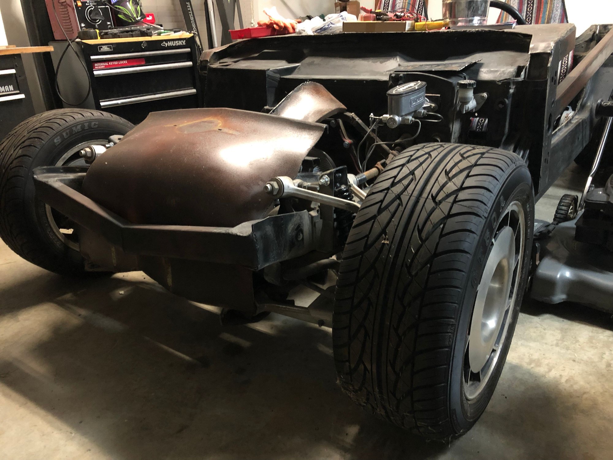

I'd still go motorcycle shocks. Cut off the upper shock cradle completely and make your own, or do remove mounted shocks (way easier than it sounds).

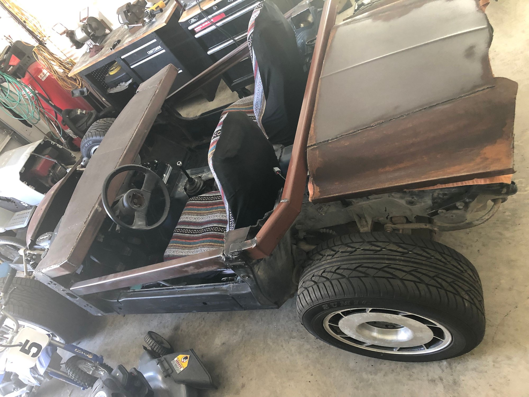

Motorcycle coilovers. 270/345 progressive. Thank you to all that chimed in!

C4s have everything I wanted in a chassis but this one was a basket case. I rolled with it because I got it for almost nothing, parted it out to break even, and it came with a WC T5 which I knew would work for a moderate build. I made an electric because I had never done it before and eventually we are all going to see electric hot rods. The C4 kart look is also an accident, I wanted to find a devin body but couldn’t get one in TX. I think this will eventually be more rat rod and less kart but I’m no judge, just a tinkering addict. Cheers!
