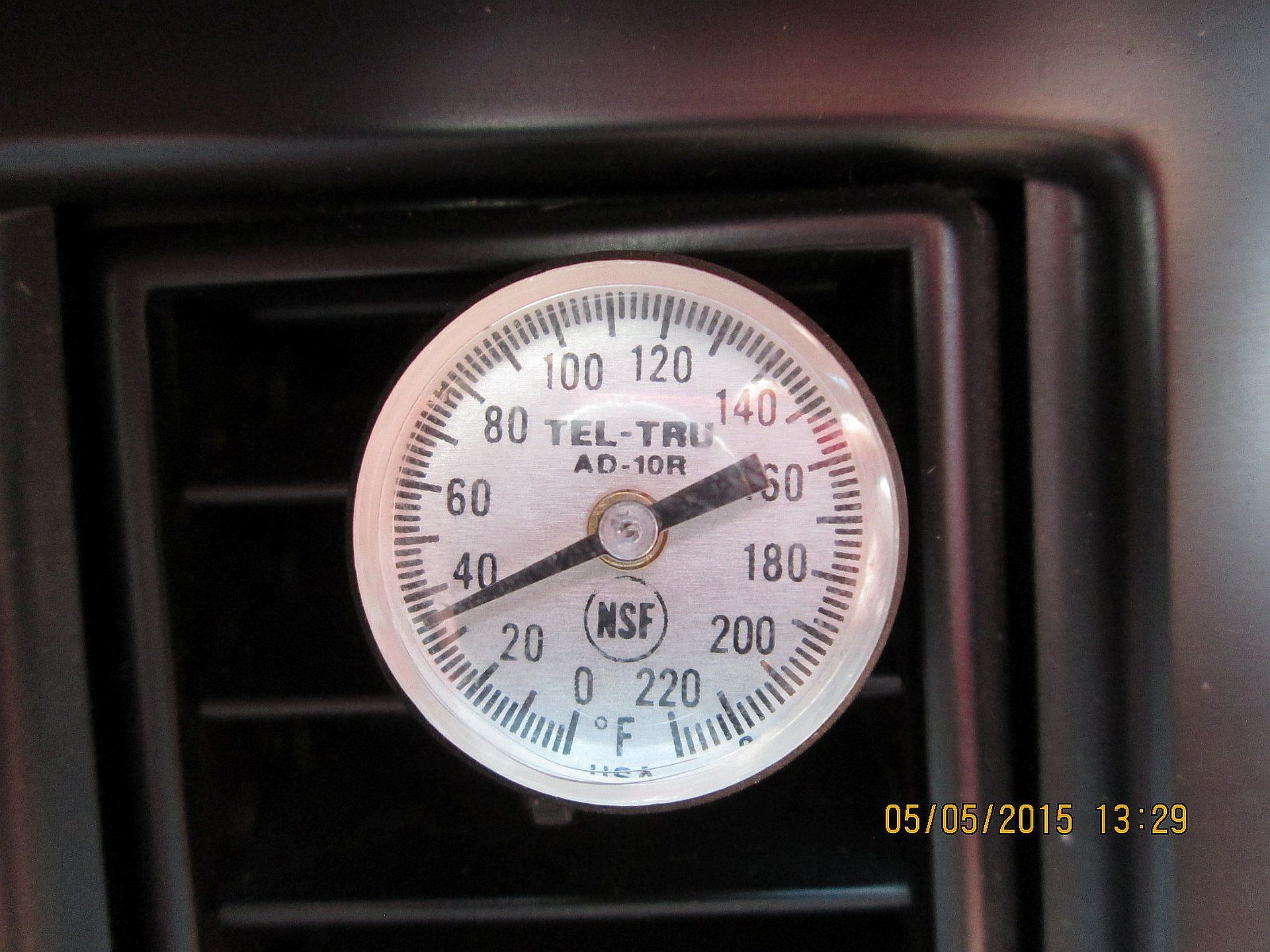

I respectfully disagree.....
The numbers don't lie....R12 in an R12 system.

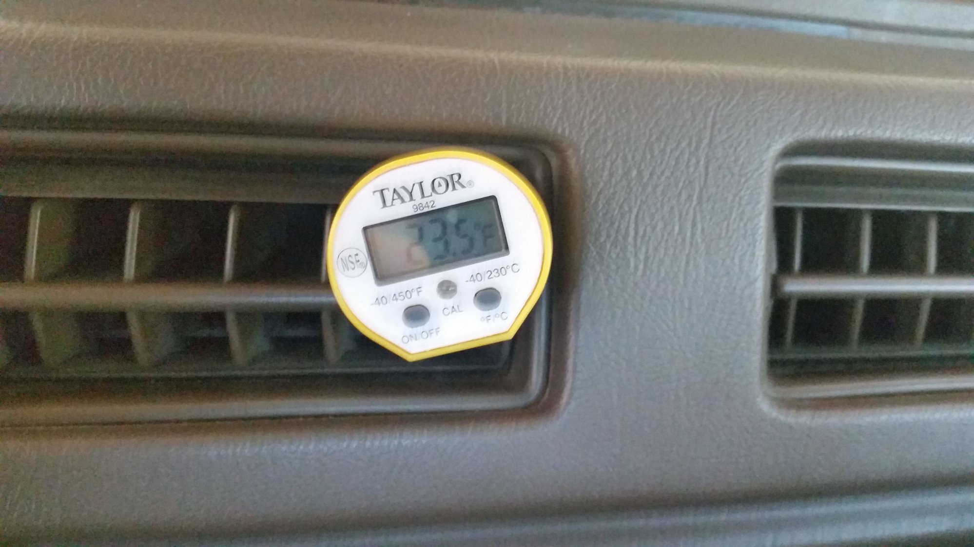

This is an R12 system on an old 87 Raider. It was around 85 outside. R12 way better the 134 anything. That's at idle too.

Joe - I meant no disrespect with my last post, and I completely agree 100% with the clarified version of your of the original statement. From what I have read on the topic over the years, and the numbers I have seen other members post, I have drawn the conclusion that converting an R12 system to 134a will not give the performance that the system was originally designed for when using R12. A converted system will blow "cool" air, but not cold air.
The numbers that I posted were from my '76...which was even older technology.

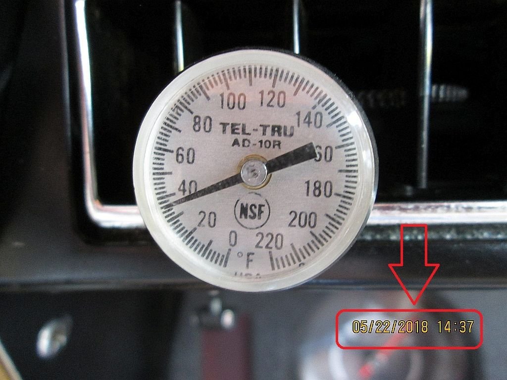

Below is a shot from my '87. I didn't take a screenshot of the weather that day, but it was comparable to the weather on the day I snapped the stats from my '76. On the 87, I actually had to add an adjustable low pressure switch after installing a new parallel flow condenser. The parallel flow condensers are so much more efficient at thermal transfer than the tube & fin condensers that after charging the system to the recommended pressures in the FSM, I was getting icing on the evaporator core. Raising the cut off slightly on the low pressure side fixed that. Temp at the center vent was nearly dead on with that of the '76, both using R12.
My intent was merely to point out to the OP that keeping his R12 system original would give the optimum performance the system was designed for.
My current '86s performance is a mirror image of the picture above.
