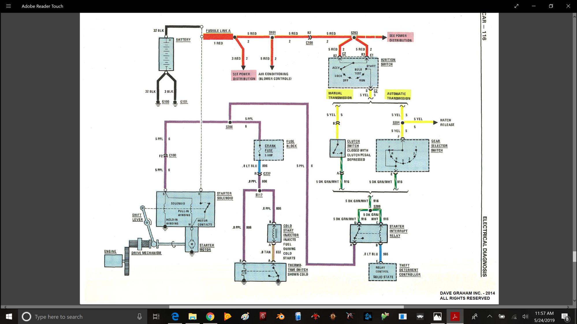

Hey all I have an 85 c4, the neutral saftey switch is going bad fast.... that is not an available part anymore, so I'm trying to run a bypass, or jump.... I need to know A what gauge the wires are, and B i know the wires on the switch are black... but what color are the wires that they connect to... i believe that they are green/white stripe and yellow... am i correct? Dont want mess up the wrong harness... thanks , my guy replaced the starter, and it still has sporadic starts.. and i got to push the dang clutch pedal almost through the floor... thanks friends....

Thanks for the information, that's great and all but what color are the wires that the two black wires ( coming from the switch) connect to? I believe it's green and white stripe and a yellow.... I do appreciate the help though. Please dont think I dont... my shop manual doesn't say exactly, and my wiring diagrams are in black and white.... dam shame they dont make that part anymore... cheers

I think I found my answer . I forgot I had the PDF of my shop manual.... So yeah I was right the wires are heavy gauge and yeah the yellow is the hot and it breaks to the green white wire.... Thanks for all your help in locating it....
