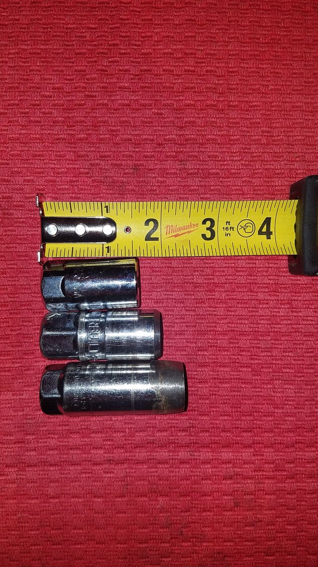

Originally Posted by BrianCunningham
I did last time I changed them. Works good. I had cut a spark plug socket down years ago, and for some reason the last time I did plugs I could figure out why it wouldnt fit.. Take the rubber and use the tool you made, not the wrong one.
I had actually made two, and couldnt find the other, as it had been so long..
So, I have an extra. PM your address and I will send it to ya..The summit one.
So, if you can get to a machine shop have one cut down.
