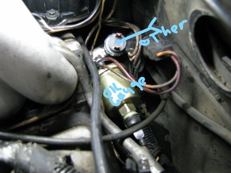

On the 85 you need to replace the other oil pressure switch next to the oil pressure switch if it is old and rusty also. it gets pressure to get the fuel pump going we believe.
Will this myth ever die?
The Fuel Pump Relay is the primary power source for the Fuel Pump
ECM Primes for two seconds, FP relay sends power once ignition signals are sent, the Oil Pressure switch is a BACK UP, or a second leg of power. It's failure or its detection of low oil pressure will not stop the fuel pump from working unless the relay is also bad.
Look at the wiring diagram:
