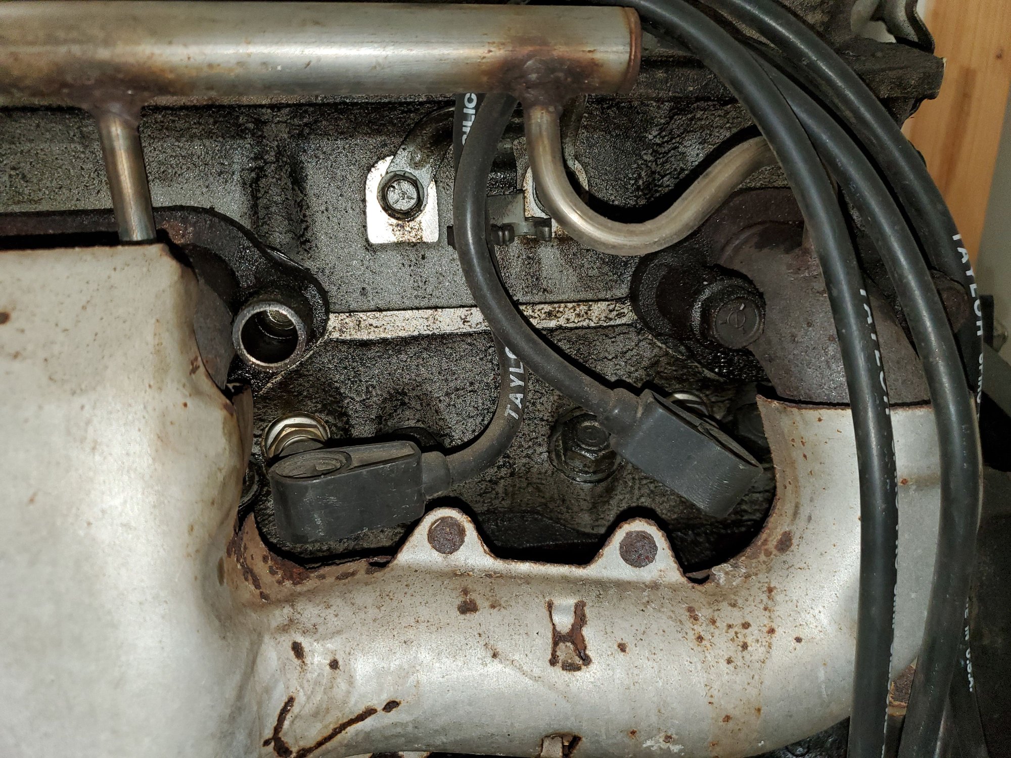

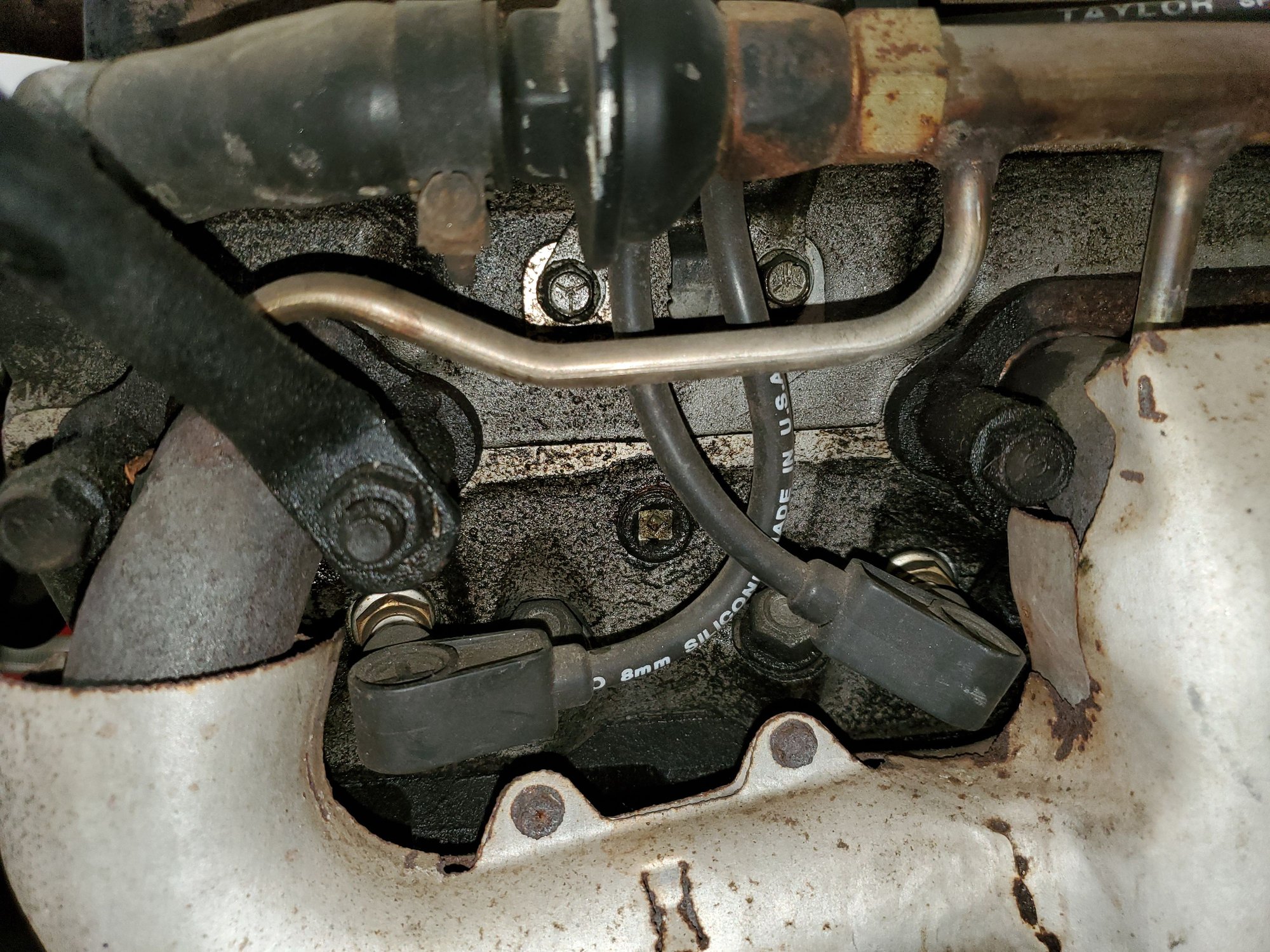

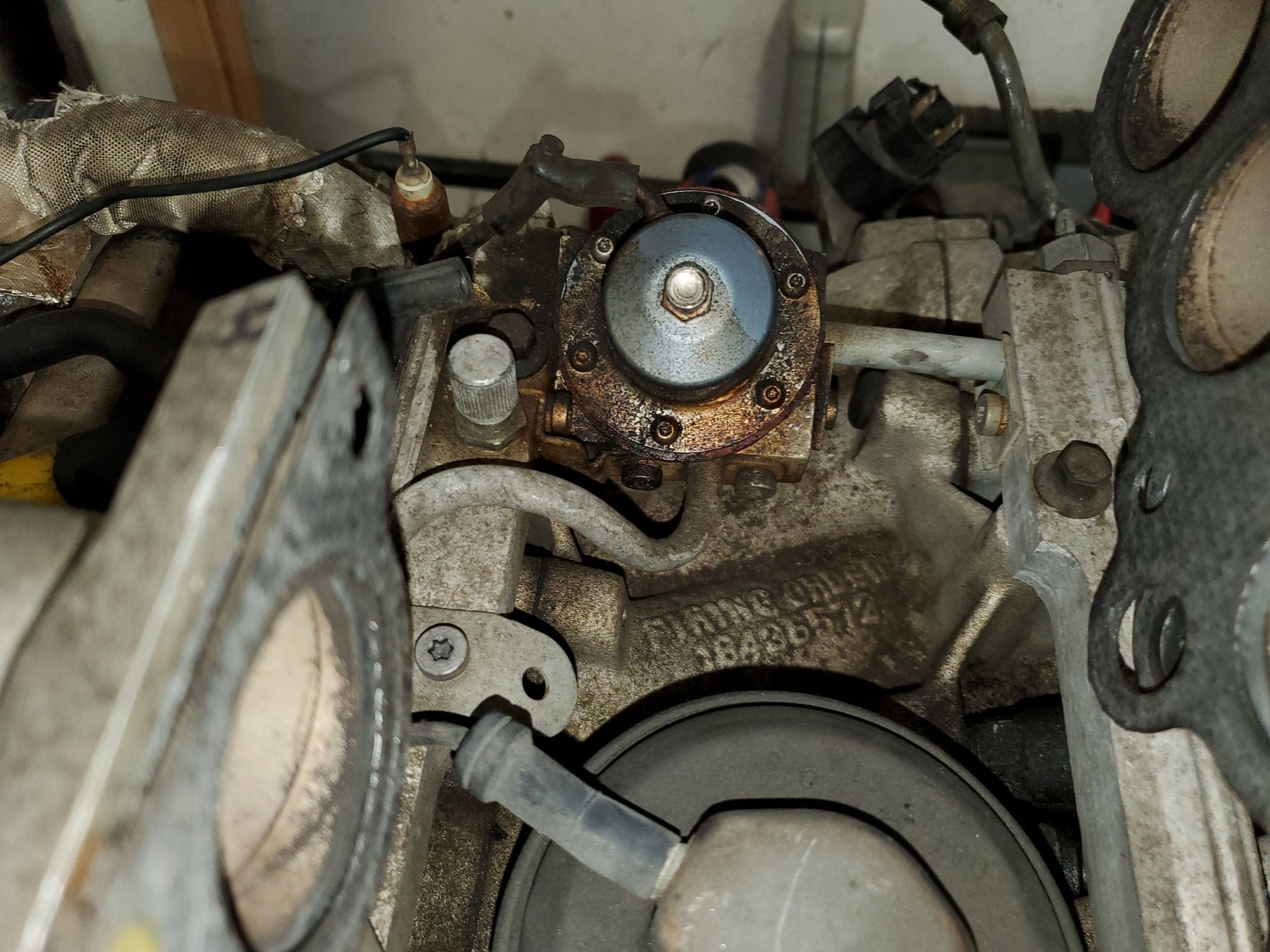

I finally have the motor and trans out of the 87 and got the motor out of the 86 vette. I'm looking it over now. All the plugs check out fine and are all the same BUT they are covered in a lot of carbon buildup (see pic below). Could this be a result of the exhaust being gutted? The pre cars have been eliminated, the main cat was gutted and all that's there are two flow master mufflers.
I figured I'd leave the 86 trans in since it only has 47k miles on it and ran fine but that was 3 or 4 years ago that it ran. Any suggestions for checking it over other than checking out the trans fluid? I do plan on putting in a new filter kit and filling with new fluid.
As far as the engine goes, here are a bunch of pics of it out of the car. This is the 87 engine. Do yall mind looking it over (see more pics below) and tell me if anything looks concerning to you? I am still thinking the budget build. But I'm not sure if I want to extend this build and do more to it as funds become available or just do the essentials and get it on the road.
From what I see at minimum I need front crank seal, valve cover and oil pan gaskets. Maybe replace the freeze plugs? Water pump (and gaskets) should be done. So, now that you have seen the pics does it change what else at a min should be done?

No, a gutted exhaust will not cause the carbon buildup you have. It is an engine running way-way too rich for a long time.... That was a lot of carbon.
One of the first things I would do is clean the engine down thoroughly. While cleaning it try to identify the leaking gaskets and /or parts.
Maybe it might be worthwhile to perform a Leak Down Test on your engine. This test is far more comprehensive than the standard compression test. And since the engine is not cranking while the test is performed means you can do it to an engine out of the car. Leak Down tests are performed on piston aircraft every day and a very good way to test your engine.
A leak down test will tell you if you have air blowing by the piston, a blown head gasket or any major issue with the engines internal parts. If you are not familiar with this test find a buddy to help you when you do it. Basically you are pressurizing the cylinder and watching where the air goes. If you have air coming out of the oil fill hole then you have excessive blow by. The tools are not very expensive and you will need a air compressor to perform the test. While you push say 100 psi into the cylinder you watch what it will hold on a second gauge, the higher the second number the better the cylinder is.
After you test this engine we can look at what inexpensive ways to make it last longer. I would not make any plans until you know what the problems are. Any plans before testing would be guessing and a waste of time and resources

You sure have some leaks there, going to need a lots of gaskets and a good cleaning. Make sure the motor rotates.

It ran perfect a few weeks ago before I pulled it. It turns no problem
