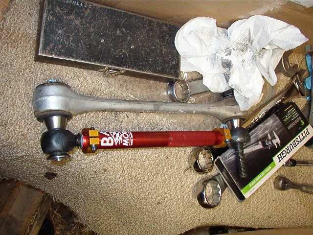

I don't know how you did yours being you used 2 levers but I needed only a single rod to get mine on. I lubed the thing up with dish soap then started the heim joint through the side hole. Pull it up as much as you can then slipped a 1/8" piece of brass rod to lever the sleeve around the heim joint. Snapped right into place and worked out great.
Here's another little tip that may save you some time and headaches. If you assemble a part then use the original as a setting gauge, you can adjust it very close to the original length, making your initial alignment closer. One other thing I did to mine was drill the various parts to use cotter pins to insure nothing came off by accident.

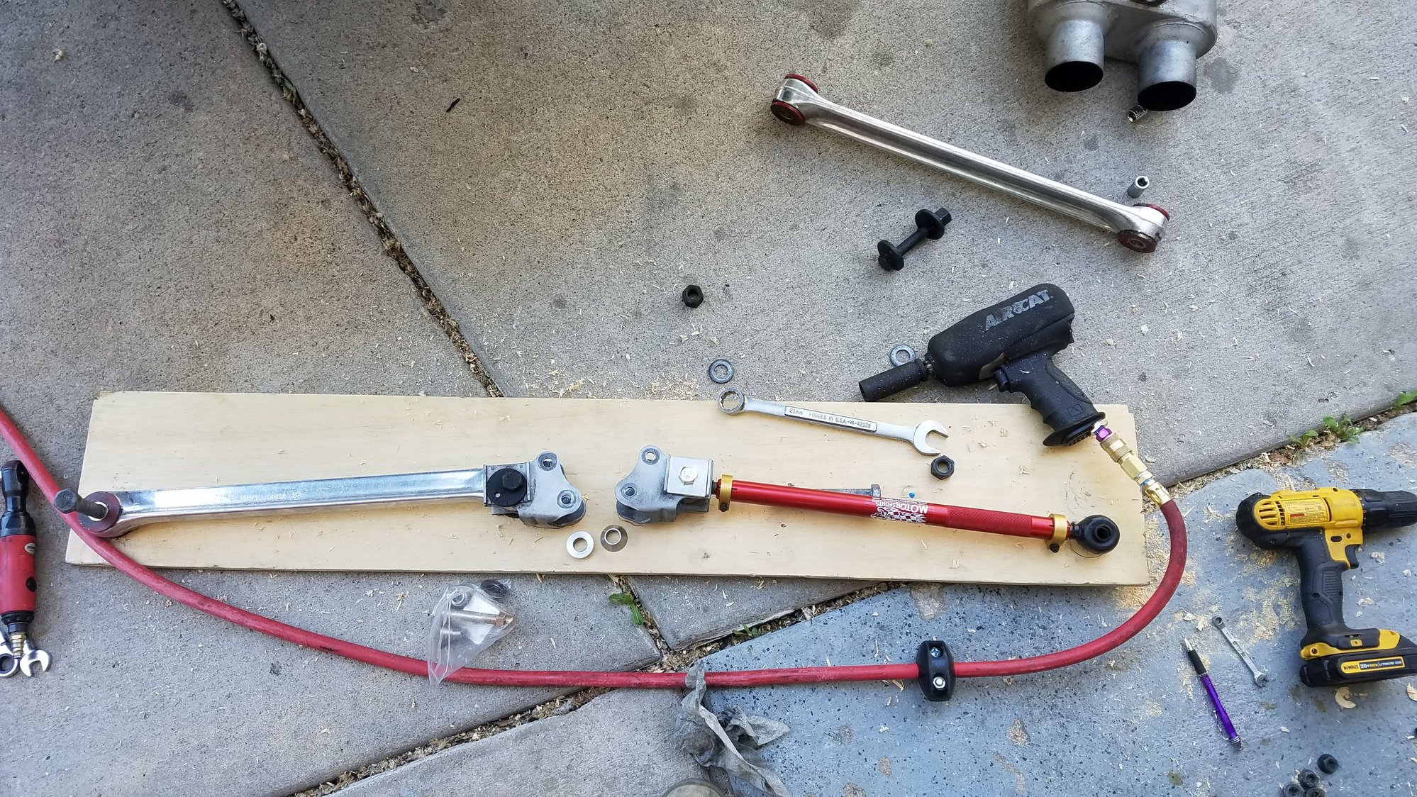

I ended up taking a piece of wood, and drilling holes for the oem bolts to thread through, then using the bolts to hold things in place i have a somewhat accurate gauge...
One down!
