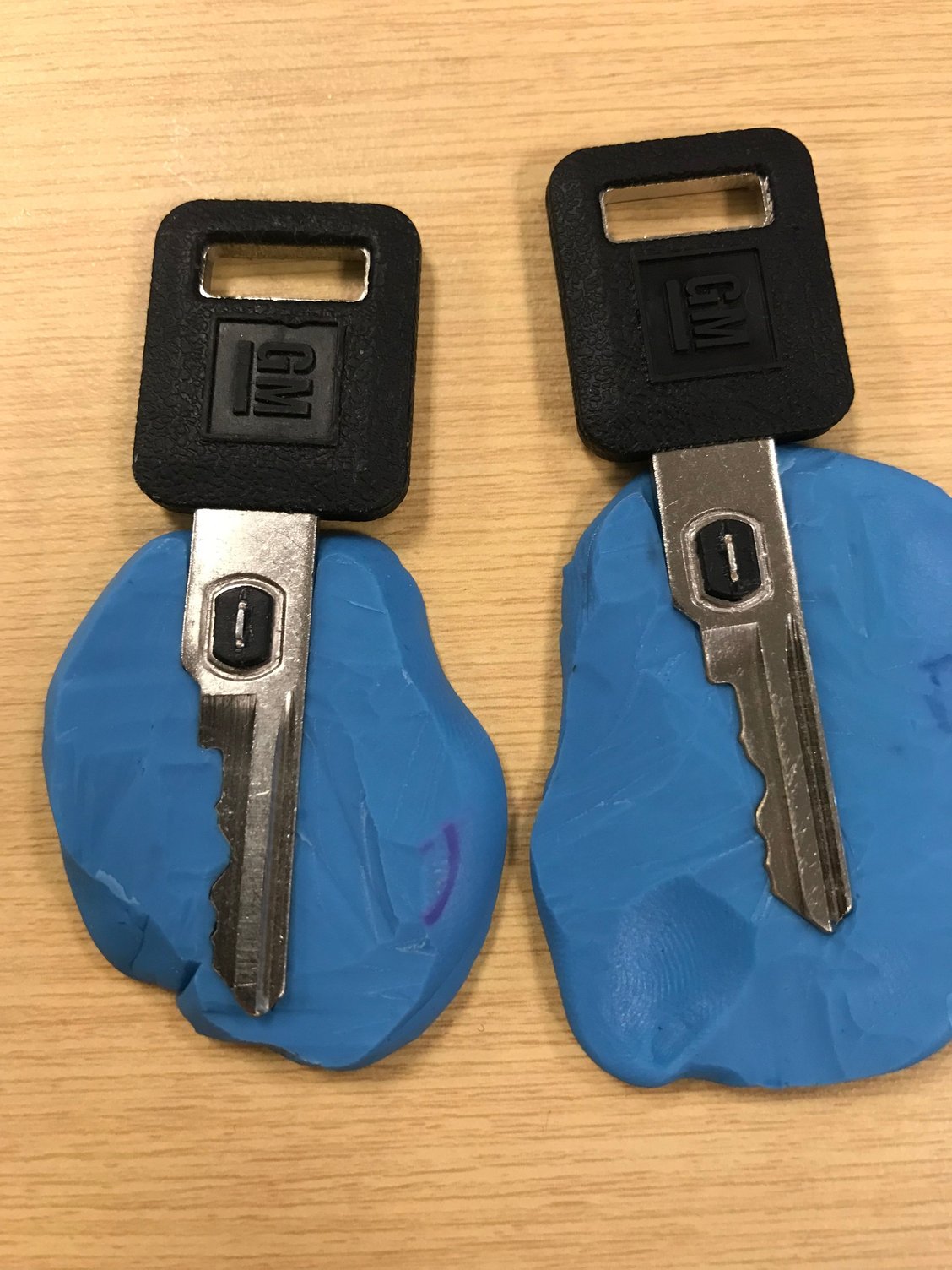

Originally Posted by Joe C
OK, who cut the key for you? about the only thing I can say is have a locksmith take a look a the keys. there may be something the average person is overlooking - ??? you may want to go to an actual dealer for a replacement, have them cut the blank, and go from there. there could be something with the cylinder lock and the key interaction. good luck -
I took it to a Chevy Dealership and paid $10 to have it cut. The good key on Left, bad key on right. 🤔
Checked it on the Ohms reader. They both read the same number. 🤔

It may be an optical illusion, but it looks to me like the length of the 2 keys is different from the resistor to the end of the key.
Optional illusion. I can take the keys and reverse them and they both fit perfectly in the other mold. Checked them with a microscope and don’t see a difference.
I ordered another key, but now I’m wondering if that one will work.
It goes in nicely, but just won’t turn.
Does the resistor allow the key to turn? Or is the connection to the resistor done when the key is turned and then makes the contact to start the car. 🤔
From my eye the left one looks like the main notch is deeper cut slightly.
Also, you might have to have another one cut from a blank but this time don't let them copy it, have them cut it using the VIN number.

+1 cut from VIN not from old key. As they wear the peaks are worn and it may not release the cylinder to turn.
How would that work from the Vin?
I’ll check the key in that area with calipers to see. Interesting. Thank you.

As has been mentioned, take it to a locksmith. They have a hand held "punch" that shears the key rather than grinding it from the worn key. Each pin land(I believe the GM key has 5) will be measured, wear accounted for, and the dials set on the key punch.

Originally Posted by WVZR-1
Guys - if the cylinder isn't original cut to VIN is a 'NO GO'! I mentioned asking a dealer to check!! I also mentioned 'IF' the code matched a VIN to attempt to cut the non worker with the 'CODE' vs a trace! I mentioned a 'work key' also. OP posted after that the key was done @ a dealer. The dealer owes him nothing but 'help' - it ain't their fault I'm surprised they charged but I asked a friend ( works @ delaer) a while ago and he said they charge for carry in blanks UNLESS it's a known good customer.
Its the original key cylinder for the car.
My whole car is pretty much original, other than the parts that wear over time. I have 21,300 miles on her (Sweetie).
I guess my best bet is to take it back to dealer, have them rerun the key and when I get the new key, have them go off the vin.
Still have one good key for now. But I’m SOL if this one goes bad.
Thank you everyone for you thoughts and help.
