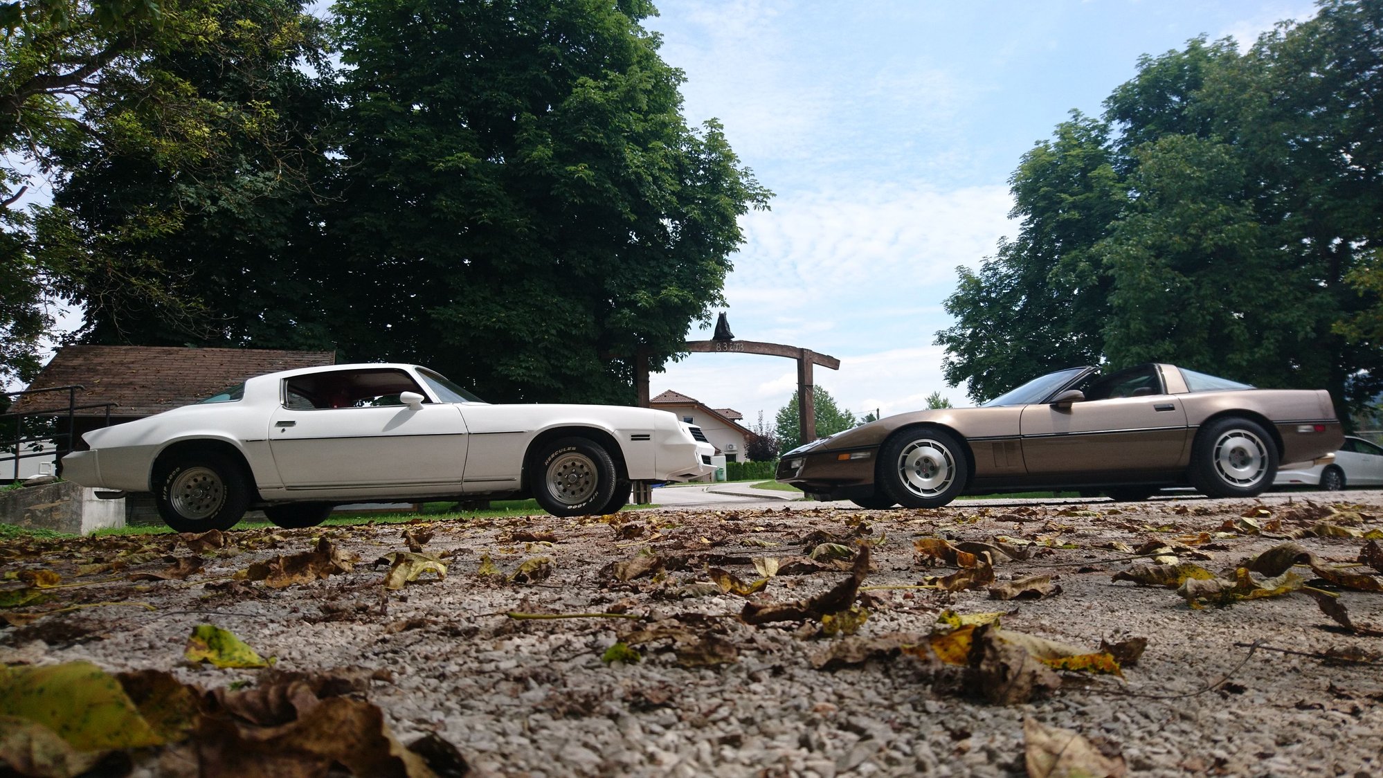

I’m new here and I own an original ‘86 corvette C4 for three years now. I have read lot of posts here on your forum- got nice know how about these cars.
Here my C4:
I use the car only as a summer car- here in Slovenia summer means approx. 3 months per year-no daily driver.. and also spring+ autumn time when no rain..

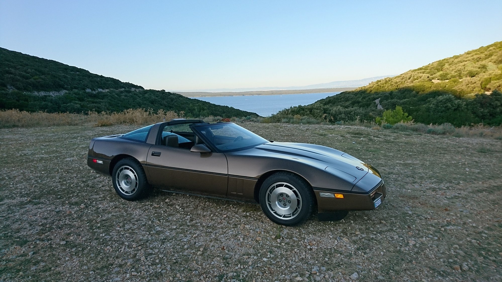

Few pics from the trip..

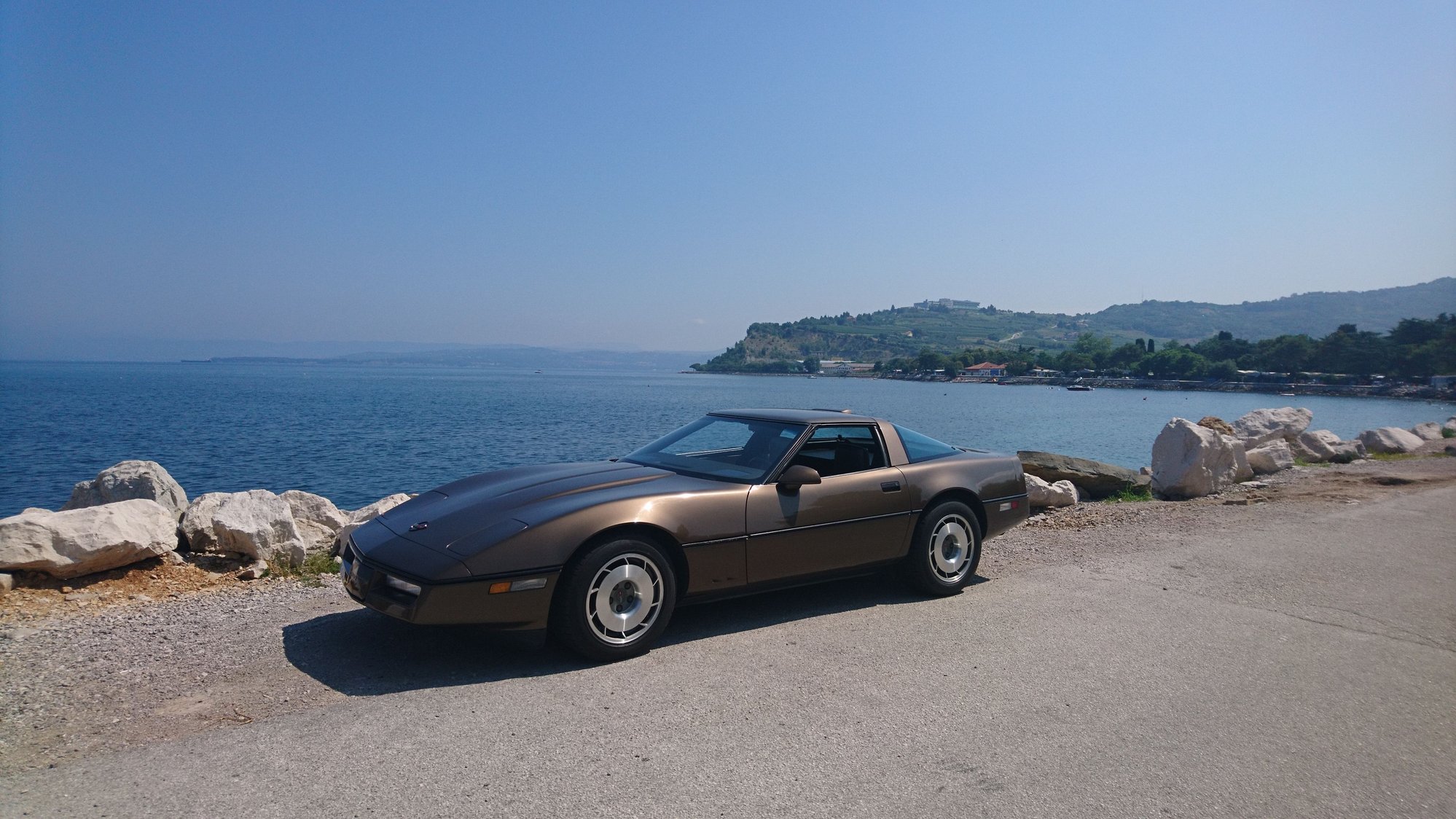

I did some long nice trips this year.. Perfect ride 😀 I enjoy! See pic from today..
