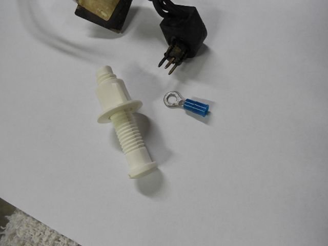

….. Nylon toilet seat bolt … drilled though end to end to just pass 12ga wire … inserted through the original connector hole (knocked the locater tang off) with fuel line O-rings on both sides … works better than new …..

That is quite the repair. Good idea. But all I'm doing is a quick splice.
