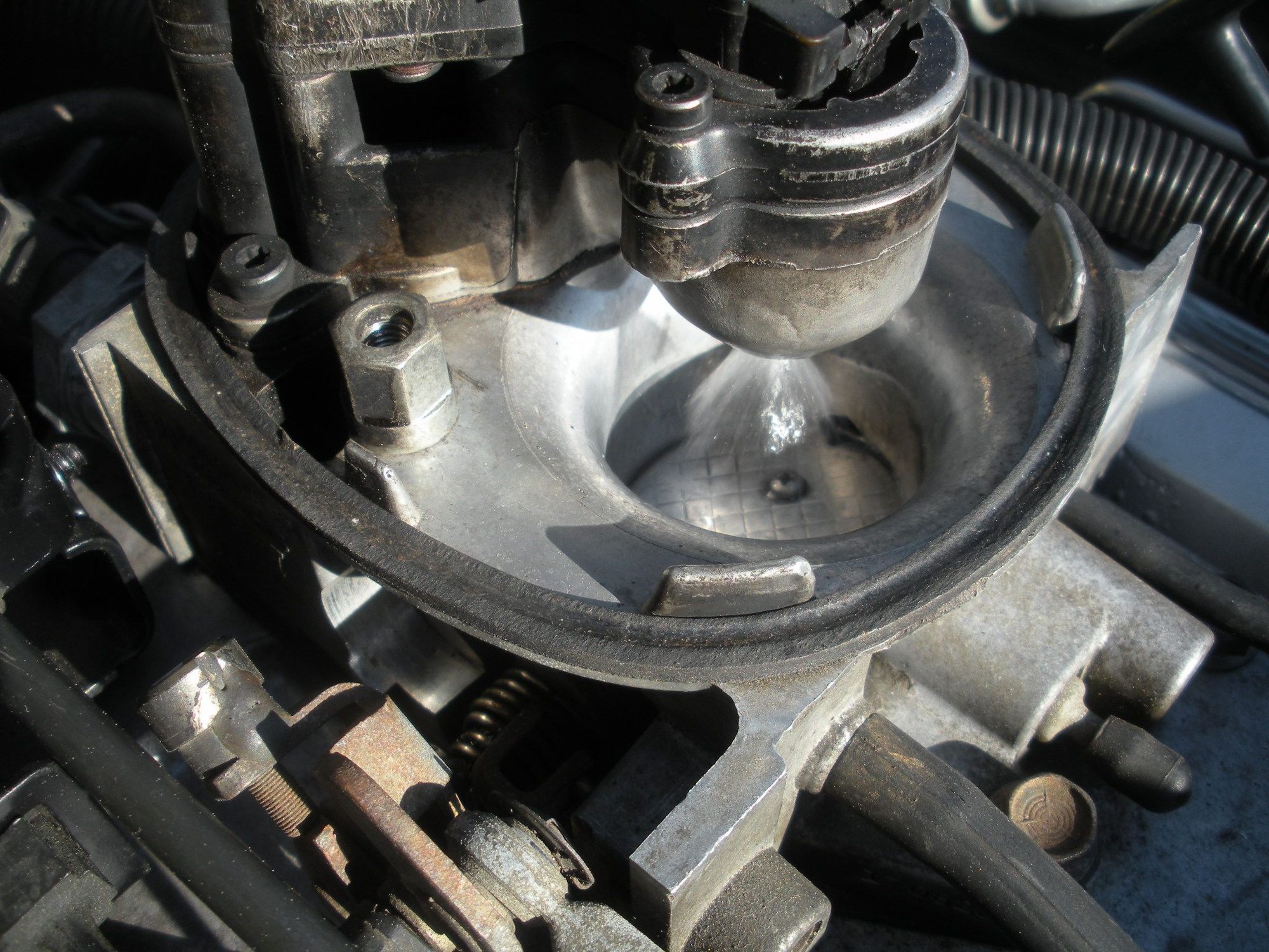

I rebuilt an 84 top to bottom. the engine almost starts but floods .what can be done to get proper fuel mixture any help would be appreciated.

Is the firing order and the ignition timing correct? Do you have spark to the #1 plug when the #1 piston is at approx. TDC on the compression stroke? Do you have a nice, smooth spray pattern? If the engine is flooding, are the injectors dribbling fuel when the engine is not rotating? What happens when you hold the throttle open while you're cranking the starter?

Everything is as u say. No dripping of fuel and good spray when cranking. Need more air to fuel. Tried throttle open and same. It wants to go but then fades out. Good burst at first then just turning
