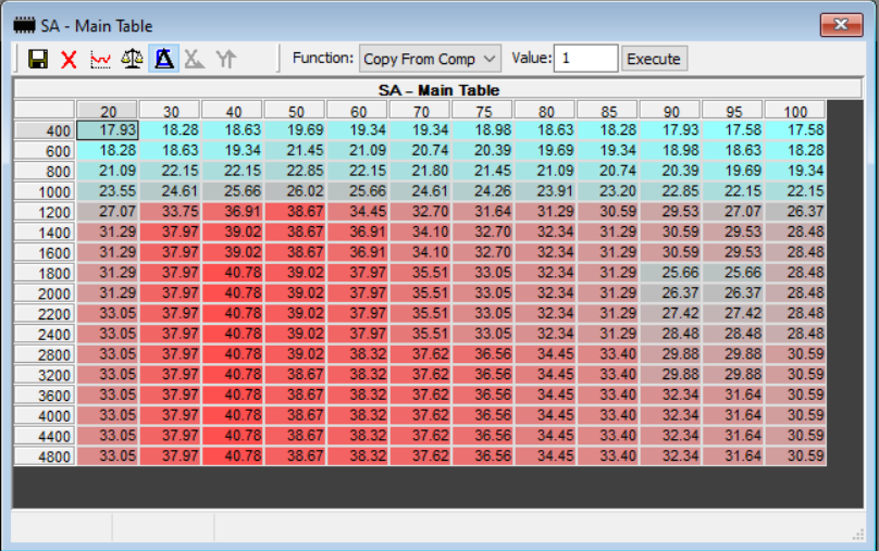

Here are some screenshots of my screwed up timing tables. I'll attach my tune file as well if possible. Then you can see everything including my not smoothed out VE tables. I'm honestly surprised how well the car runs considering the tune has been neglected for some time. It would help if I was with the car more than weekends and breaks. Even when I had the car at school I didn't really have time to sit down and work out the fine details. If I don't have it worked out by May I should at least have more time after I graduate.

First, the 93.6 mph on the 14.08 is two things: A GREAT ET, for the trap speed indicating a killer launch/60' time? And the other thing is tells me is the HP is just not where it should be, for the mods. I think you should be 270+ NET, chp with the intake and exhaust. But 93 mph is more like 220 hp. Or so.
Second, is it looks like your total advance is 30* at WOT? Is that right? If so, I think it needs more. Is it getting enough fuel? Are you still running stock injectors?
The WOT timing may be correct... There is a multiplier in the EBL that adds in extra timing while in power enrichment... I use that so if I do encounter spark knock it'll pull out a little extra. Usually starts throwing a degree at 2800 and 4 total by 4000. For me that amounts to 35 degrees total at wide open. I'll dig into the file later to see what is going on.

Yes it is 30* at WOT. That's still unchanged from the tune provided but Power Enrichment is enabled at that point so I'm getting an AFR of about 12. The injectors are technically stock but I had the throttle bodies rebuilt by Dr. Injector so the injectors were cleaned and tested then.
