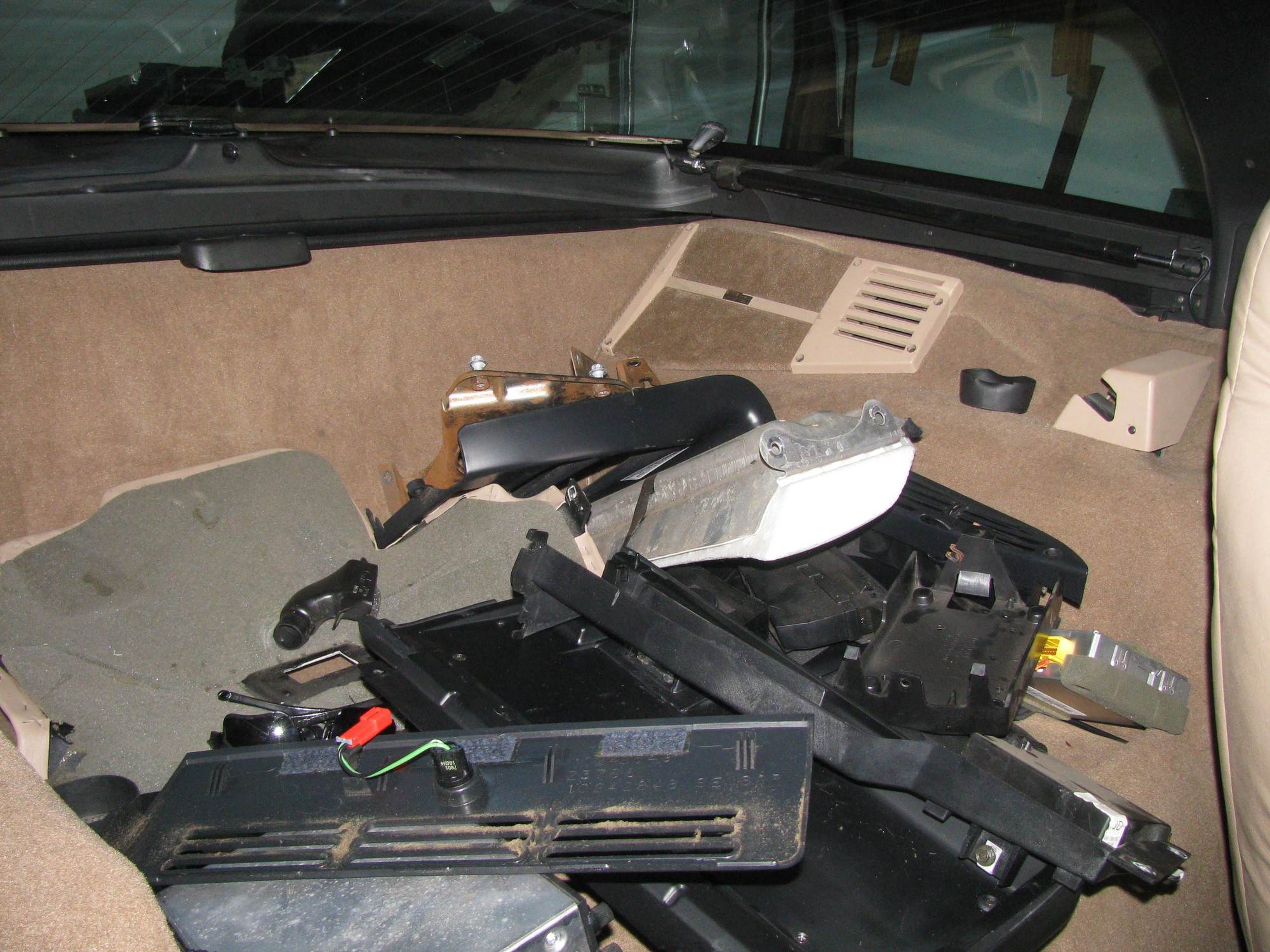

I did mine a couple years ago. It wasn't too bad, but time consuming. take pictures as you move along and bag the screws. Don't rush it, take your time. Here's a pic of the parts pile.

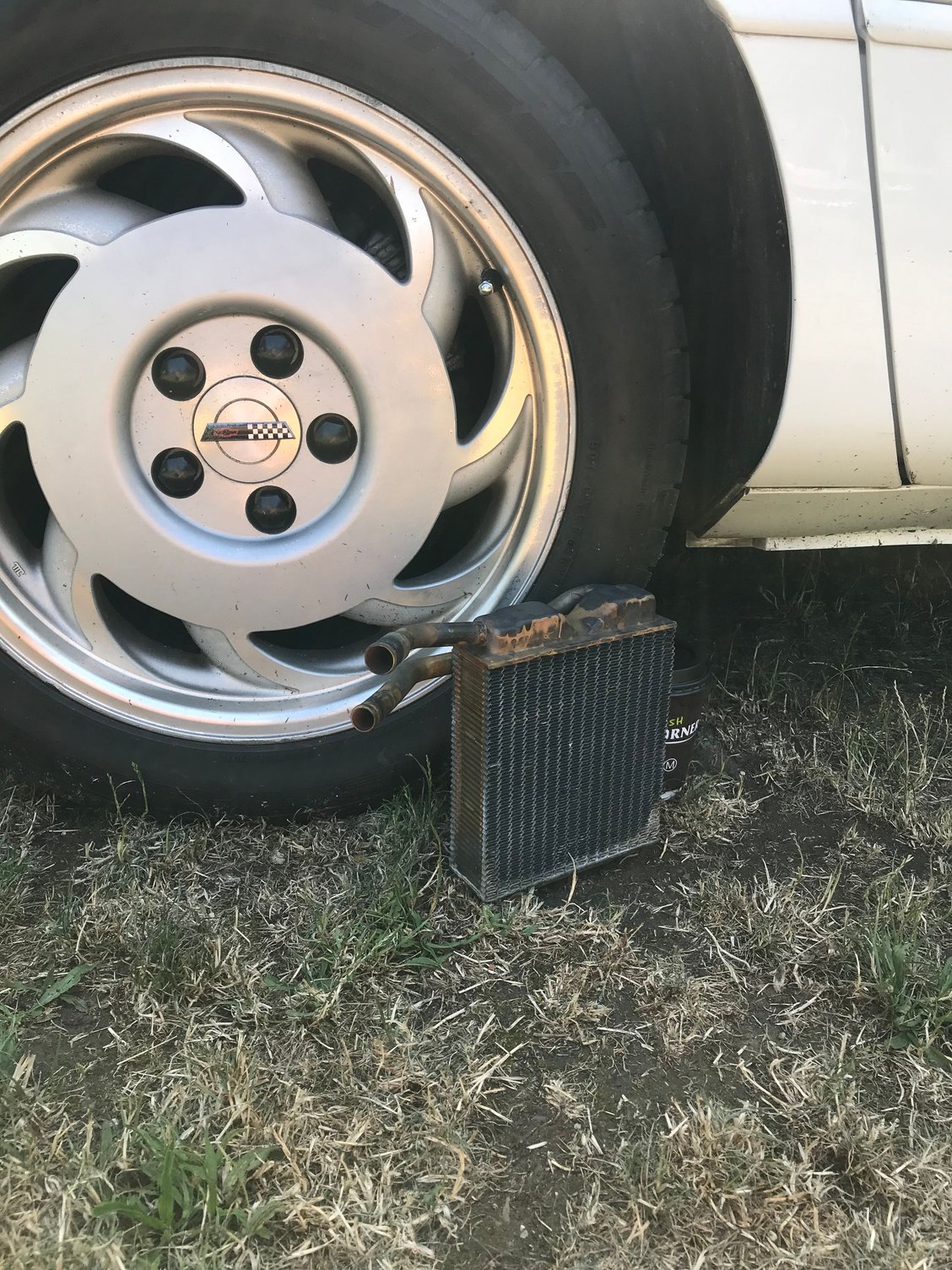

Default Job done
The little beast is out of the cage. Thanks for the advices, all of them were useful. The job took around 8 hours. It wasnt so bad, however crucial was to progress slowly and make pictures and notices about all parts, wires and bolts. Without that I wouldnt be able to put it back together.

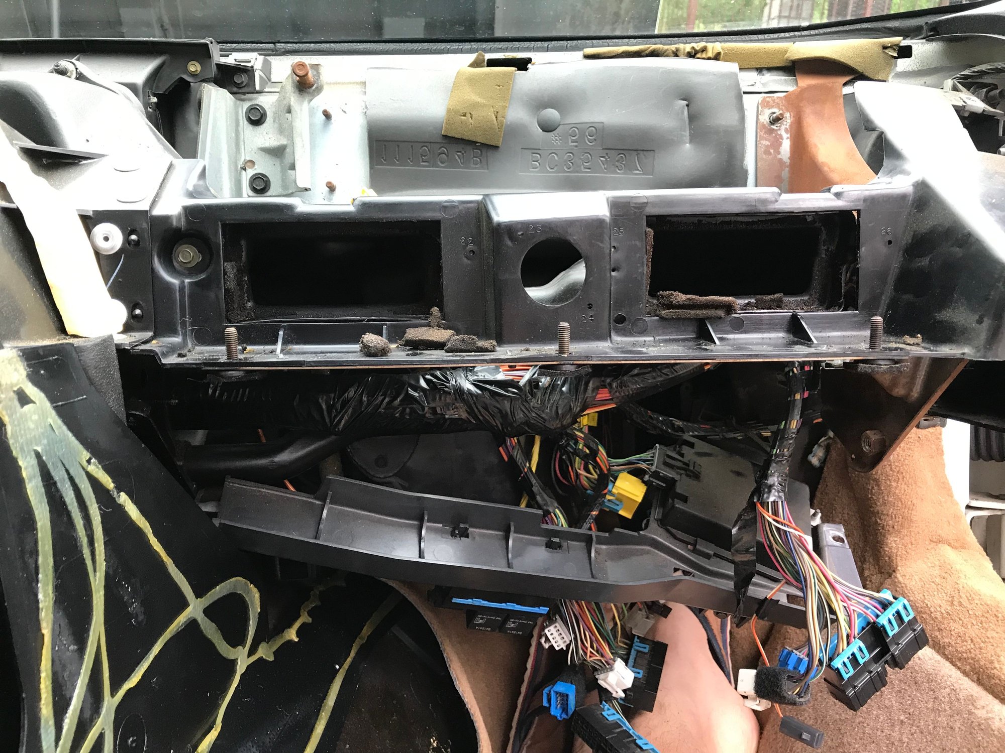

Originally Posted by juni78
Don't pass up this opportunity to replace the rotted foam around the vents and the rotted anti-noise foam tape on the A/C duct work. I did all this in my vette, along with plastic welding all the broken dash pad mounting tabs, and I couldn't be happier with the results. My car is buzz, squeak, and rattle free.
One you are here with the upper pad removed, the passenger vents are showing, where is the heater core in relation to this last picture...do you remove those vents...
