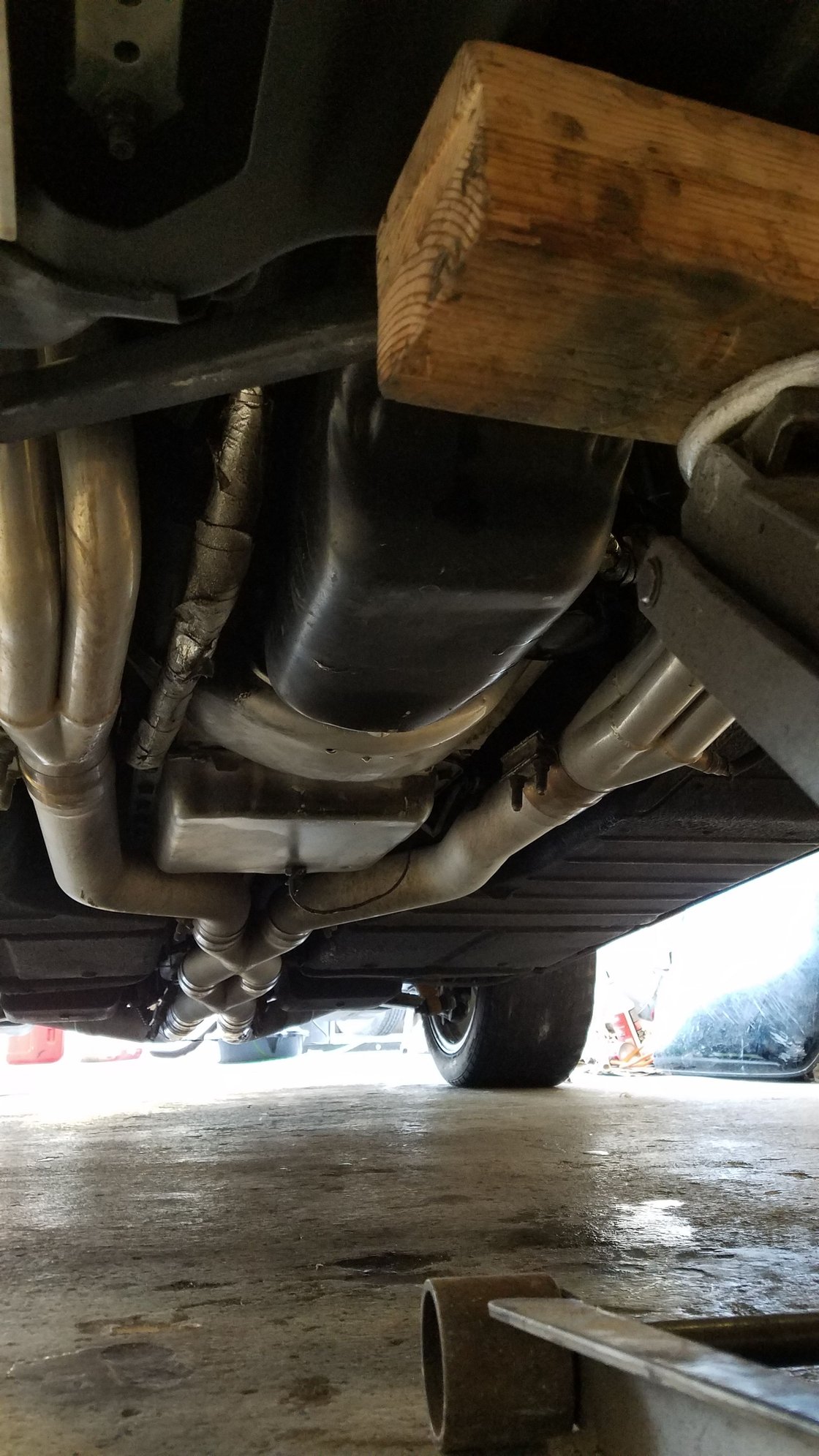

Finally got around to fixing something on my car that's been bugging me for a long time. I installed Hooker headers 10 years ago and when I did I just connected to the old exhaust pipes. The old pipes where crap as you can see.

Here is mine, i had serious drone.
The dual x-pipes are rare but it really helped me out, and the car screams like a v12 Ferrari

LOL... I feel you pain for sure ! You can see the funky stuff I had to do on that side to get the old system connected. I got the header connectors from Melrose. Their standard pipes for their own headers. They are almost a perfect fit. I trimmed 4.5" off of one side and adjusted for the slight differences in angles at the flanges with Kooks weld on flanges.
I do not think they offer stainless pipes but I am not real sure.
The mufflers are 50 series Flowmasters and sound awesome.
