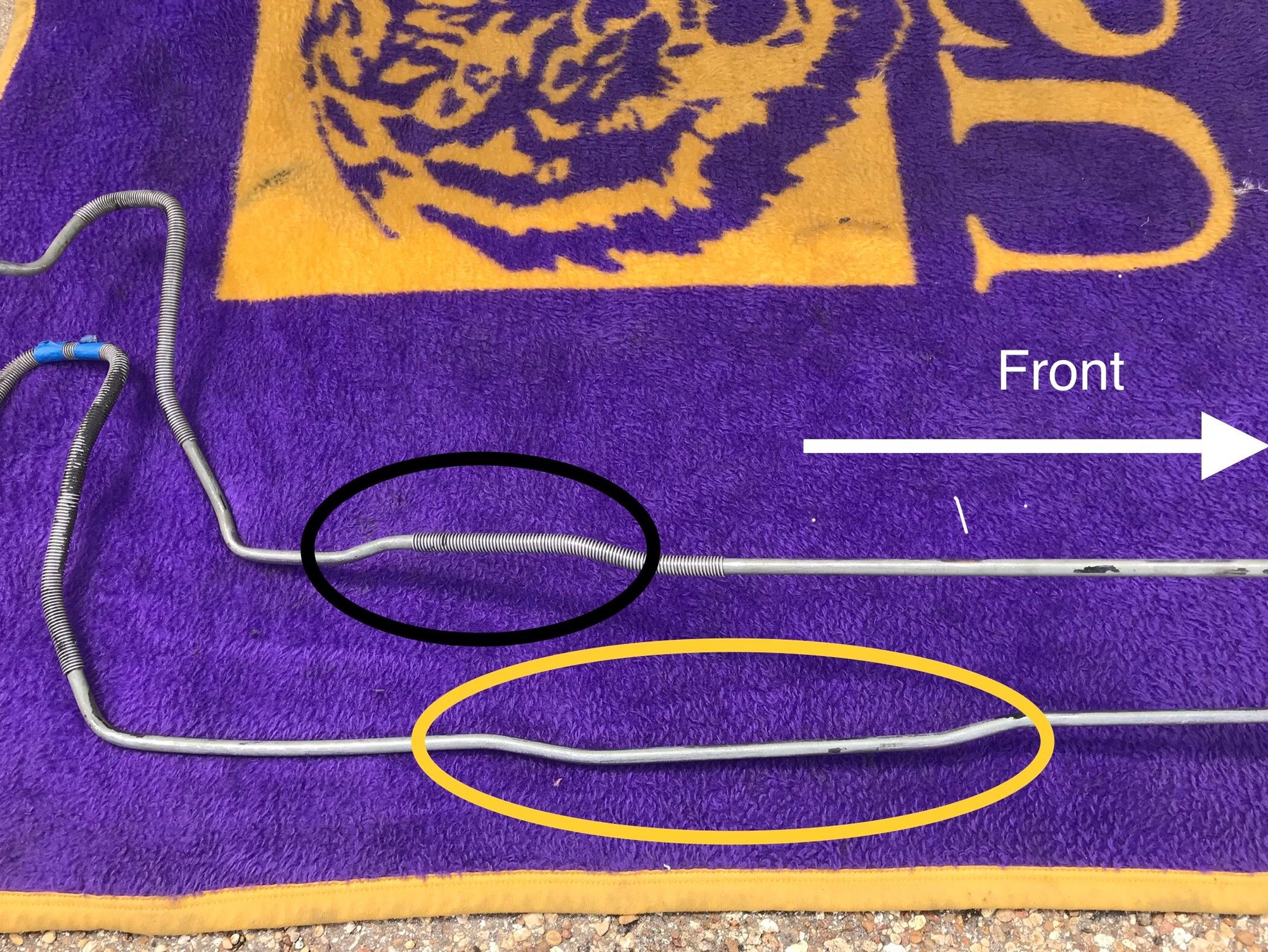

Fellow Vetters:
On s ‘91 C4, which of the two fuel lines shown in the photo is the supply line. I’m replacing them with stainless, but there aren’t any part numbers on the new pieces to indicate is which is which. They’re identical to each other except for the “kick-outs” encircled.
As usual, thanks in advance for your help.

I'm quite sure ----The 'FEED' line will have an M16 Saginaw Male flare that threads into the filter. The 'RETURN' line at that same location I'm quite sure should have a 'female' fitting for the return from the engine.

Does someone make these in stainless for our cars?
same diameter or bigger ?
Yes, Classic Tube on the east coast, but be aware that both lines are comprised of a front and rear piece, so to get an entire feed and return line you need to buy the front and rear sets of both lines (their on-line catalog doesn't say this). Each set is 3/8" OD. FYI, they come doubled-over in the box, which means you'll have to straighten them by hand or with a tool to install. Like Edison and his light bulb, I discovered a lot of ways not to do this job correctly! The stainless sets are beautiful but costly (the lines in the photo are the originals, not the stainless ones). Classic also makes both sets out of steel, which is a less costly option. Hope this helps you.
