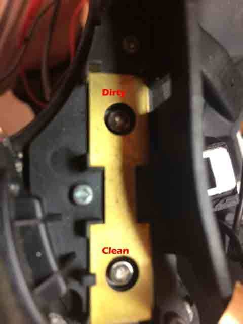

Possible causes,
theft fuse is bad (in aux fuse box #1)
Horn relay is bad
Relay should have 12v on pins 1 and 5 at all times, receives ground through horn switches on pin 2. jumping pin 2 to ground should cause horn to blow.
Contacts are corroded in steering wheel ( remove air bag and you can clean them up (this was what caused mine not to work)
