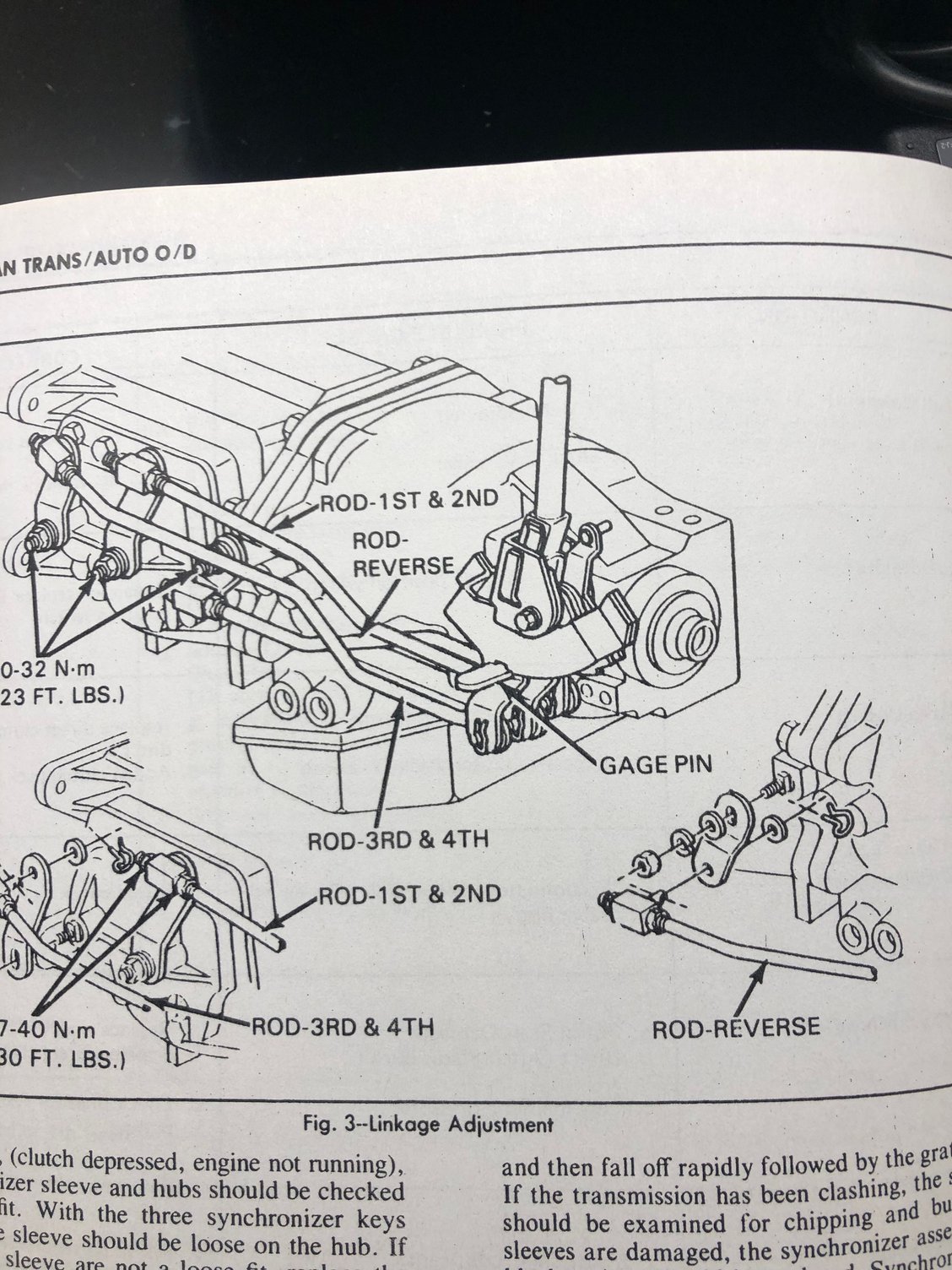

There is a neutral aligning tool that you can make with a flat piece of steel. The dimensions of the tool and the procedure for alignment is described in the FSM.

I can’t remember about the cotter pins sorry. I just had a look in my FSM (always close at hand haha) for the info on linkage adjustment. I was shouted there were dimensions to make a gauge pin but I couldn’t find it. Maybe it’s in the words without a diagram or maybe I saw it some where else. I have attached the adjustment info from the FSM above

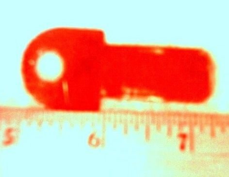

Not the best, but i saved these images (source unknown) over 17 years ago.

What’s that 5/8” by 1 1/8”

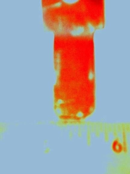

Also found these, wow these are terrible.

1 5/16”?????
