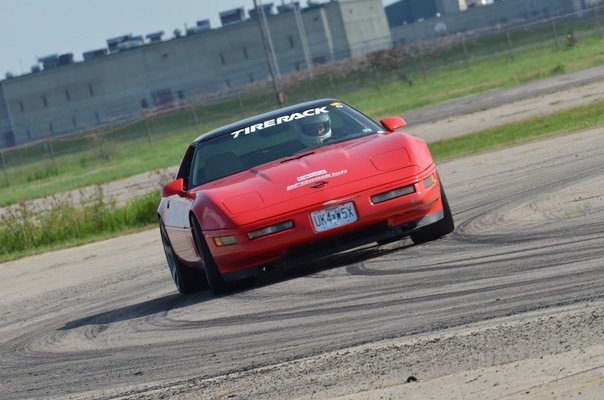

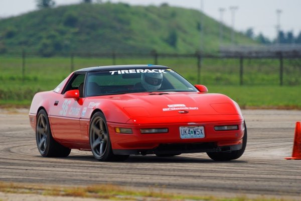

PS - Here's a better look at my 18x11 and 315/30/18 setup:
And countersteering some oversteer:
