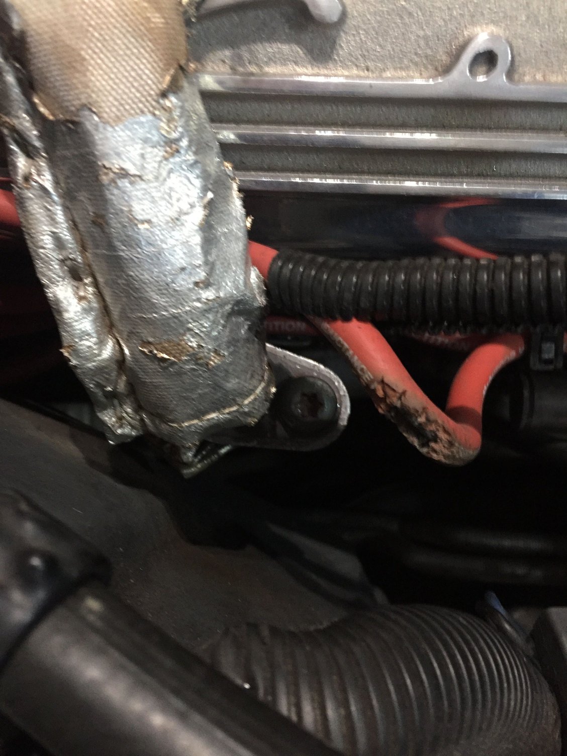

I put a timing light on each ignition wire and had 1 wire intermittently not flashing.. found #2 went loose from the clip and was burned from the EGR tube. Replaced wire with the grey Packard repops and all good on trip to Carlisle!
