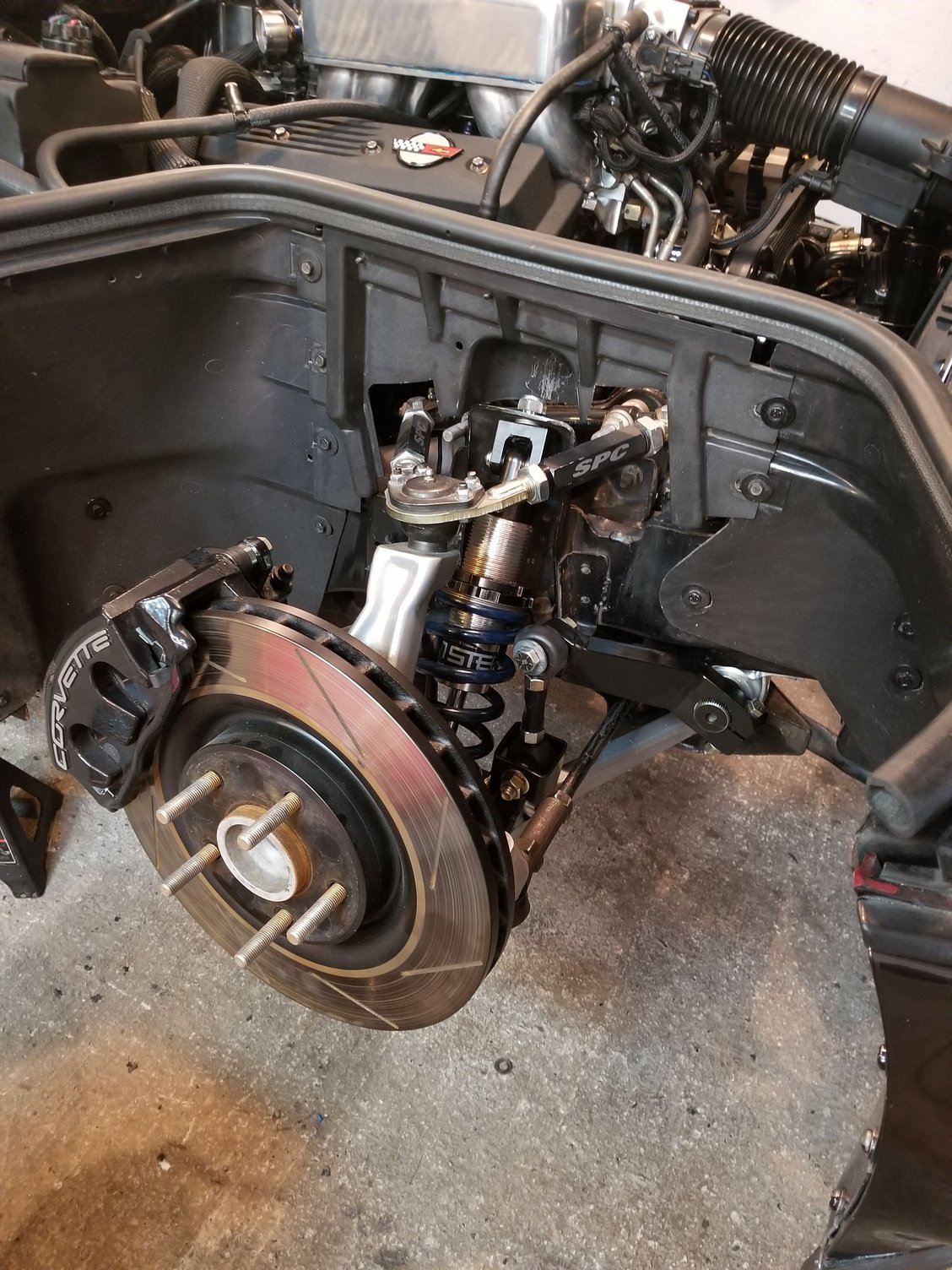

For the same price as C5 brakes you can also run C6 Z51 brakes (13.4in) vs 12.7in for C5/base C6 brakes. Here's mine:
Regardless whether you get the 12.7 or 13.4 in rotor I would suggest you get the C6 caliper they are suppose to be 25% stiffer and cost about the same. The 13.4in Z51 setup uses a different caliper bracket and 13.4in rotor vs the base 12.7in rotor. Stock brake lines will work.
You will also need some adapter brackets, I used the cheapest Ebay ones I could find ($90) and the apporiate length bolts for the caliper and adapter bracket (fastnel is a good source for cheap bolts).
I think the 13.4 C6 Z51 bakes require 18in wheels the C5/base C6 brakes should fit fine under 17in wheels.
One other thing to consider is since you are improving the front brakes but proabbly leaving the rear ones, you need to add more rear brake bias to keep the braking balance...DRM makes a brake bias spring with more rear brake bias for C4 corvettes. less than 30min job to install in your master cylinder. On my setup with C6 Z51 front brakes and stock C4 Z51 rear brakes the DRM bias spring makes the front/rear brake balance very good.
If you want more info you can look up my DMITTZ corvette build vol.2. I detailed the conversion somewhere in that thread.
-DMITTZ

Even with the later C4 brakes C6 brakes are a noticable upgrade.
I went from 13in C4 Z51 brakes to 13.4in C6 Z51 brakes, same type of pads in both system (my C4 brakes were in decent shape too) and it was very noticable that the C6 Z51 brakes are better.
For the money the C6 base or Z51 is a good upgrade. If you have more to spend I hear C7 brakes pretty much bolt up... or thier is C6 Z06 and wilood brakes if you want to get really serious about brakes

Also don't forget that if you go more than C6 brakes on the front of your C4 you will proabbly have to also do the rear brakes as well to keep a reasonable brake bias. The other issue is when you go to a really big caliper like the C6 Z06 the realatively small master cylinder in our cars will mean you have a longer brake pedal throw to full active the brakes. I hear you can install a 2002 camaro Master (it has a larger bore) if you change the brake fittings or I guess do something full custom with the master. But again how much time and money do you want to spend? For some doing all that is worthwhile but for most C4 owners it would be overkill.
I can tell you my C6 Z51 brakes are plenty adequet for any street or autocross driving you'll do and my car is nowhere near stock. I can easily active the ABS if I hit the brakes so the tire grip is the limiting factor, and I have 315 Rival S tires all around (so lots of tire grip). I figure if I ever need more brakes ducting is the next step.
Now from a looks point of view its hard to beat the look of C6 Z06 brakes if that's what your after...

I'd say a C6 front brake upgrade and DRM bias spring can be done in an afternoon if you are mechanically inclined and have all the parts ahead of time.
The C6 Z06 brakes will take a bit longer as at least for the 88-96 C4's you have to also get a rear e-brake kit from street shop inc. (may now be discontinued) and install all that stuff, then get the bigger bore F-body master to really do it properly as well as some longer brake hose. At that point you could also consider getting a C5 Wilwood brake kit with carbon ceramic rotors or putting C6 ZR1 brakes too if you want to get really high-end with the brakes. Lots of options depending on budget and priorities.
