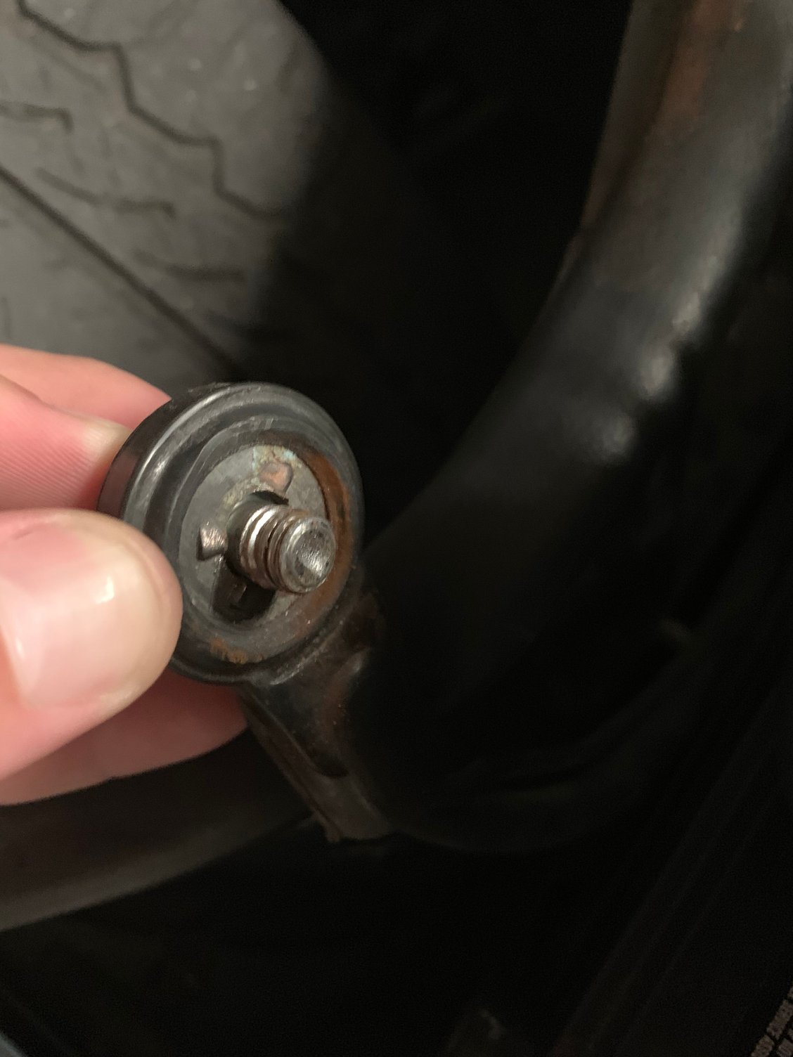

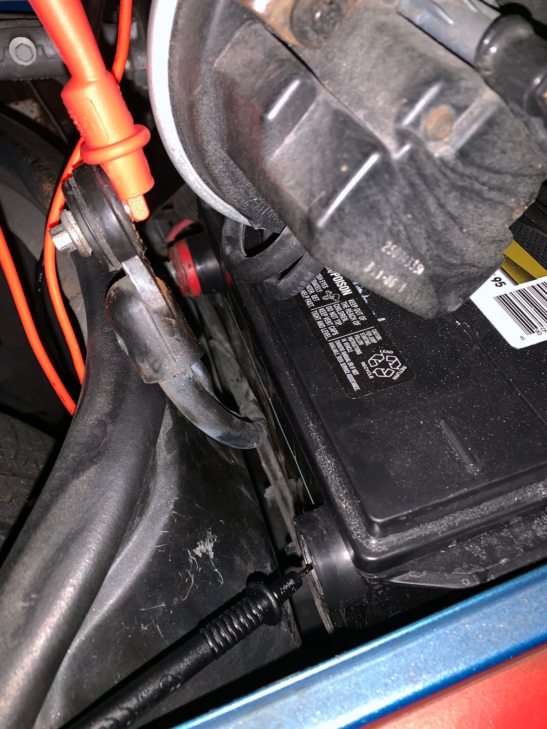

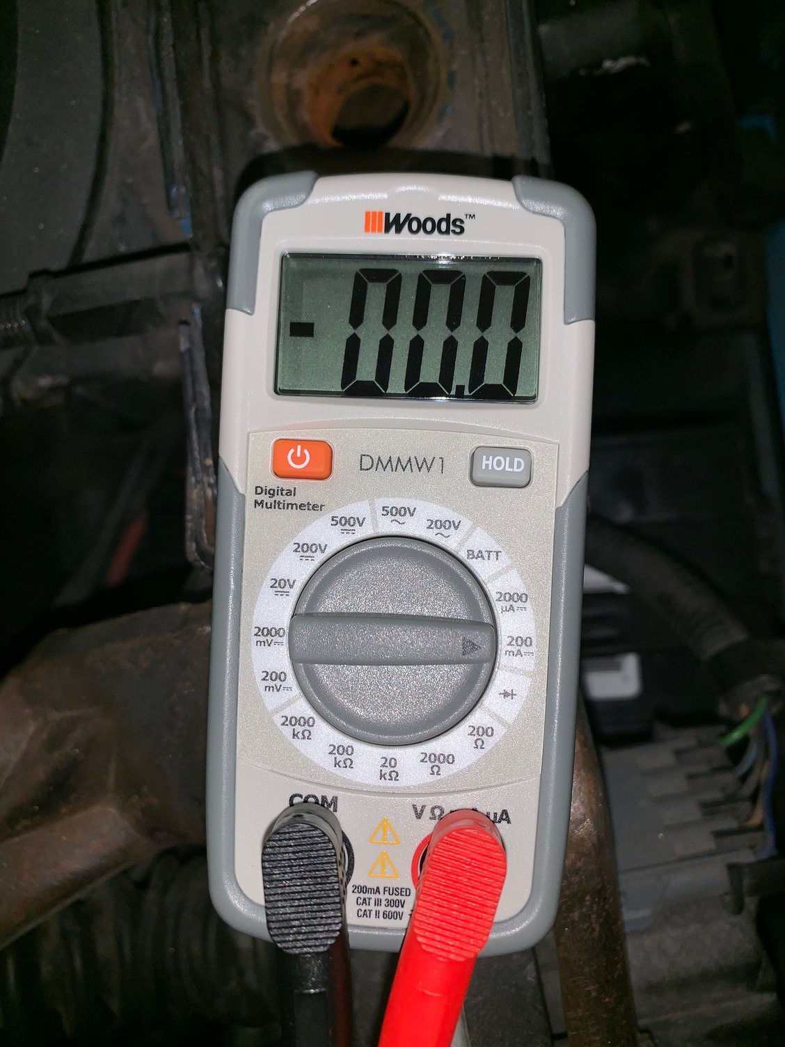

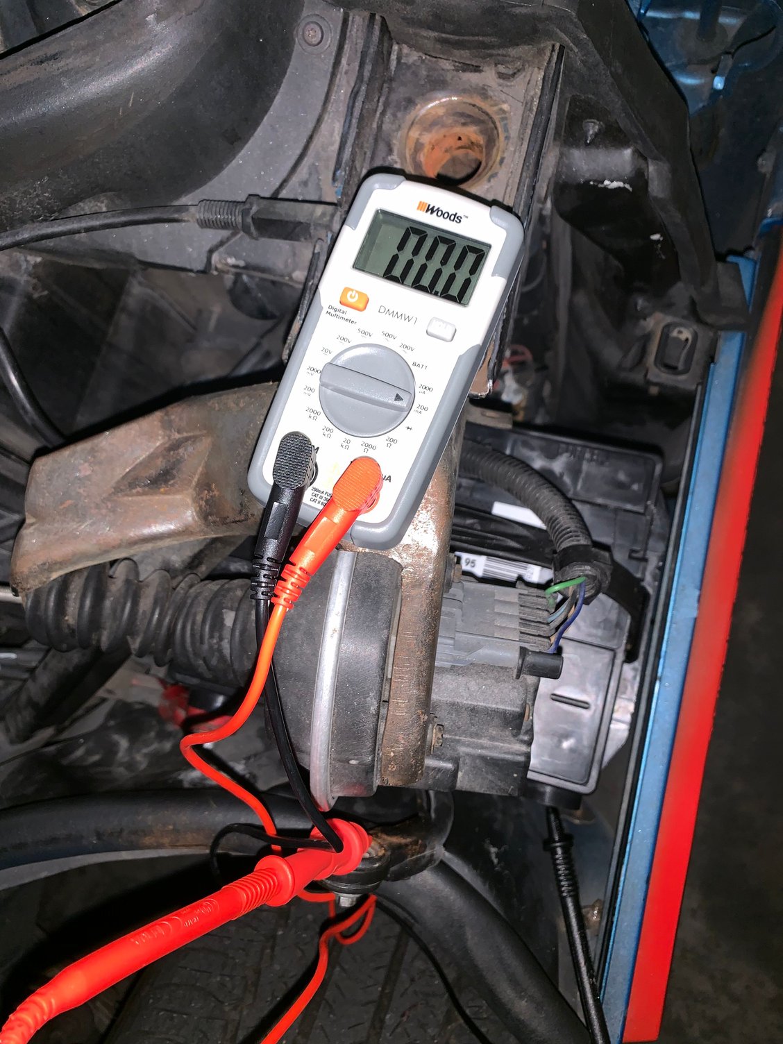

Alright hot rod as requested, here’s how I’m doing it, I also noticed for the first time today that my negative terminal screw has a little rust around the edges and some of threading. I included a close up for the multimeter as well, you’ll see it’s -00.0 the - flashes from time to time but always 00.0
The black lead when I was doing it in hopes of getting a reading to start pulling fuses, was set up just like this but with a small wood shim to hold it in place

It appears that you have your meter hooked up correctly! The Meter I have has two fuses in it, the only way to test them is to move the leads and turn on specific settings. I can test them without opening the meter or damaging anything. The voltage measuring capability is still there even with a blown current measuring fuse/s. You need to read up on your meter to be sure that you are not dealing with blown fuses.

I think that might be measuring AC current... almost looks like rms in the range indication switch , but too fuzzy to tell.
