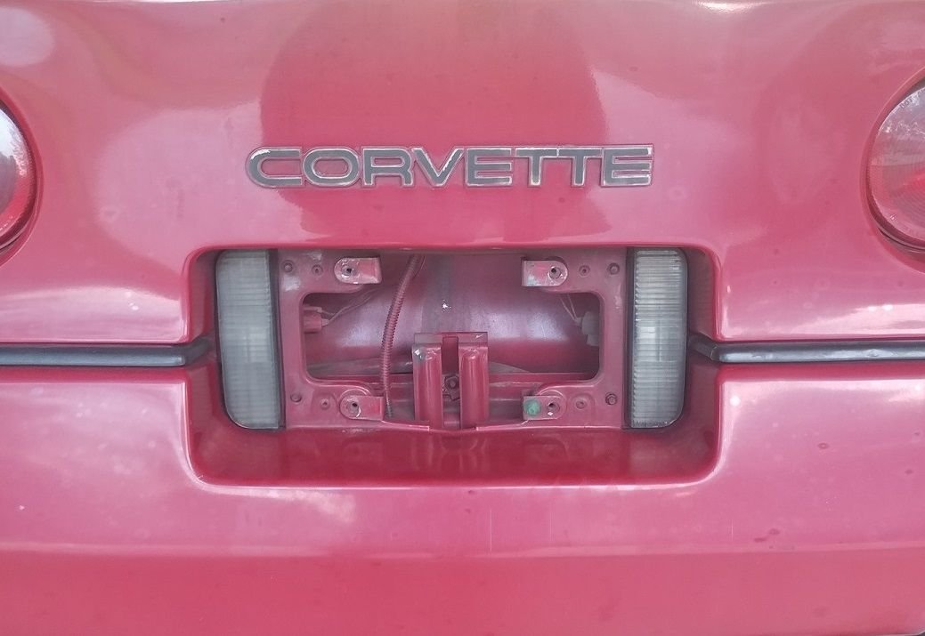

My battery has been relocated to the cubby behind the driver's seat. In order to pass tech at my local tracks, I need to install the NHRA required exterior master disconnect switch.
What I want to do is install the master switch in the recessed area behind the license plate. I will fab up a plate/mount and clearly label ON/OFF as required. This way I wouldn't have to drill any holes in the bumper cover or license plate. I will simply remove my plate when I am at the track.
My question is... Will it pass tech and satisfy the NHRA rule book?? I have seen people put them through the plate or in the sheet metal behind the plate but it is obviously a little different on C4s.
Thanks in advance!

I'm not sure if the recessed switch idea would be a go with the NHRA. It has to be easily accessible. This was my answer to punching a whole in the bumper. My license plate didn't care.

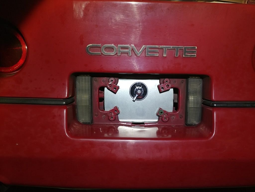

383vett,
Alright. I mocked it up tonight and this is what I have. Basically it's in the same exact location as yours except it is recessed about 3/4" compared to yours. My license plate will fit right back over it with 1/16" spacers and conceal it when I am not at the track.
So... Now do you think it will pass???
Thanks!!!!!!!!!!!!!!!!!

Should be ok. Just go by tech at a NHRA sanctioned race and see what they say.
