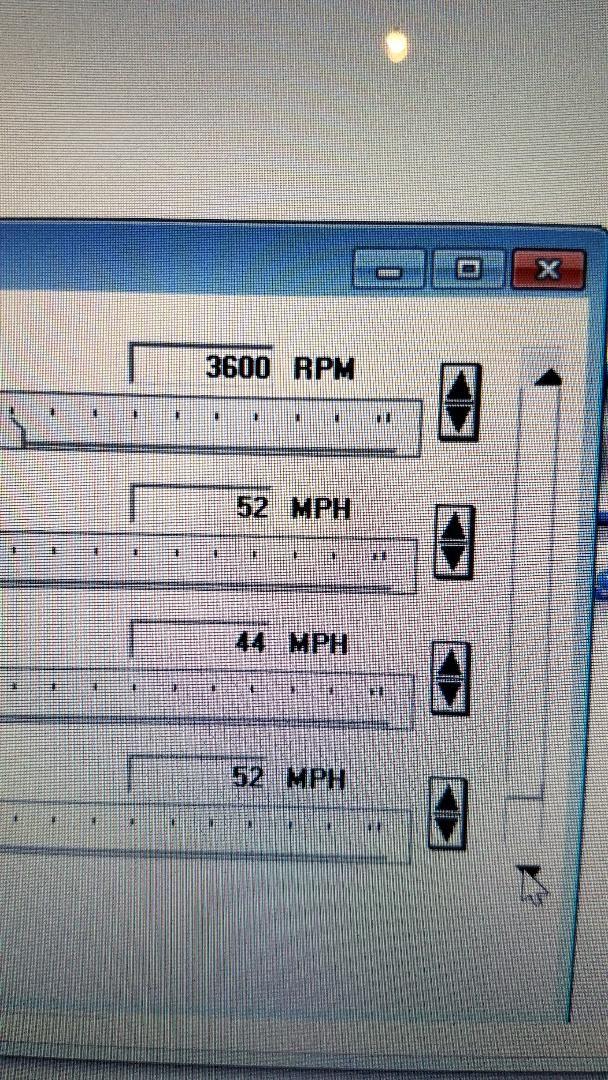

I have a 93 with a 396LT1, 2800 rpm Vigilante converter, PRO BUILT 700R/4L60 and 3.73 gears D44.
What speeds would you recommend the ECM to lock and unlock in low and high gears.
I knwo there is another table dealing with percentages etc of throttle, but in the ECM table, I can choose speeds in Tuner Cat.
I am getting a little shudder at 46 to 48 mph in 4th at very light throttle, cru
ising basically.
