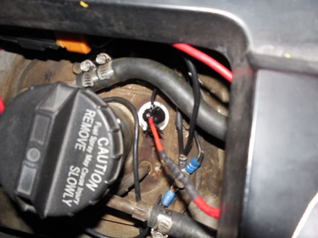

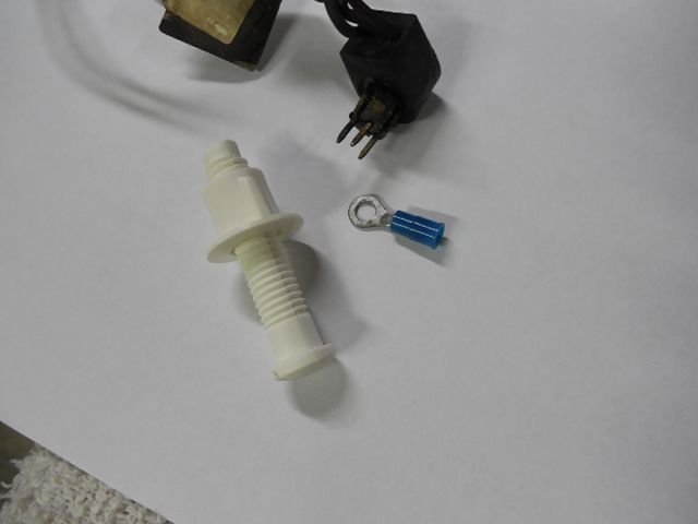

….. I have an Aeromotive 340 in tank pushing E85 to MPFI rails with an Aeromotive FPR on the return end … I ran 10gauge wire from the relay back and 12 gauge into the tank through a nylon toilet seat screw that eliminated the factory pass through connector on the fuel tank plate … so far , so good ! .....
