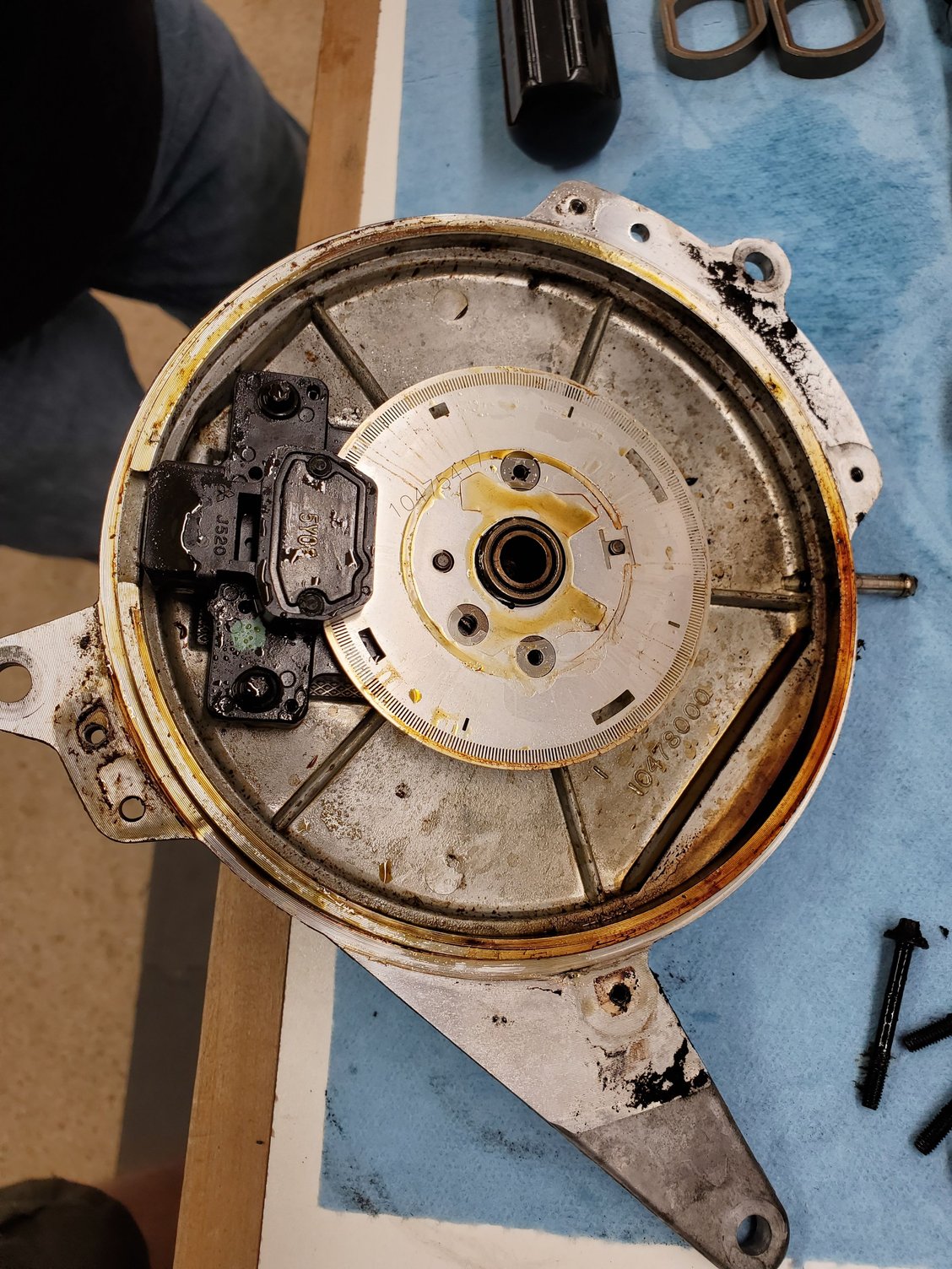

Ok im finishing up my LT-4 long block and I have an MSD cap and rotor kit. The 2 shaft o-rings disintegrated but it looks like the kit includes them, thank goodness.
The problem is the optical rotor and housing is hosed in oil. What can I use to safely clean it? Ive searched the Google's but can't get any answers? WTF?
Here is what it looks like:

If it were me I would use electronic contact cleaner/degreaser or Mass Airflow Sensor safe cleaner. There are several brands out there. The only problem could be damaging the bearing because the degreaser could remove whatever lubricant is still in the bearing.

Yeah that's kinda what I was thinking as I already have a can of that ridiculously expensive MAF cleaner stuff.
I was just worried about melting the plastic sensor.
Is there an easy way to test these things before putting it back in the car? It's much easier to swap with the engine on the stand. Lol

I went through this when my water pump blew. I opened the opti, cleaned it with electronic contact cleaner/degreaser. Replaced the cap, rotor, seals, with new ones from GM and put it back in the car. The car ran but I was having misfires uneven idle that lasted two years. This year I finally pulled it and replaced it with a Chris Petris opti (it had an original Mitsubishi optical sensor). I set my misfiring original on a bench with an oscilloscope and cordless drill to look at the pulses on both tracks of the wheel. The waveform was not very stable! It had a bad bearing and the pickup wheel was bent slightly which was hitting the sensor.

Did you just hose down the thing with brake cleaner or did you physically rub the parts?

I sprayed everything with electronic contact cleaner/degreaser. Not Brake Cleaner! You have to use something that is not going to be harsh on plastic parts (optical sensor). I used compressed air to dry it out.
The bearing is special, try pressing it out and giving it a look. It has a upper and lower body so the diameter has two dimensions. I am sure you could machine the opti aluminum body and get a bearing to work but in the end it would be a lot of work. It is easier to buy a new one.

I've cleaned opti's numerous times....and posted about it on these here forums. I'm surprised that my posts didn't show in your search.
Anyway, I blasted the thing out w/brake cleaner, including through the sensor slot. Then drew a folded Kleenex through the slot to dry it/wipe it clean. Worked great every time.

Awesome glad to hear. How much bearing wobble is normal?
My car is low mileage (only 56k) but the shaft is a bit wobbly. I've read where people have said that's normal and I've also read where they say that's the cause of the oil incursion, due to the bearing having a seal that fails?
I was just going to send it to the Ebay guy everyone Is recommending, as he said he would give me a discount for including the MSD stuff. Which would include a new bearing. But if it comes back wobbly as it is now, I'm wasting my money!

The bearing is a sealed ball bearing. The bearing's seal has nothing to do with the oil seal in the front cover, that IS responsible for oil sealing/leakage. While the bearing, when new, wouldn't have any slop, the purpose of a ball bearing is not to provide support in that direction, so a little slop is probably fine/expected of any used bearing. However, if the slop becomes too great, it could allow some shaft movement which could contribute to oil leaking through the front cover seal...especially if the seal were already bad/hard/worn out. SO...the bearing is not responsible for oil sealing or leakage, IMO.
If the bearing spins SMOOTHLY, with no grittiness or roughness at all, I'd probably grease it w/a quality synthetic grease and run it.
