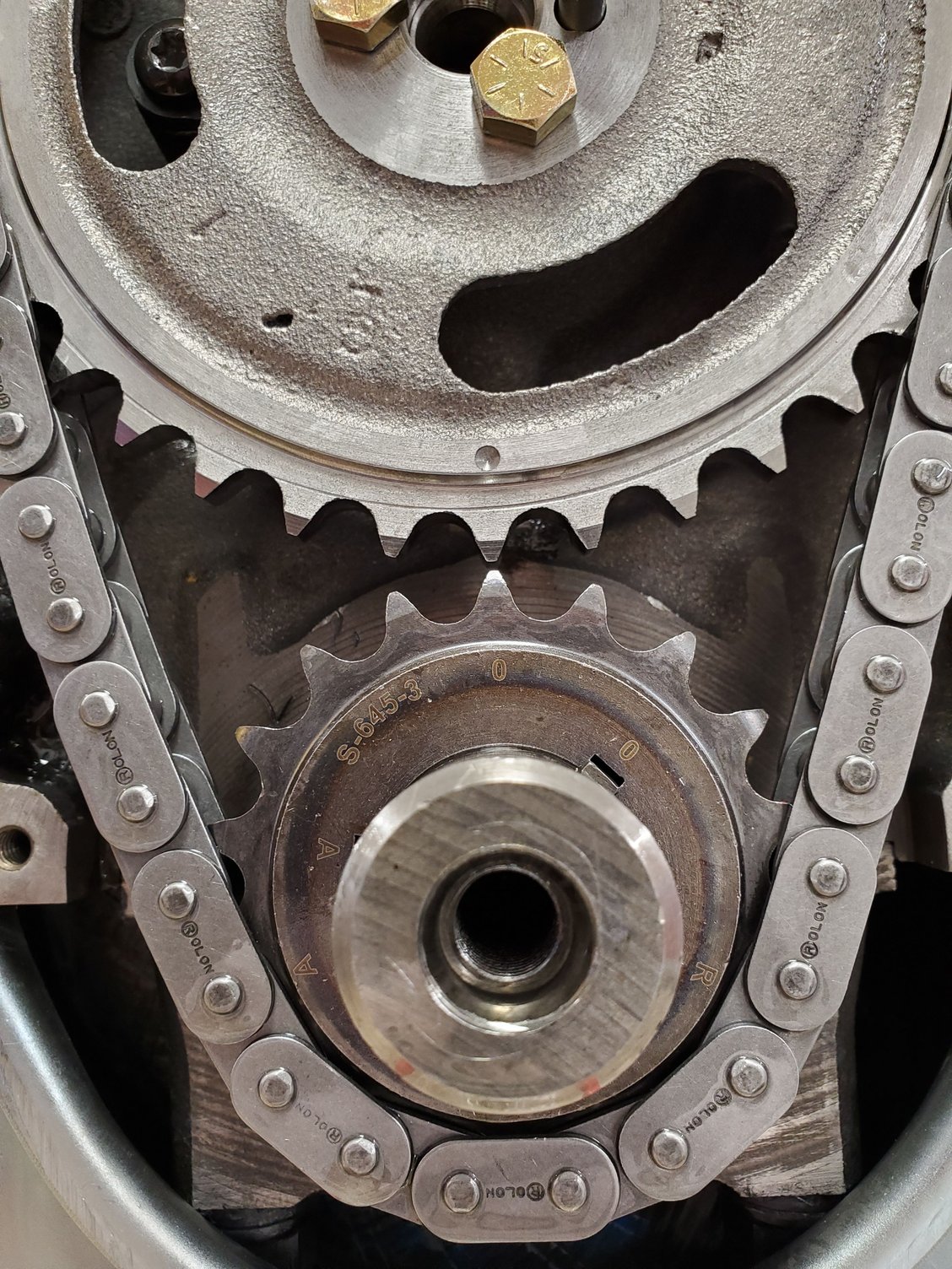

Ok im stumped, how are any of you running a double roller? It leaves no room for the crank reluctor!
I tried the L-98 TPI single roller everyone said would work but only have 0.042 clearance tooth to tooth:
I also have a Cloyes single roller designed for the LT-1 and the tooth clearance is the same!
I'd hate to reuse the OEM set (56k miles) but I'm at a loss, please help! I need to get this motor back in ASAP! I don't even know what other options there are?

I have that one here too but it has the exact same gear tooth to tooth clearance as the TPI single roller.
The stock set is a single roller as well but is a much smaller pitch, the same as a double roller uses. So you gain a TON of tooth to tooth clearance.
If you look at the pic I posted, both the TPI single roller and Cloyes single roller have extremely tight clearance. Since im deleting the mechanical water pump, I was told the TPI set was fine and it's $200 cheaper!

After looking over all 3 Timing sets with the machine shop. We decided the L-98 TPI single roller was the best idea. We couldn't find any issues that would cause fitment problems with the timing cover or opti.
To LT-4 timing set, UH OH!
