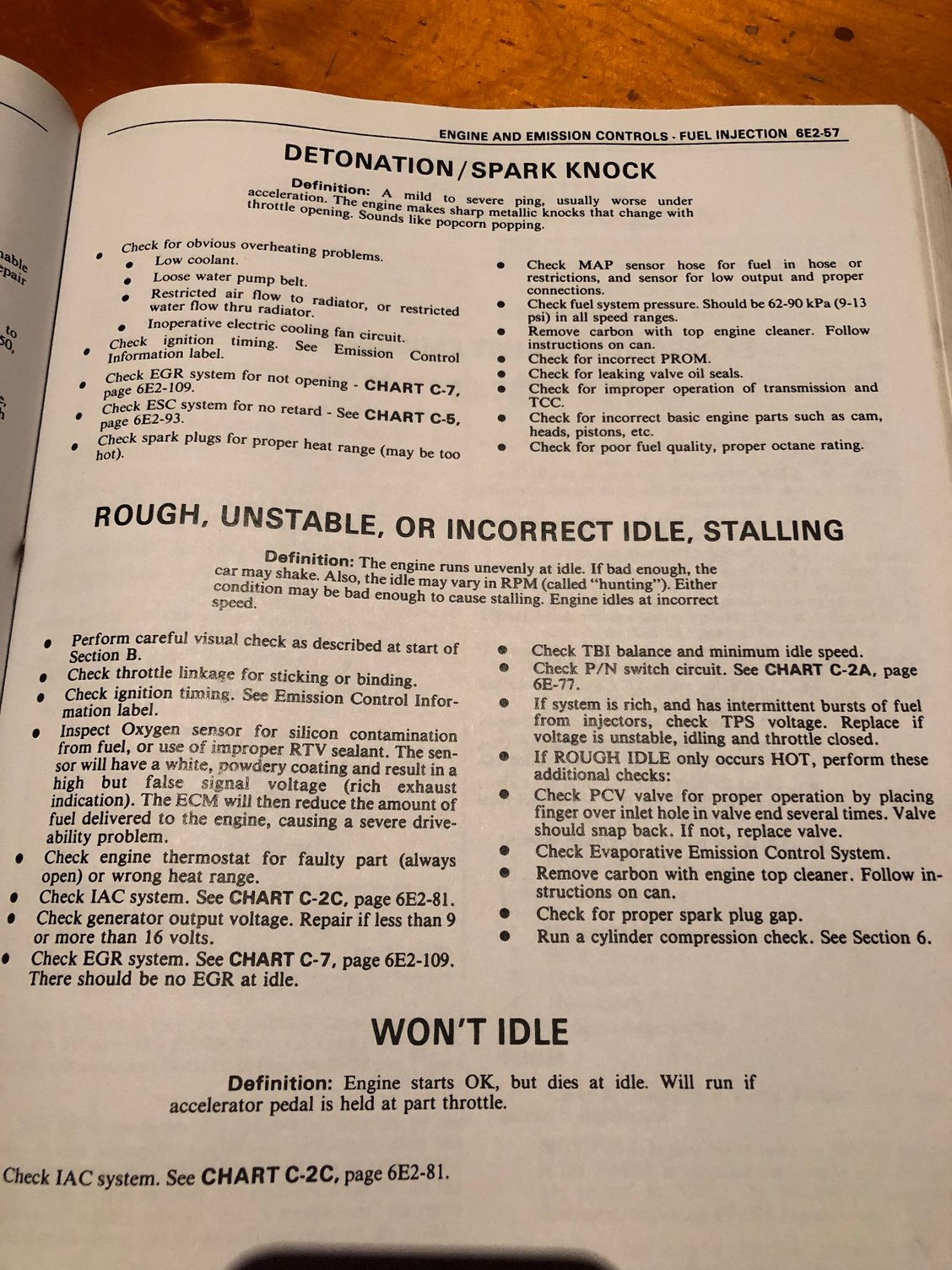

Here is the idle diagnosis info from the FSM. Could be a number of things.
Do you know how to check for engine codes? If so what codes are present.
Before I changed my ECM I used WinALDL to diagnose faults and it was very handy.
