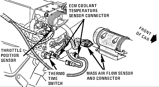

Thanks for the tip. I'm still trying to locate the coolant temperature sensor.

Its on the head, mine is on the passenger side, rear part of the head, between the the number 6 and 8 cylinders. Service manual says its on the drivers side between numbers 1 and 3. I wondered if my heads got switched. Its a gold colored plug that sticks out of the head.

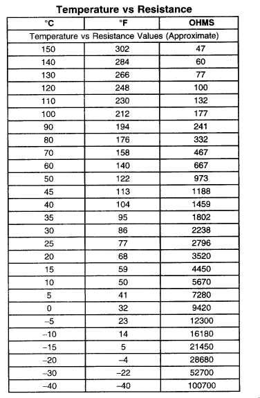

This is the calibration graph. I pulled my sensor at tested the resistance at a few temps:
65F = 3.4KOhms
32F = 8.9KOhms
212F = ~60Ohms

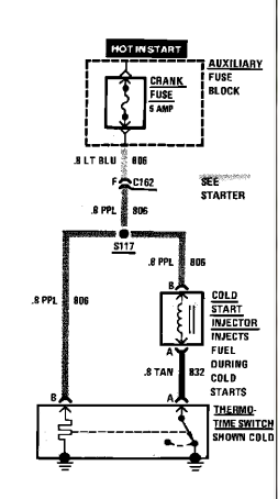

My injector fuses are good. I've been reading the FSM about what's called the "cold start valve". It depends upon a thing called the "Thermo time switch" which is supposed to open the cold start valve when the engine is cold. Is the "cold start valve" another fuel injector that simply is turned full on when the engine is cold? Where is the auxiliary fuse box located?

Yes the CSI is on the fuse labeled CRANK. Pull that fuse and it doesn't work. That is the fuse I was referring to above. Noid lights are all you need to check the others.
Aux fuses on my 88 are behind the center dash, behind where the switch panel is.
