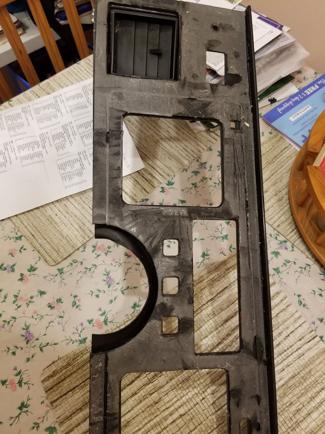

This is the dash I'm working on and the top part of the decals came right off but there is a under coating that I can not get off at all...

You mean the wood grain veneer?

The verneer is off, the underlying piece that's what I can not remove....

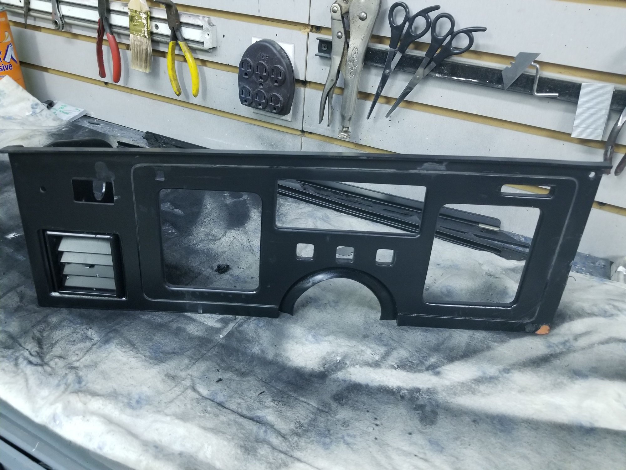

Hi fellas here is an update on the dash....as you can see in the photo what I was working with. Guys said try heating it, sand blasting. I tried oven cleaner, go gone, and scraping it and nothing. I decided last night to just soak it over night is hot water with soap and it worked perfect. A little scrubbing with steel wool it came right off...now it's time to put the new decal on..
