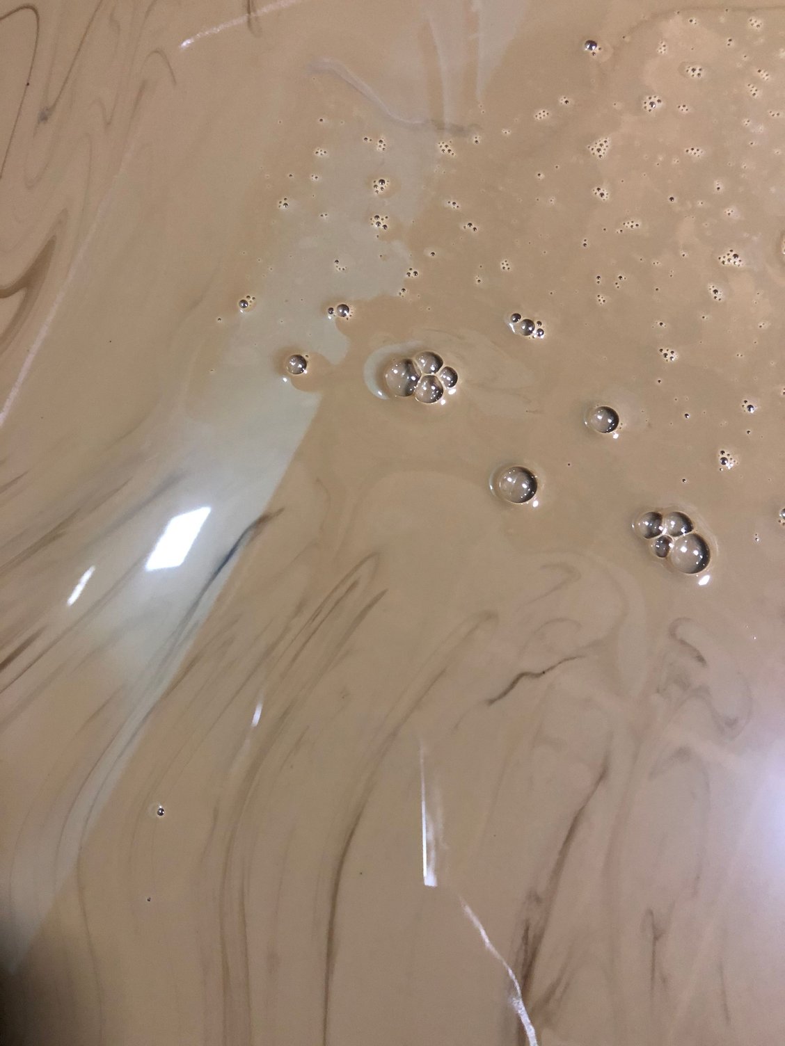

the passenger side is pretty touch to get to. looks like I have to get to them from under the car. So I though “might as well check the oil and do an oil change while I have the car up.”
pulled the dipstick, and that’s only surprise the oil looks not good and exceptionally high.
pretty sure that over the years of attempts to start it, as well as this most recent “dedicated” attemp, it has been dumping fuel into the engine. And the oil is diluted and way too high.
so needless to say, I have drained it and will be replacing it. I probably won’t be working on it much more today.

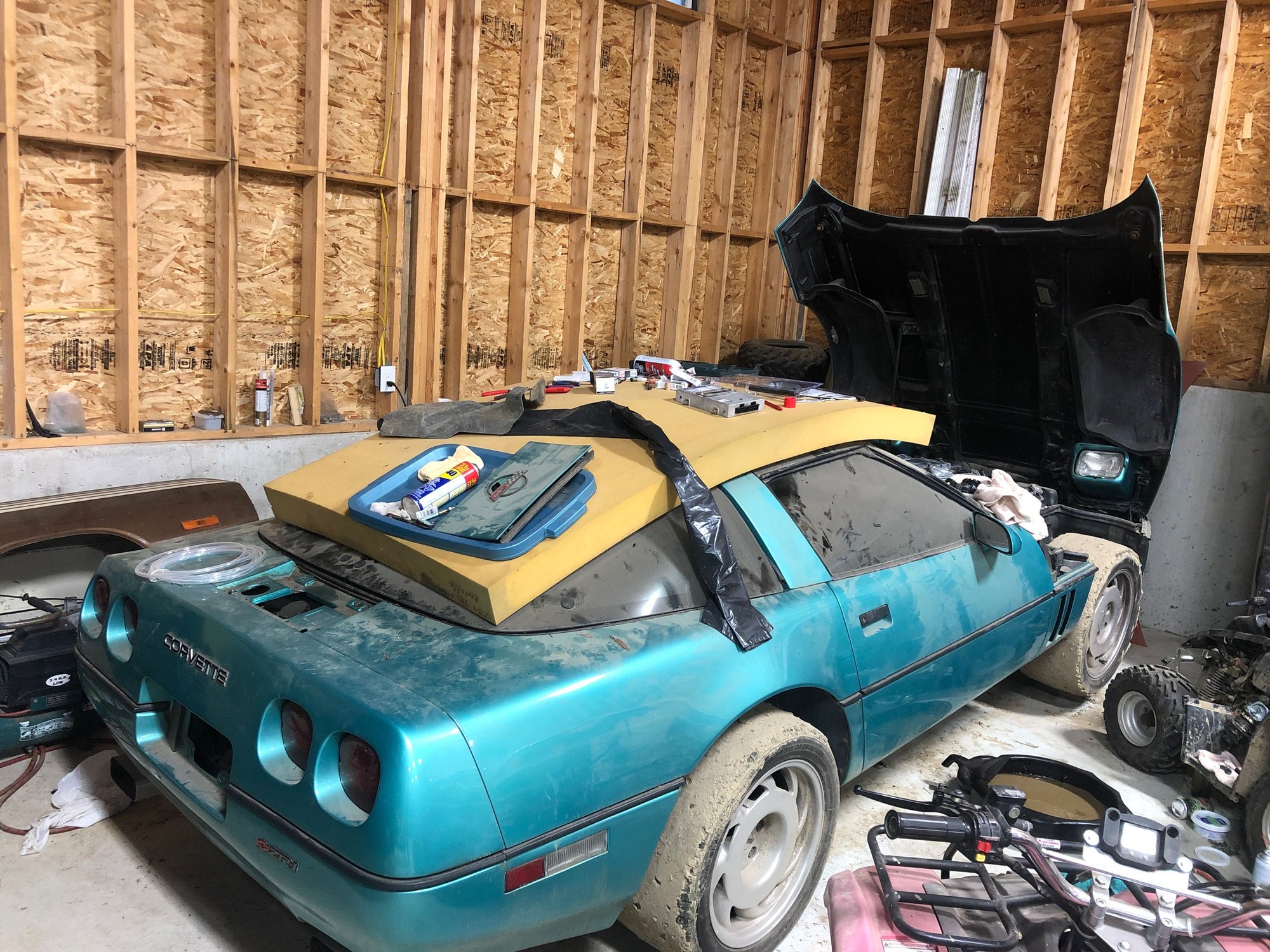

but here is a pic of the oil 🤮
and the car as it sits right now. With an inch of dust and mud caked on the tires from when it got pushed in my shop 2 years ago.

Makes me feel like water in oil?
I hope not, and I don't think so. but everything I have said has been wrong. I have seen water in the oil before. and although it does look similar, it does look different. also, in the past, ( on other cars) if water is in the oil and they have been sitting none running a bunch of water will come out of the oil drain plug at first because the water and oil will seperate. also, the coolant level isn't really too low and this oil smells like gas. so fingers are crossed.
still not really sure why this car would have stopped running, and then the oil flooding like that. guess it could be a head gasket.
I will get new oil and a filter and see. I have a coolant pressure tester, as well as a compression tester, so I will use those tools if I need to. if anything is a good thing, at least I am finding stuff that is wrong with the car now. rather than checking things and having them check out ok.
I have to go pick up a car tomorrow morning and will probably pick up oil and a filter then. but probably wont have time to look at it till next week.
you guys have been great and extremely patient. I wont assume anything anymore about this car from my findings in the past. I will check and re check as requested.

Likes: 2,732
Holy milkshake batman.

Im putting in read because many people are asking. and yeah, the more I think about it, the more I think maybe water. but we will see.

Fresh gas sprayed in and it runs. Injectors pulse. You’ve got fuel pressure. How many years ago did you say the fuel pump was changed ....along with the gas??? Sounds like bad gas!
Now, about the water in your oil..........

I changed the fuel pump maybe 6 months ago. and yes, it sure does look like water....smelled like gas, so I am hopeful.
