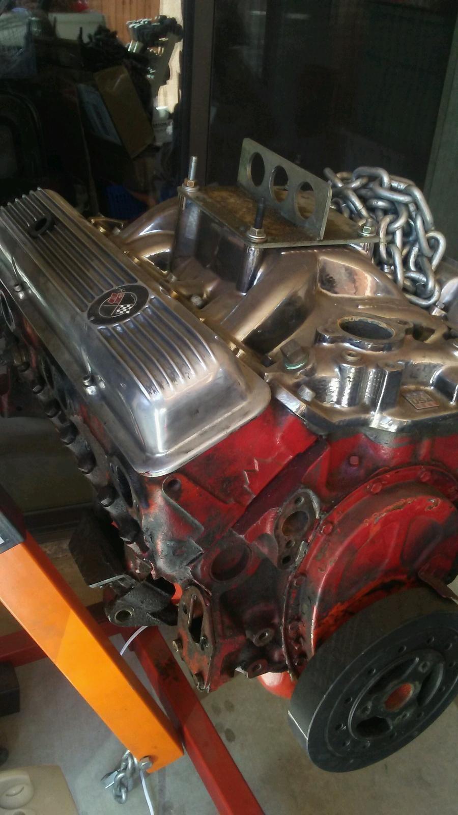

Heads are staying on, I did those years ago, LE ported stock castings. No reason to take them off now. Finally getting a cam in it to take full advantage! It’s nearly ready to come out, the ZF is already on the workbench and all that remains is the bell housing, clutch, flywheel and 2 bolts for the motor mounts.... and the hardest part, finding the time. Also have a HappyHooker, anyone use one? Believe the loop points forward but not certain. Do I need to use longer bolts? And yes, I’m apprehensive about 4 dinky fuel rail bolts with that load, well not so much the bolts but more the aluminum threads. Haven’t heard of any failures though.

I'd be nervous about that too. I typically use a chain and bolt diagonally across the engine to two beefy points. Then position the hook on the chain, so that the engine is balanced.

I wouldnt use the fuel rail threads, use the heads or poss intake.
I have an old 3 legger handles a BB or LT5 fine. Feel strange like you said its plenty safe.

Well the only way the HappyHooker works on the LT1 is through the threads in the intake meant to hold down the fuel rail. I’ve seen lots of pics of it in use and haven’t seen a failure (I know that doesn’t prove it can’t happen). Is it much different than a carb plate? I normally use a load leveler when pulling a motor especially if the trans is coming with it, but the HH just seems easier and the ZF is already out, I can pluck the motor out nice and level. That said, backup chain without slack... you bet!
I will likely find some longer bolts and washers vs using the fuel rail bolts. I’ve been debating with myself whether grade 5 or 8 would be best, but came to the conclusion that a ~700# engine weight spread over 4 bolts won’t be very stressful for the fasteners.

I’ll be doing this is the spring, subscribing for future reference! I’ve read a bunch about the happy hooker and while many are apprehensive I’ve seen no failures.

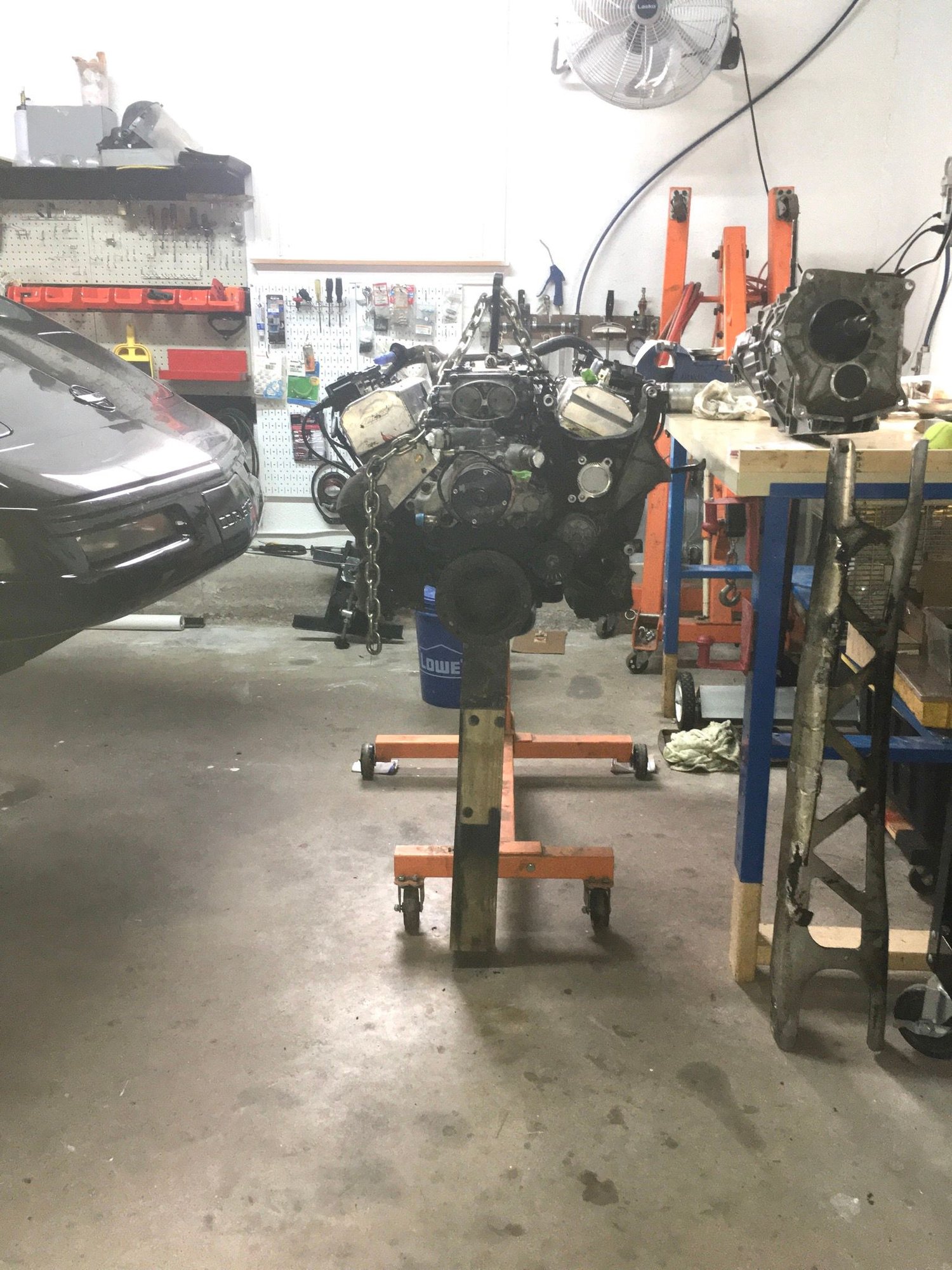

It’s out and on the stand. I needed to drive the ball stud out to get the bellhousing off, I just couldn’t work the fork off the release bearing with the ball stud still threaded in.
I did get longer bolts and used the happy hooker... I used a safety chain as well for backup but that never came into play, at no point did things feel unsafe or risky. I’ll admit I employed my wife’s help, she operated the hydraulic ram on the crane while I ensured everything was coming out free and clear.
I was able to install the adapter for the engine stand really close to the cam centerline and I also really greased the engine stand very well. I was easily able to rotate the engine about 25* either direction.

Nice job on getting it out and onto the stand.
