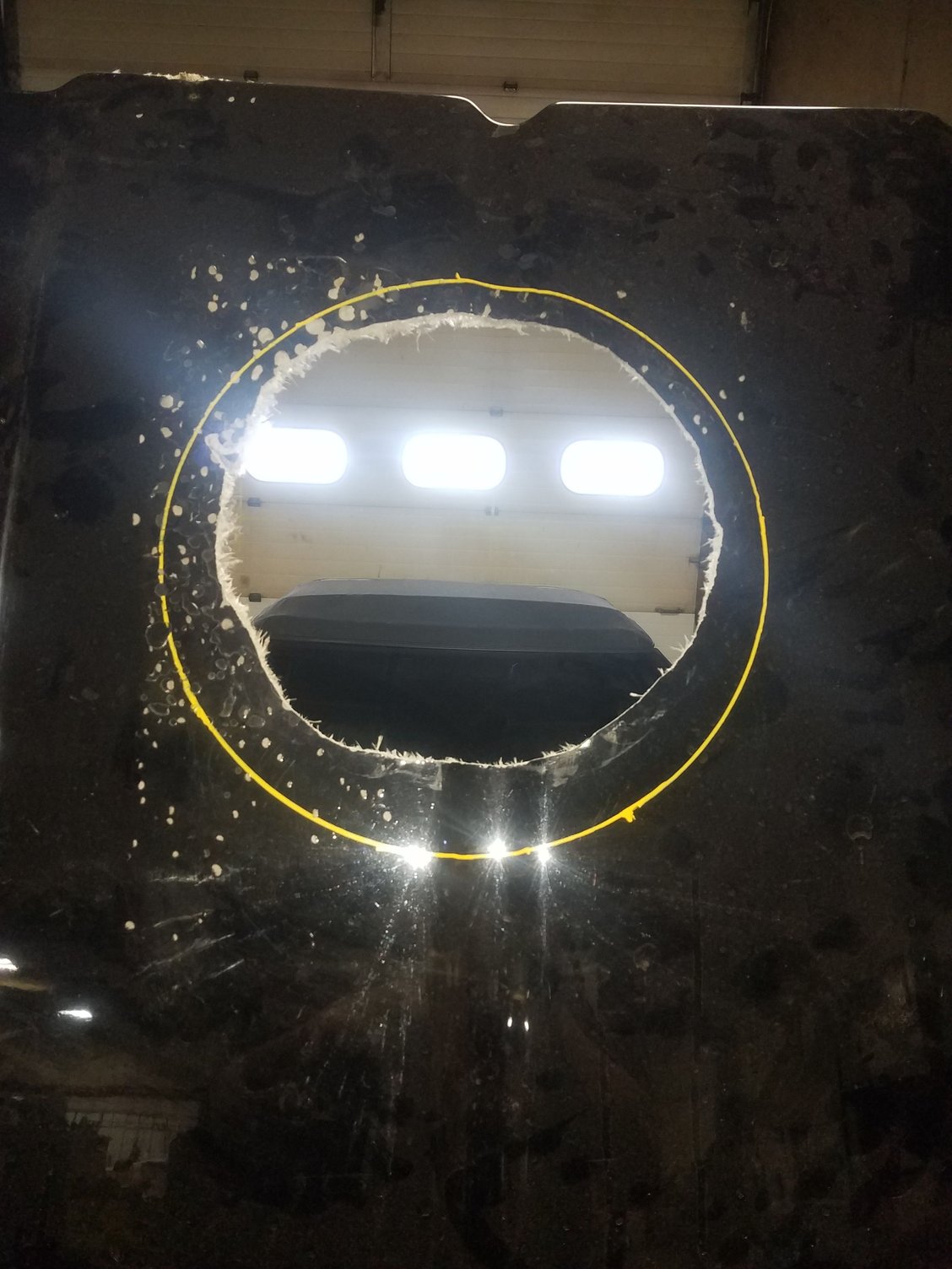

thats the whole he paid his buddy to make rofl. the yellow paint marker ring is what i did for the 14 inch air cleaner. you can see the paint all bubbled up from the fire so the hood was basicly junk before they even cut it. it could of been fixed by a good fiberglass guy i'm sure though
This painful to watch.....sorry.
Old Jan 1, 2020 | 03:55 PM

lol why. its just some old car. thing was 5 minutes from being a ball of fire.. i am making it a hot rod not some sweater wrap golf club cruiser, how a corvette is supposed to be isnt it?

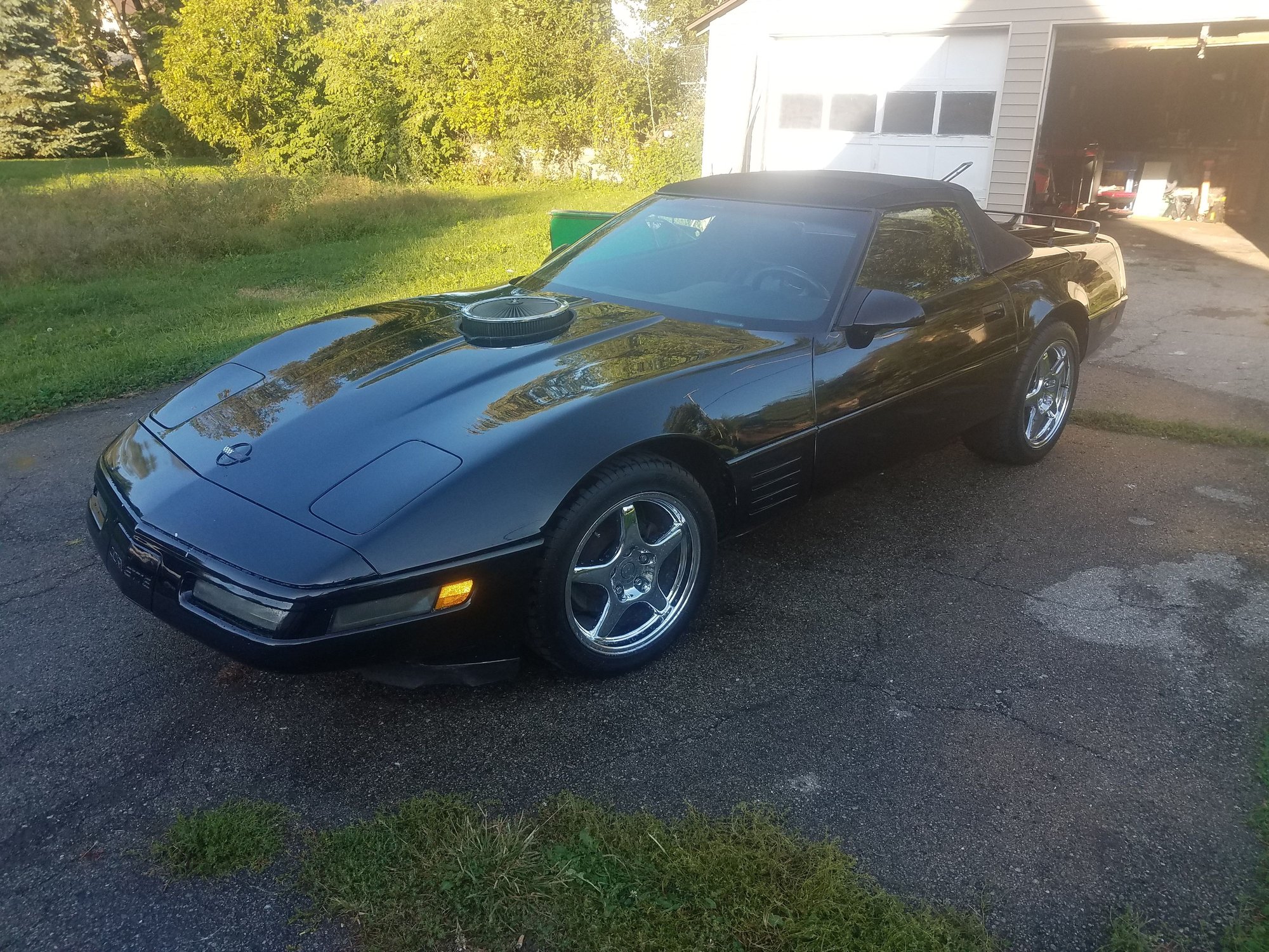

yeah, it's the best option at that point, that fire melted all the fuel injection wires and it isnt horrible but you can for sure see the extent of that damage still. all fixable for what i am doing though. i was suprised it had a clean title as compared to a salvaged title, he must of not turned it on to his insurance company. probably didnt want the rates of his other 10 cars to go up i guess. who knows. the guy was a pretty cool older. 65-70 yr old dude and said he was glad i had the ability to fix it up.
you can see all those white bubbles where the paint melted. everyone here who reads this really should be checking your engines for a fuel leak at the rails. or you could quite possibly be in the same situation i am..
FYI i would hardly say this car is a beater to be honest, it's extremely clean inside and out, underneath every is damn near mint.. minus fire damage under the hood.. the car was his show car.
some day i will see a hood scoop or something to cover that eye soar up that everyone hates here so much, but to be honest when i drive it around, everyone compliments it in person. never owned a car before that every time i drive it, every where i go. people say man nice ride.. or wow that car is beautiful..
