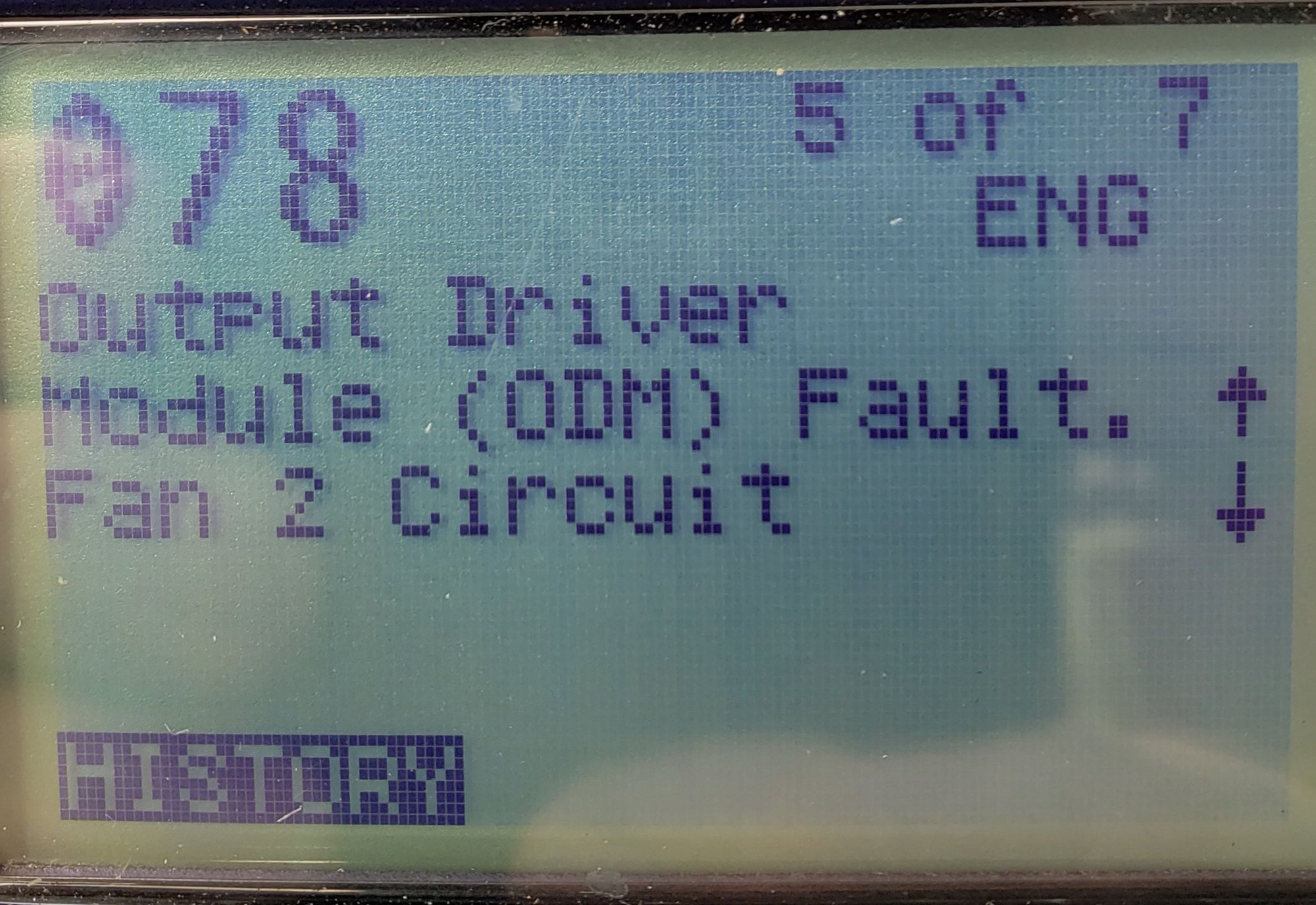

How's it going. Everything about a c4 is probaly old news. Ya'll probaly herd it all by now. I joined this forum cause I need to fix my car. Sent to the paint shop and didn't make it home without having trouble codes. I found a bad EGR valve and a bad pressure regulator lean on left bank got better but still isn't right. Don't even know where to start with 78. I tried to search the forums and couldn't find anything.

These look like a low battery voltage issue, especially since you just got it back from a paint shop that could have drained the battery.
Charge the battery and clear the codes, see if they come back.

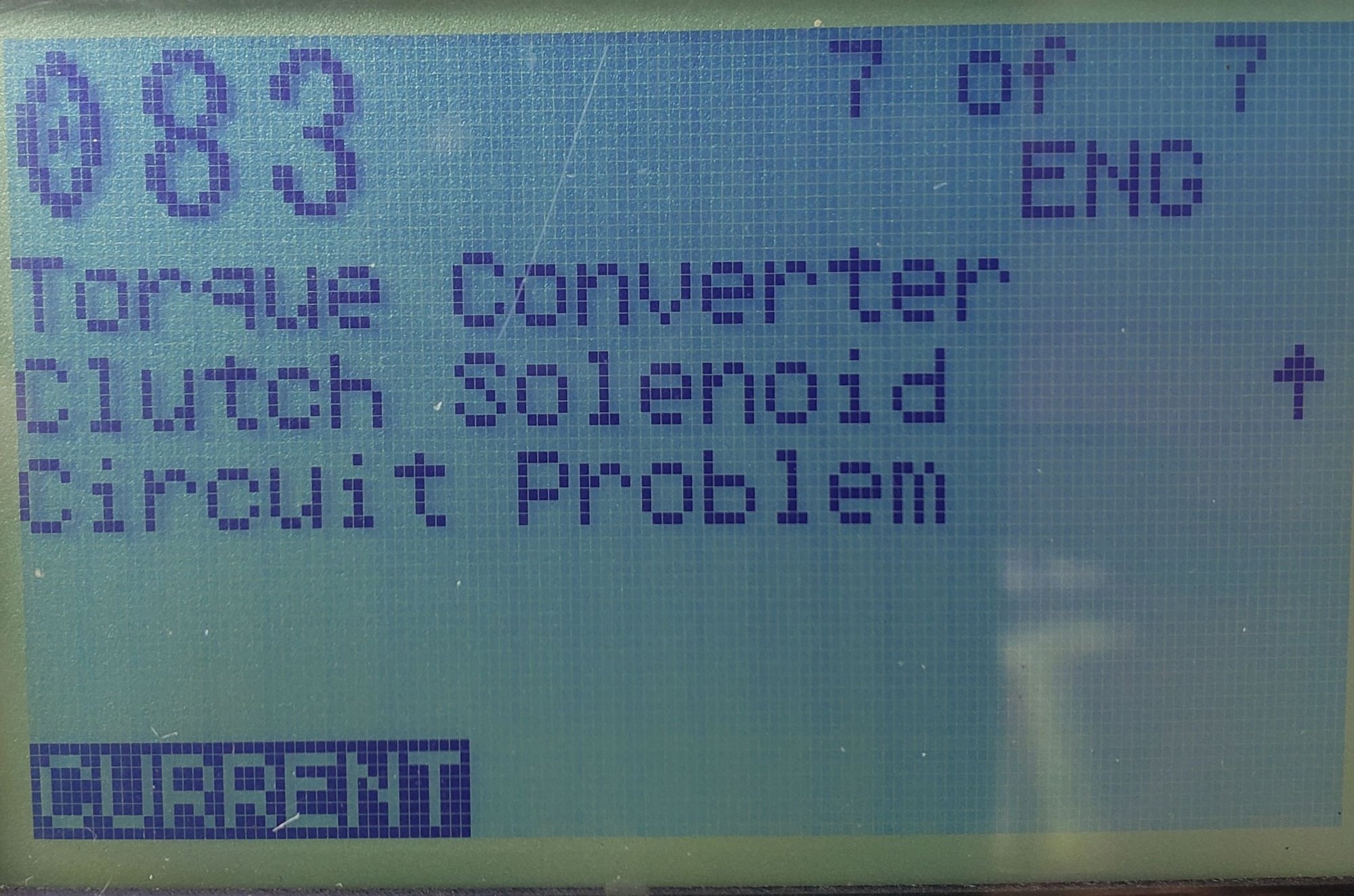

New battery lost number 78. Number 44 lean left bank still coming back and it seams that number 83 wont even clear.

I'd swap out the O2 sensor o the left bank and see if that solves it. Those do go bad with time, but I wouldn't be surprised if upon investigation you found some wiring issue. For the code 83, I'd check the wiring to the transmission, see if there's anything wonky going on down there, ie unplugged, broken, etc.
