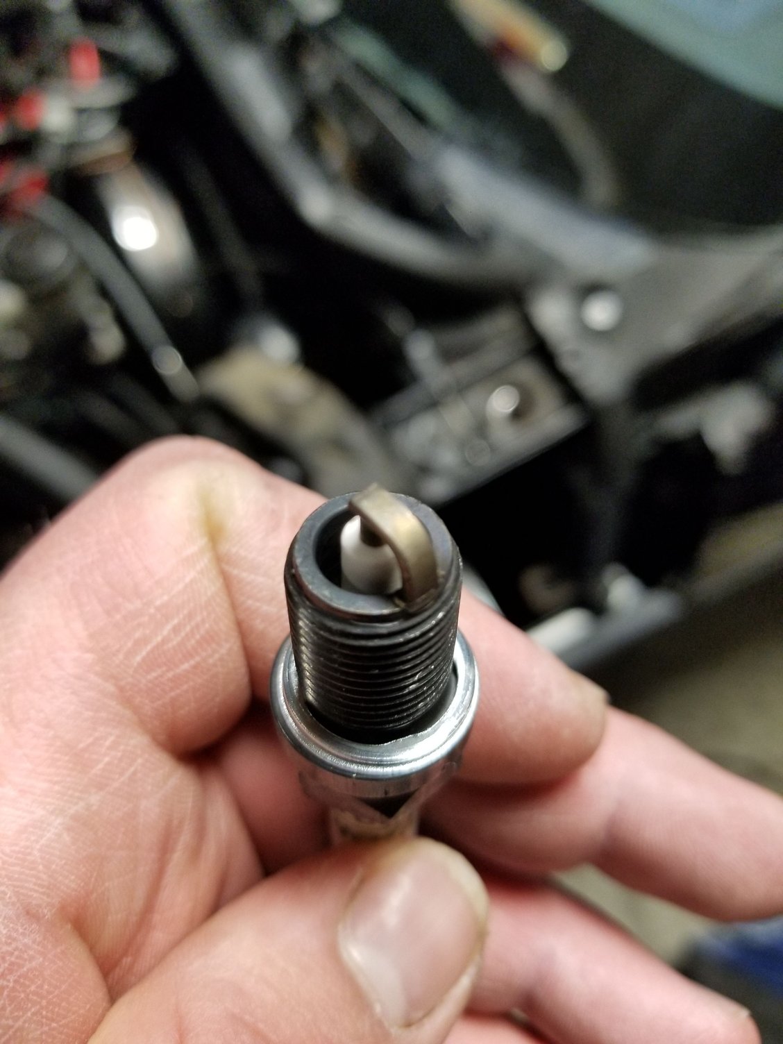

Hey guys just a quick question. Last night I was verifying my timing hadn't moved with a timing light and noticed that out of every 10 flashes or so only 8 or 9 would go off... read a noticeable miss on flash. I want to lean toward plug wires, even though they're like brand new as well as the cap and rotor and plugs. The only other thing I could think the plug is a bit fouled?
So I pulled number one out and the whole plug is sooty, not wet, just sooty. I can't really read it but the soot is even, the ceramic is lightly discolored and I can't really see the electrode strap break line. I'm half wondering if I should lean out the idle AFR and go from there. It is sitting around 14.0 at idle on the wide band and I'd imagine 14.7 would be a bit better. Just trying to figure out if I should start replacing components. Car drives fine, don't feel a miss and don't feel down on power but who knows.
Thanks in advance.
-Paul

Hey Paul I get this with my plugs as well. Sooty plugs mean that the plug is running too cold and can’t self clean. I run NGK 5s which are a pretty hot plugs so in my case I think my tune is too rich. I have been chasing this for a while through logging but I don’t have the answer yet. I know my engine will idle at around 14.7 AF. If I lean out at idle the engine will hunt and I wouldn’t want it any leaner anyway. When making power my engine seams to like about 12.5 AF. I think my VE tables are ok so the issue might be in closed loop. Could be the CTS enrichment, I’ve noticed that the CTS reads about 10deg C colder than the dash. So I could be getting too much enrichment if the CTS is wrong. It could be the INT or BLM targets but I just don’t have definitive data at this stage.
Anyway sorry I don’t have an answer for you apart from the fact that the plugs won’t self clean if they are too cold and that’s normally because the engine is running rich.
I'm running 7s so that could be an issue. At the same time these plugs have a bit of run time at idle on them figuring out the tune so maybe a new set first then retest. Thanks!

Most likely the inductive pickup on your timing light is occasionally not picking up a pulse.

NGK 7s are quite a cold plug and generally something you would see on the track were the engine is run hot and flat out. Factory equivalent NGK is a 5 so you could try that.

I would think you need to pull a plug from another cylinder before determining the cause. Is it isolated to cylinder/plug on just #1 or are they all that way? You could have a leaking or failing injector? Could be the wrong heat range if they all are exhibiting the issue, or could be your AFR is a little rich, but I would want information from more than one plug before determining the corrective action.

He has a crossfire so it’s a wet intake manifold like a carby. I agree that it is wise to look at more than one plug but in this case I expect they will all be a bit sooty. I definitely think NGK7xxx are too cold. As a rule I would fix the issue before changing the plug heat range however in this case I think the heat range might be the issue.

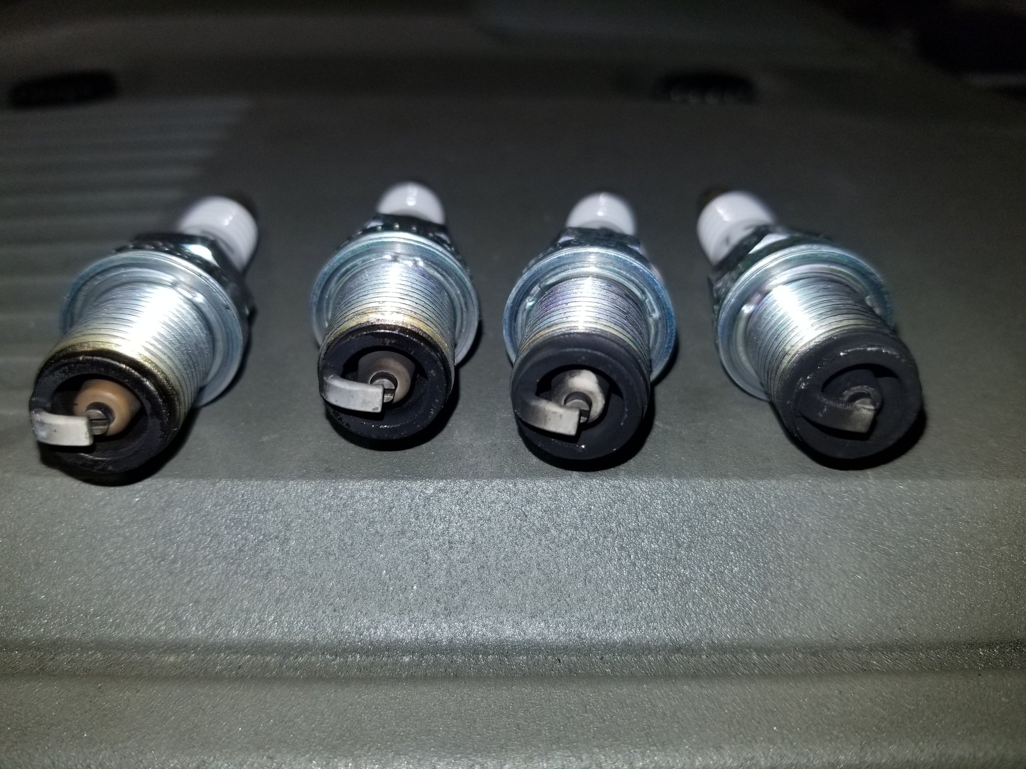

I'm going to pull all the plugs today but last time I drove the car I took her up to about 5200 rpm and the thing just fell over on its face while also sounding like it was either breaking up or missing. All the ignition components are new so I'd suspect plugs first but I'm not sure at this point. More digging is required. It could also just be that it is running out of the ability to breathe through the stock intake but I wouldn't think it would sound like that... I'll keep you updated.

1 3 5 7
8 6 4 2
To me it seems the heat range is a little cold and the tune is a little fat. This was after a hard rip where I just dropped it in neutral and rolled into the garage. Appears to be even atleast.

Yep I’d agree with that. They are not too bad thought, so small adjustment only. I would try NGK5s and try that for a while.

Kind of what I was thinking. I'll lean the idle a little bit, being 15:1 won't hurt much at idle anyway and trim the whole curve some.
Try to see if I can find plugs locally and at a reasonable price. Those plugs otherwise have a lot of idle time on them still.

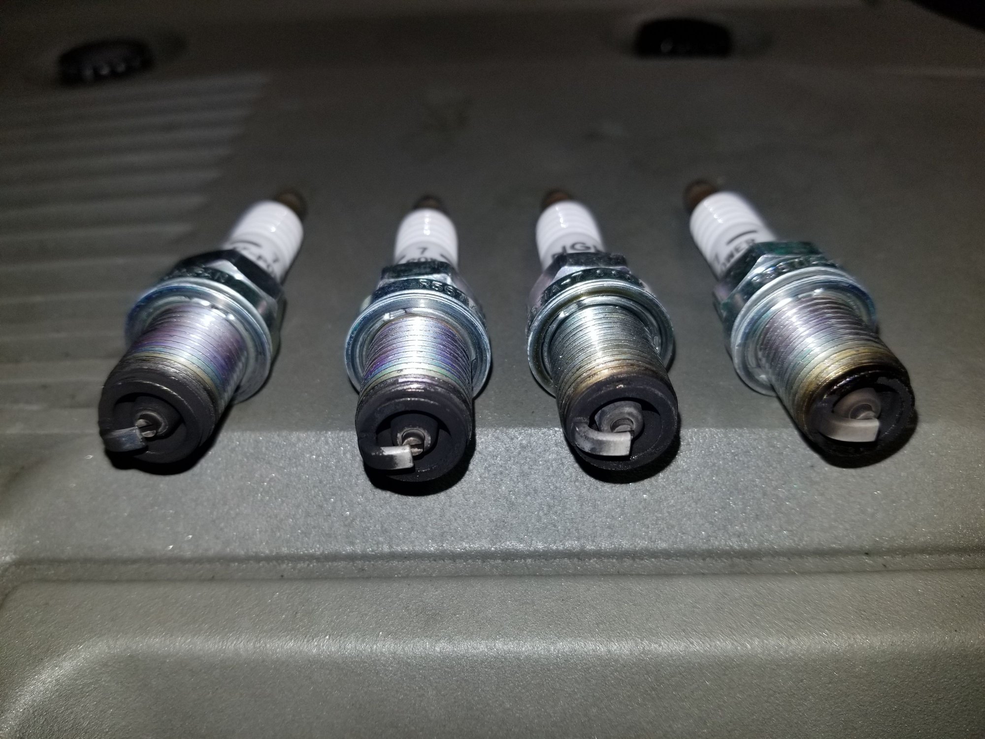

So they didn't have the NGKs but they actually proce matched me a set of delcos that were a direct cross reference. More defined idle, power feels more on demand than it already was and get this... timing light works as it should now too. I did a hard 1-2 pull up and down the street and pulled #3 as it is the easiest to get:
Looks about right to me, light color on the ceramic, part line on the strap is in the middle of the bend, and light soot just about one turn on the base not heavy like before. Idle AFR is stable at 14.
Now I still have something going on at wide open but it would seem like this... watching the data log closely, as move above 5000 rpm my afr starts to decline from 12:1 to around 11:1. Now where it gets bad is right before the breakup happens the afr further drops to about 9.8:1.... which to me seems like my wide open isn't actually a break up so much as it is just too rich to burn right. Make sense?

There is a power enrichment table that you could look at. Also the timing should drop back a bit a WOT to about 36 Deg IIRC. I’m at work now but it can check when I get home. I can send you through my tune if you want, obviously the VE tables will be different but it still might be good to compare some of the other tables.
