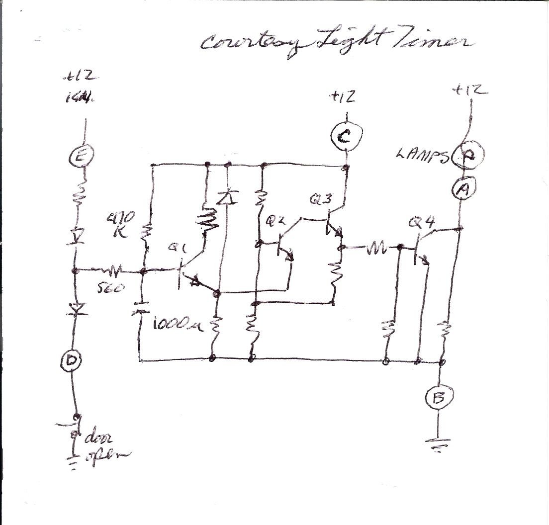

I'm sorry, but I do not understand what you are talking about. Here's a diagram of my '84 interior lights delay circuit:

This is what I probably need I need to go to the passenger side of the car and look underneath the bread basket I believe this is located there but getting to it might be a problem I know there’s a relay and a boardThat will probably need replacing we will take a peek when the weather gets better still a little chilly here in the New England area again thanks for the info deeply appreciate it
