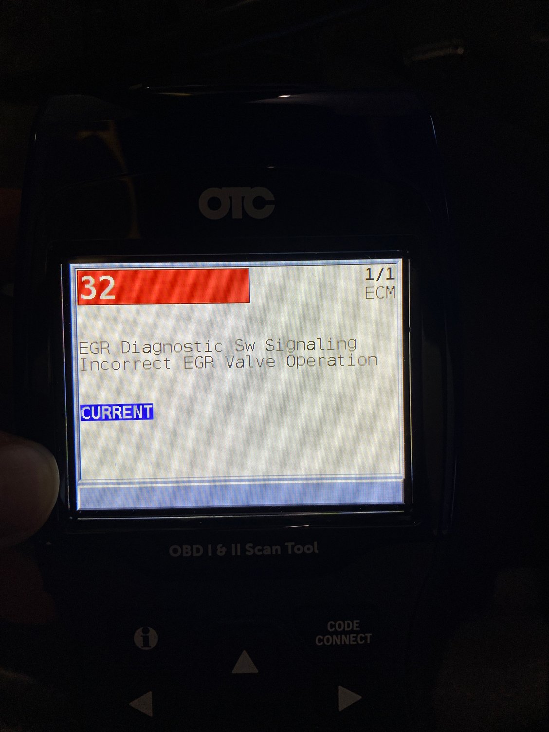

Check Engine Light Code 32
Old Feb 27, 2020 | 11:16 PM
junkyard_dog72's Avatar
junkyard_dog72
Joined: Jan 2014
Posts: 881
Likes: 221
2021 C4 of the Year - Modified Finalist
C4 of Year Finalist (appearance mods) 2019
2016 C4 of the Year Finalist
Default Check Engine Light Code 32
I know I'm not the only one to have dealt with this and I know I won't be the last, but I have the infamous Code 32. My light on the information display does not work so I do not have any idea when it came on. I recently hooked up my OBD 1 scanner and take a couple of data logs with it. I put them in an Excel chart and hopefully someone on the forum can interpret the data a little bit and give me an idea of which part of the EGR system is at fault. I also plan on following the factory service manual instructions on diagnosis, but have to wait a little until it warms up here in Ohio(no garage). The current drivability issues are the need to warm it up before going anywhere. If I just do a cold start and try to touch the gas it tries to stall out. While driving if I let off the gas it surges a little bit. Thanks for taking a look and offering any ideas!

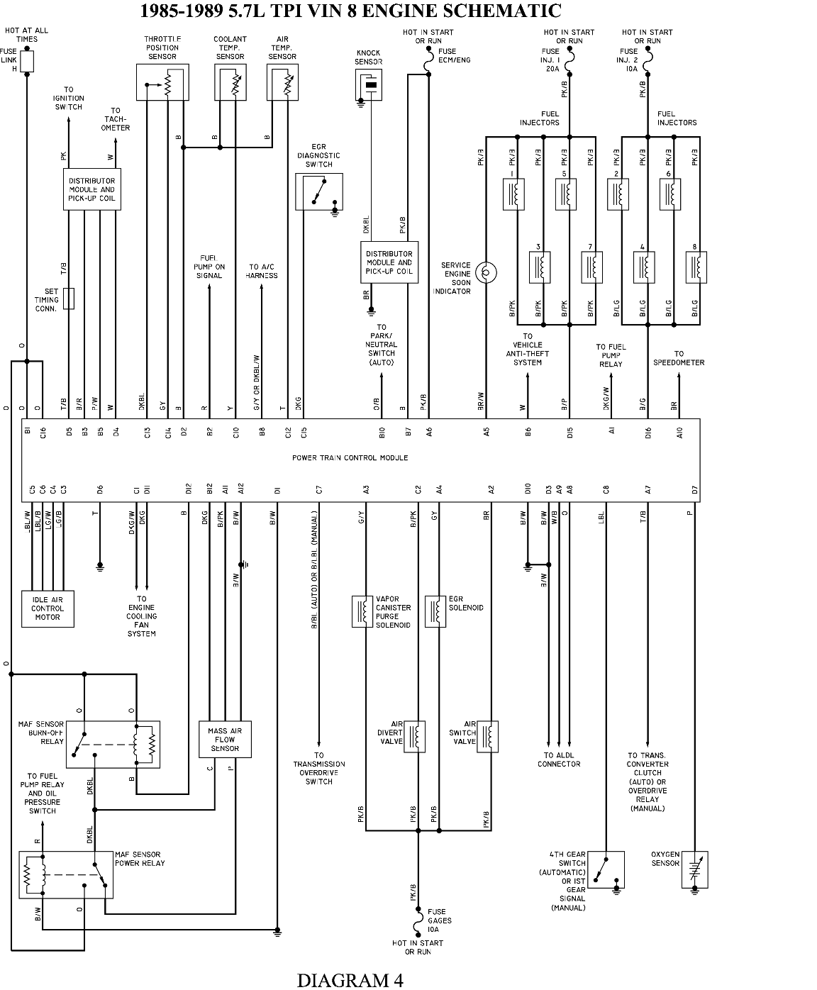

Okay a 1985 does have a "EGR diagnostic switch" which I assume is a temperature operated switch that closes when heated by the gas flow while the EGR is open. Should be easy to measure voltage accross it when open/cold and near zero volts when hot/closed - once you locate it. The EGR is solenoid operated and you should see a voltage drop across it when energized and no voltage drop across it when it's not energized by the ECM. I you verify good operation of both of those then you may have ECM issues.
Here's the AutoZone drawing I used:
1985 diagram
Hope this helps.

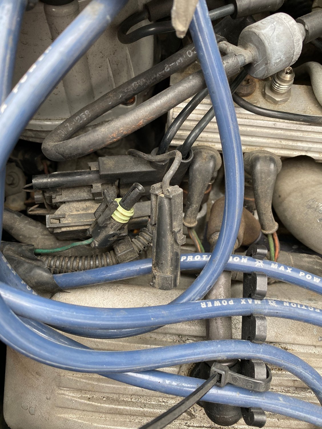

Would this be the correct weatherpack connector? I disconnected it and started the car up per the FSM and it has an instant on CEL. Also still wants to stall out when touching the throttle. FSM advises to check CKT935 for a short but I have no idea what that is.
All in all, I'm still working on it and making some progress. I managed to diagnose a little bit today between the storms and the sudden drop from 70 to 30 degrees.

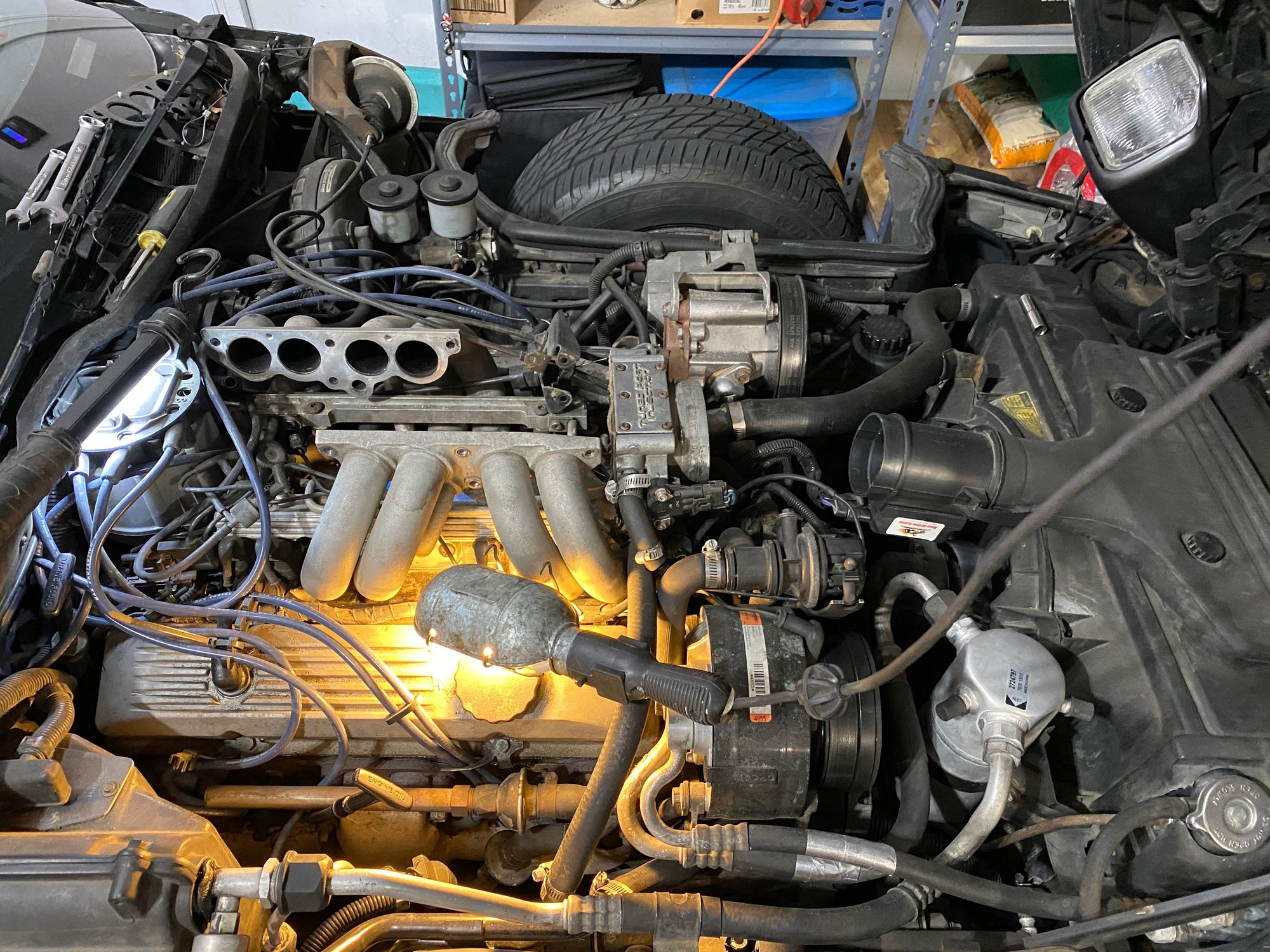

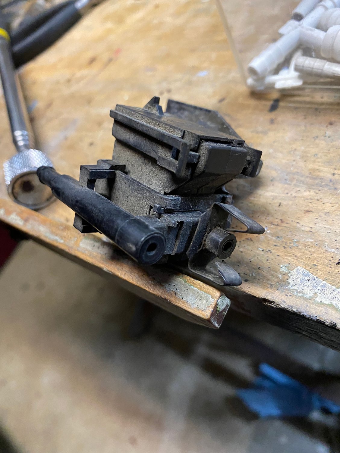

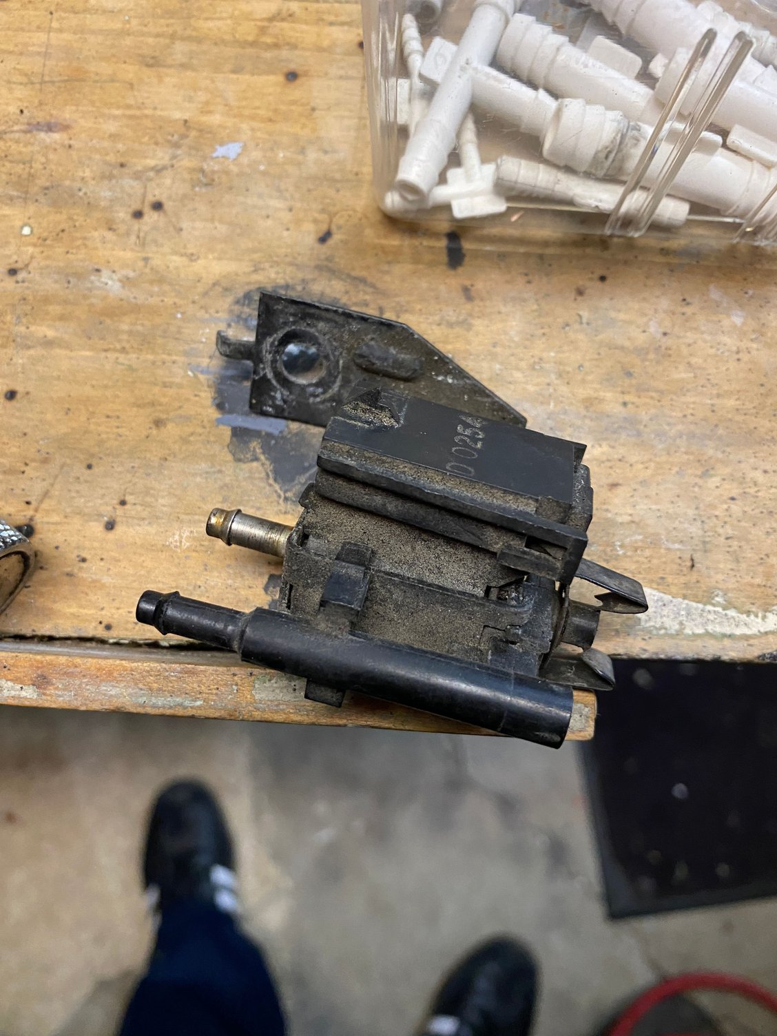

I finally got around to trying to solve the Code 32. First I switched to a different computer from an 85. It did not solve the issue at all so I moved to the next FSM suggestion which was a bad EGR temp sensor. I replaced that with a used one from a forum member who was local. I also replaced the EGR valve and the solenoid while I had everything apart. It did not fix the issue and after reconnecting the battery and restarting I still had code 32. When starting cold, the car idles fine. However if I touch the gas, it bucks and occasionally pops out the intake. If I let it run for 5 minutes I have no issues. My next question is about the solenoid. It appears as if there are one or two spots for vacuum hoses on the back, one in particular seems to have a clip of sorts. The front is connected with two hoses and a rubber L shaped connector for both. Am I missing a vacuum hose for the rear(last picture)? I'll attach the pictures below.
Im certainly tired of posting about this and fighting it but hopefully someone has some insight. Maybe it can help someone else. Thanks for taking the time to read this
