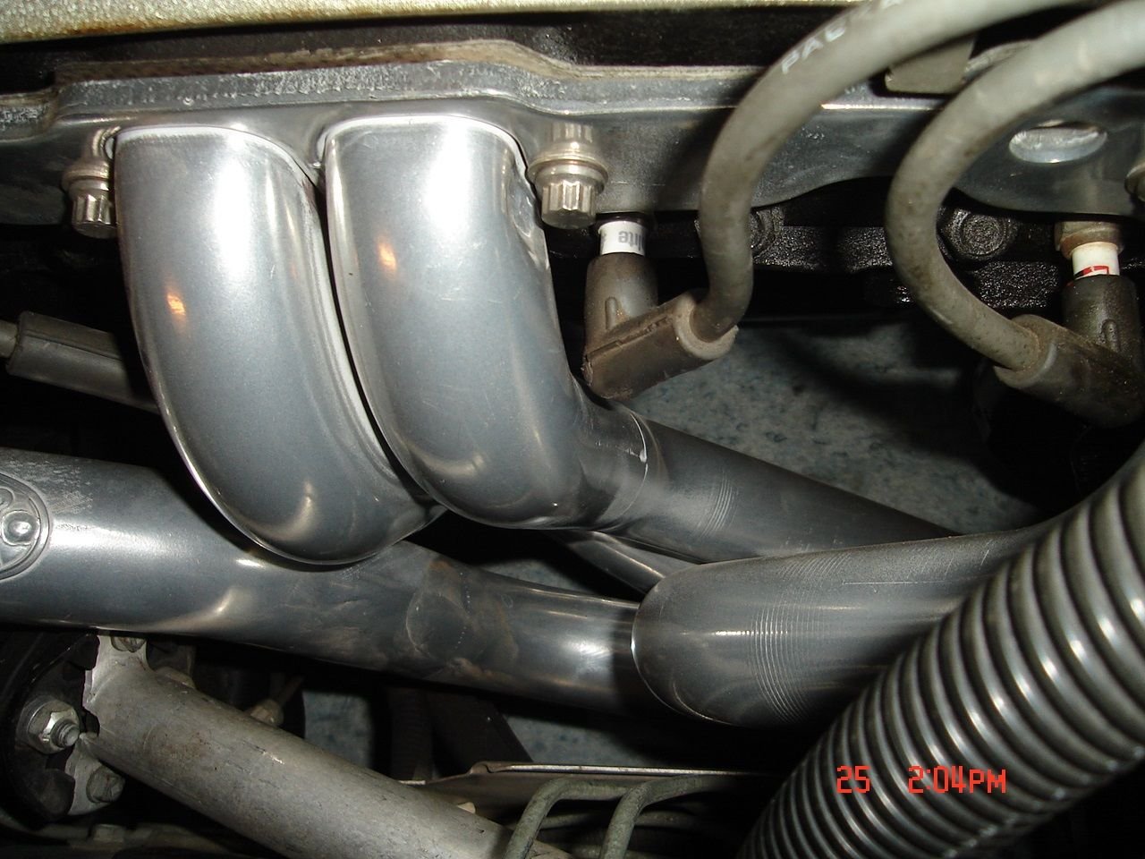

When i first put my Hookers on my 86 I still had the factory iron straight plug heads. I had the same problem,if I remember correctly,was number 5 plug. I just used an autolite race plug in that spot until I changed to angle plug AFR's. I have all kinds of room now with the angle plug AFR's. The angle plug afr heads are listed as having an "L98 angle" which is not as extreme as the normal angle plug on a set of Chevy bow-tie heads. I will say this also. when I had my angle plug afr's in the shop I also had a set of straight plug afr's that were for a Malibu i was building. I noticed that the straight plug afr heads worsen the plug location condition over factory heads because afr moves the spark plug off center in the combustion chamber. It was not a problem with the Malibu headers but I noted that a saw big problems with the corvette headers. the direction the plugs were moving was right into the header tubes.

I found this old picture . yes,it was #5 plug you can see #5 is off the tube now with the autolite race plug. #7 on right still has a full size plug.
