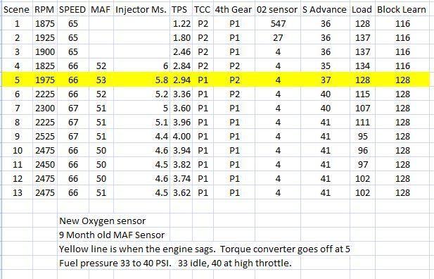

Here is what the Scan Tool reports. I started the "movie" about 4 frames before I accelerated or attempted to. at Scene 5 is when the Torque converter went out of lock and the performance flattened. I hope the formatting holds up as I try to list the readings. I've also attached a picture of the spreadsheet if it doesn't. The oxygen sensor is brand new. The MAF sensor was replaced about 9 months ago. The MAF readings and the air flow readings always match.
Scene RPM Speed MAF Inj. Ms. TPS TCC 4th Gear 02 Sensor Spk. Adv. Load Block Learn
1 1875 65 1.22 P1 P1 547 36 128 116
2 1925 65 1.80 P2 P1 27 36 137 116
3 1900 65 2.46 P2 P1 4 36 137 116
4 1825 66 52 6.0 2.84 P2 P2 4 35 134 116
5 1975 66 53 5.8 2.94 P1 P2 4 37 128 128
6 2225 66 52 5.2 3.36 P1 P2 4 40 115 128
7 2300 67 51 5.0 3.60 P1 P1 4 40 107 128
8 2225 67 51 5.1 3.96 P1 P1 4 41 111 128
9 2525 67 51 4.4 4.00 P1 P1 4 41 95 128
10 2475 66 50 4.6 3.94 P1 P1 4 41 96 128
11 2450 66 50 4.5 3.82 P1 P1 4 41 97 128
12 2475 66 50 4.6 3.75 P1 P1 4 41 102 128
13 2475 66 51 4.5 3.62 P1 P1 4 41 102 128
IMAGE OF SCAN TOOL DATA
Old Mar 11, 2020 | 01:49 PM
Mrvettenick's Avatar
Mrvettenick
Joined: Aug 2019
Posts: 1,339
Likes: 225
If your reading of the O2 sensor is correct, a reading of 4 millivolts indicates a lean condition. Even though fuel pressure is OK, have you checked volume? When was the fuel filter replaced?
Also, is this thing going into closed loop? I see your block learn is midstream,
Old Mar 11, 2020 | 02:20 PM
Beasleyrb's Avatar
Beasleyrb
Joined: Mar 2020
Posts: 16
From: Van Buren, Arkansas
Yes it is in closed loop and yes It is lean during these scenes. I assumed that was because the injectors were not opening long enough. The fuel pressure is within the tolerance the FSM gives but it is on the low side of the tolerance. Maybe the pump is weak? I know the relationship between pressure and flow and have wondered about the pump. Maybe the sock in the tank is clogged and creating a restriction? I put an new fuel filter in it about 6 or 7 months ago when it started acting up. The old one was not clogged at all. I was going to pull out the fuel pump today but waited until I showed you the numbers thinking something else may reveal itself to you. If I undersand it correctly the ECM commands the fuel injectors and the millisecond drops and is low per the throttle position voltage. At this TPS voltage when it was running well one time the injector Milliseconds was around 11 or greater and the MAF was flowing well over 100. The engine was pulling and breathing well when it got the fuel it needs.
So, if the fuel pump isn't supplying the volume of fuel will the ECM's signal to the injectors be decreased. The low injector command by the ECM may be due to other sensor input it is getting that is telling it to do that. Hell, I've tried about everything else. I might as well put in a new fuel pump. Would that be a next good move? Thank you for your replies.

Old Mar 11, 2020 | 03:08 PM

It doesn't hurt to replace it if its failing but I'm not convinced from the data posted that it is. I'm leaning more towards fuel pump or another delivery problem.

Hi Darth, the oxygen sensor is brand new. I installed it two days ago when I put a new exhaust system in. These readings were with the new sensor. Agree with fuel pump or delivery issue. I'll work on that tomorrow when I go back over to my son's shop where the car is. The old sensor never read bad. It delivered readings all up and down the scale. I replaced it anyway. They are not expensive.

At any time does your block learn go above 128? That's actually the mid point of fuel management. When you accelerate, MAF and fuel inj pulse should increase together, as that happens, the block learn should go above 128, which means the ECM is trying to add fuel. Based on your data, and your description, if the ECM doesn't command above 128, it can't add fuel. I would hold off anything in the fuel dept, until we know the ECM can command more fuel. If you can't get it above 128, there might be something going on with that prom. But take it on a road test to see if, at any time it goes above 128.. If not, I have a few things to do that will trick the ECM to see if it can adjust.
