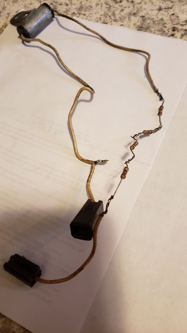

Hello, I'm a new member to the forum. I rescued a 1990 a few weeks ago - my first corvette! - and there's been no end to the surprises from the PO. But this is something else. I've heard you can fix a glitchy tach with the right resistor, but not like this. What do you suppose this person was trying to do here?

Radio ignition interference

When you need a certain value resistor they may not make one with that value, so you have to put several together in series to come up with the value you need. Say you need a 4k ohm resistor and can't find one but you can find 1K ohm resistors. You solder 4 1K ohm resistors in series (like in the picture) and that gives you a 4K ohm resistor. Now why he did what he did I have no idea. Usually, if you're going to make a filter you use a capacitor or a capacitor and a resistor together.

One more resister would have worked better.

I believe there's a schematic for that Tach filter on this forum somewhere but if you like I can try to dig up the one I have and post it. Let me know.
is this for real?
