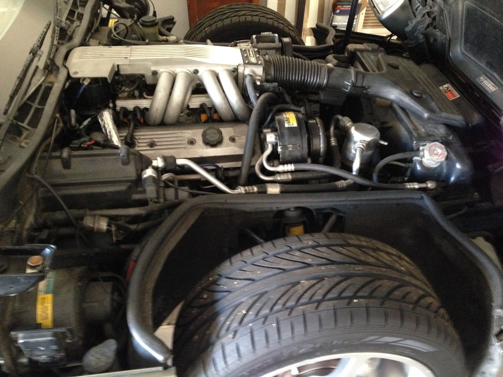

Hi all
about 5 years ago, i parked my 86.
due to constant nagging, i agreed to get it running again.
i had put a 383 in it 5 years ago, and put 1989 corvette alum heads on the engine along with a 52 mm throttle body, adjustable fuel press reg, a ram jet cam from chevy, and it pinged pretty badly.
so now, i put the original 350 heads on the 383, the original plenum and throttle body with the original parts , (TPS, IAC,
cold start sensor, computer temp sensor, etc).
the car has true dual exhaust with bullet cats, 91 vert mufflers, ported original exhaust manifolds, and a 1987 corvette factory chip in the computer.
i unplugged the egr solenoid, moved the MAT sensor to the front of the car.
k&N air filter, high volume fuel pump, 1.6 rockers.
i ran 3 tanks of gas through it with a little injector cleaner.
it’s like the o2 sensor isn’t reporting to the computer
black exhaust.
why?
