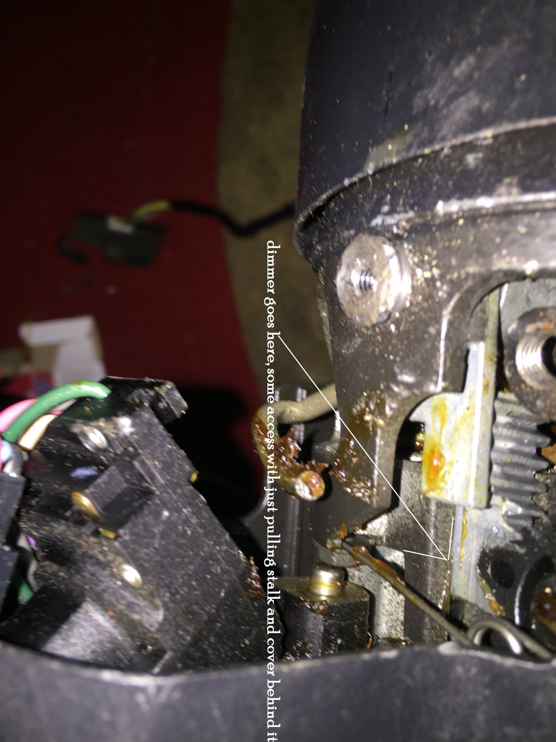

I just went through this....you can put the pivot switch back in place"sometimes" without removing the steering wheel once you understand where it goes (if it isn't actually broke-it may be, mine just came out of place....pull the cap off behind the stalk, the pivot switch is not held in there with anything except friction..... PM me and I may have some pictures I can send... after I did it for the tenth time to get it right, I really understood how it all went together. The forum and registry REALLY helped me out!

Try this first...
