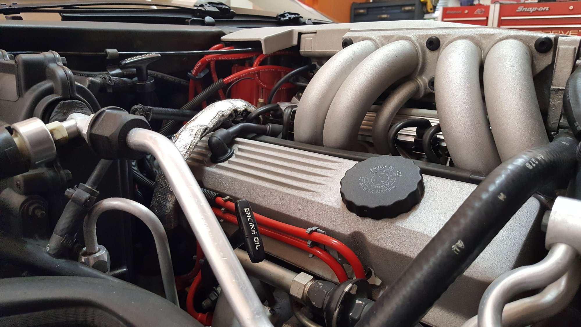

Originally Posted by JDrook
a kazoo is a good way to describe it. Thank you I’ll look into that! Where exactly is that valve located?
See the black circular thing with the chiiping paint next to the red ignition wires towards the bottom of the picture? Thats the diverter valve. Theres one one each side. It seems strange that this was the culprit, but it kind of throws the sound to under the car....
