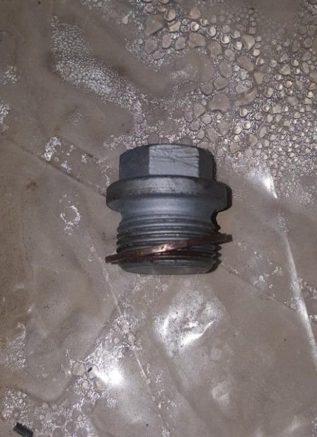

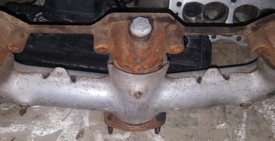

So went out the hydraulic store and found 2, 22 mm block of bolts, fixed with copper washers should do the trick.Though it a cleaner way than welding them up, as if you want to make it stock no problem.

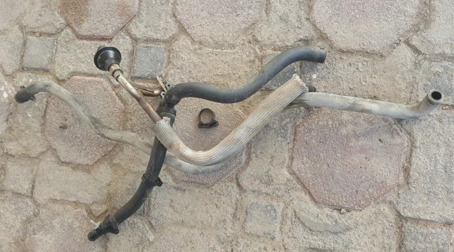

Air pump pipes removed
header with block of bolt fitted
22 mm block of bolt with washer

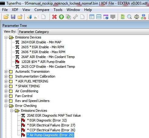

On a 94, you don't yet have OBD2 function testing of the catalytic converters - 96 was the first year for that, and they are the first year to have post-cat O2 sensors. So you won't get that trouble code (DTC). However, if you remove the electric air pump then I believe you would get DTC 29, "Secondary Air Injection Pump Circuit." I can think of two possible ways to avoid that. First, you could figure out the resistance and/or voltage the PCM expects to see on that circuit and try to rig something to simulate it, kind of like a skip-shift eliminator. It would probably just be a resistor in line with a signal. I wonder if anyone else has already figured out what to do? Second, and probably the best option, is to disable it in the PCM tune. I know for a fact that Tunercat has this feature (see pic below). It's not an expensive product and IMO it's well worth having. I don't know what other tuning software is available for 94/95 cars these days, so I can't say if they all allow this to be turned off or not. But that's how I'd do it.

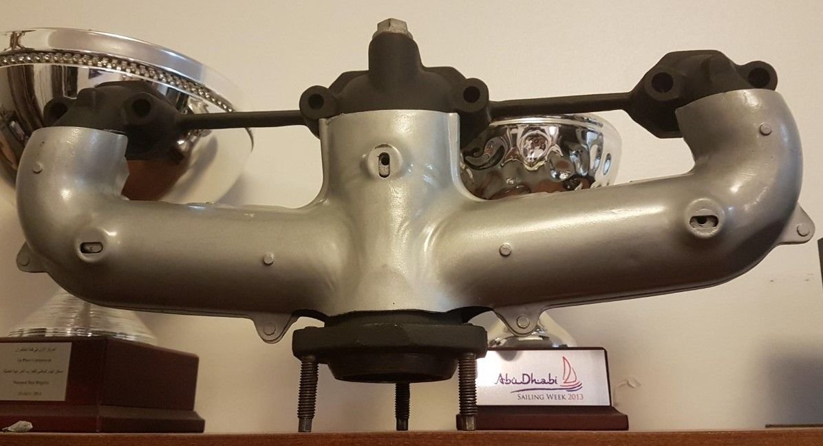

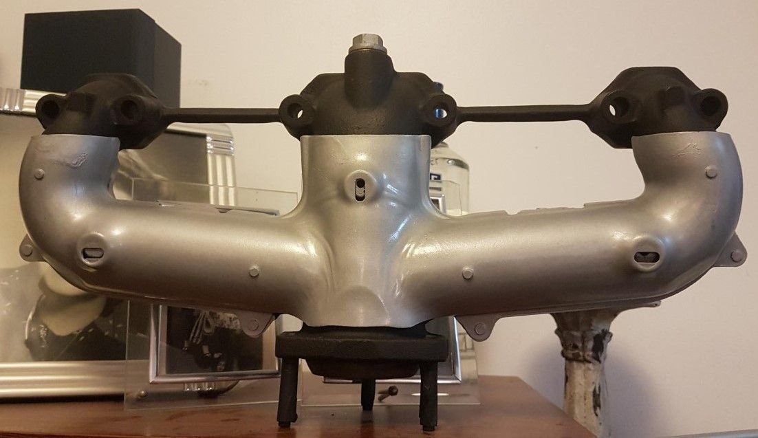

So this is what the manifolds look like now, on the TV cabinet, painted with matt black Rustoleum 2000F paint, well see how it holds up. Sharp castings ground down, hopefully that will help with spark plug installation.The air pipe has been removed and plugged on one side with a bolt and inside with Hylomar Exhaust Putty, to smoothen out the manifold.

There is no longer any need whatsoever to spend money on TunerCats.
TunerPro is free-as-in-beer, and is far more feature-rich thanks to an XDF definition for the $EE (of which 94-95 Corvettes are included). So it can do all the same tuning TunerCats can and way, way more.
For flashing to the car, Fbodytech's Flashhack is superior in every single way to WinFlash/TunerCats. It's lightweight, free, open source, and includes the ability to install a recovery ROM to make the process essentially brick-proof. With WinFlash/TunerCats, if something happens during the flash process, your PCM is a brick. Not so with Flashhack.
So for the cost of just the USB-to-ALDL cable, I'd take that route instead.

Honestly the learning curve isn't too bad for doing basic things like disabling features or error codes. Doing tuning yourself will require some education, but if all you want to do is disable emissions devices, it's not bad at all. There are plenty who would be willing to help you through the steps, myself included.
Originally Posted by MatthewMiller
I recently saw another post of yours about this (after I posted what you quoted, though). If I still owned my car, I'd definitely be looking into this option.
Absolutely. As recently as last year WinFlash at least was still a better flash tool for some vehicles. On my dad's '94, for instance, there seems to be an odd communication problem where the ALDL is noisy and so it won't stay connected properly. WinFlash was able to get past the noise and flash successfully several times, whereas the free alternative would have been too risky to try. Now the free alternative not only has a more robust communication routine, but also the aforementioned recovery patch so that even if something were to go wrong, you could pick up where you left off and not end up with a brick (which is what would happen were WinFlash to fail).
