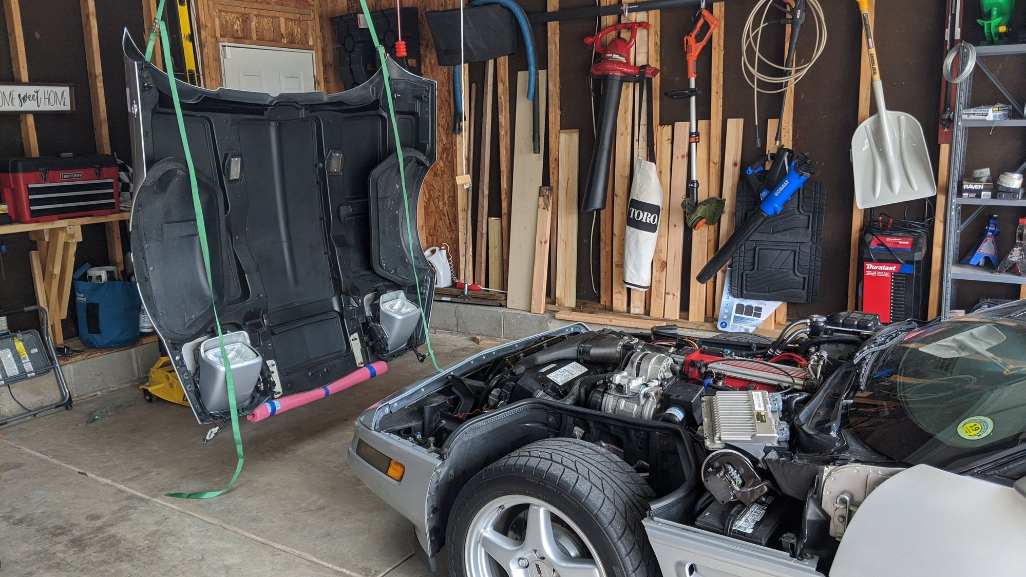

Bonus photo: I tied up some loose ends while sheltering in place. Removed the hood since I was in the front end for a few weeks. This was my method for replacing and adjustment. 2 tie straps and a pool noodle.
