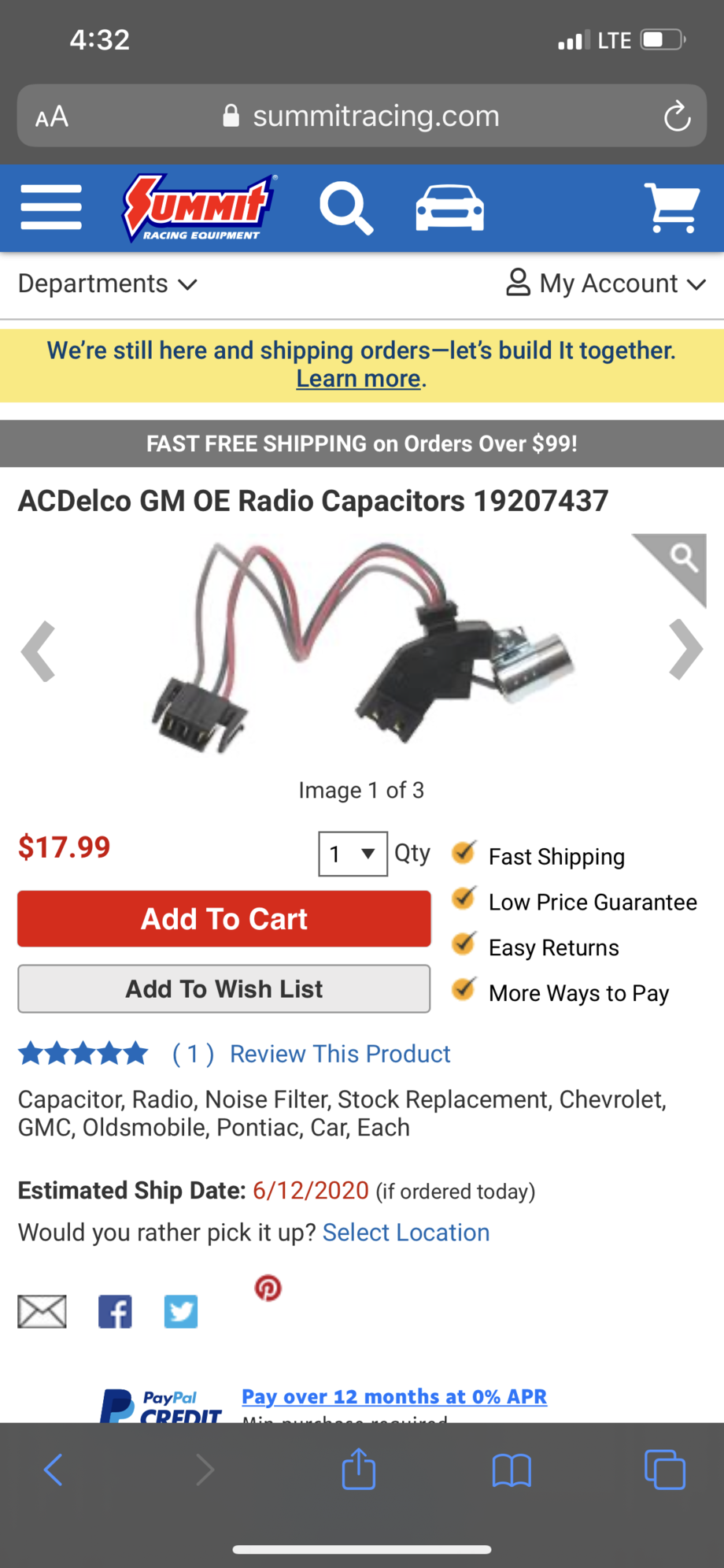

Both pics below I should be fine with both of these for my 84 corvette right guys? I just need to replace my originals there very old. I bought both.

**That module should work for a stock large cap HEI dizzy 1984 corvette.
