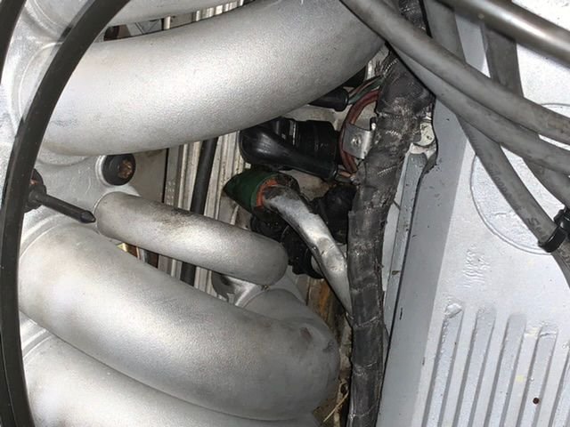

i also found a Vacuum leak on this tube. Is on The drivers side underneath the plenum. I think it’s EGR related? I put some RTV on to seal it up.
