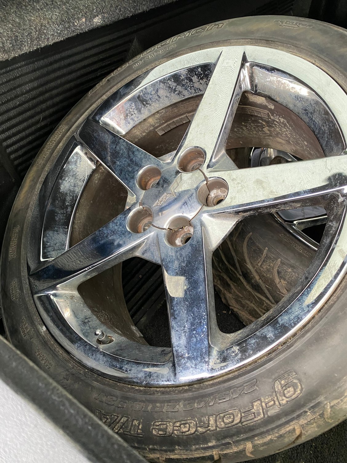

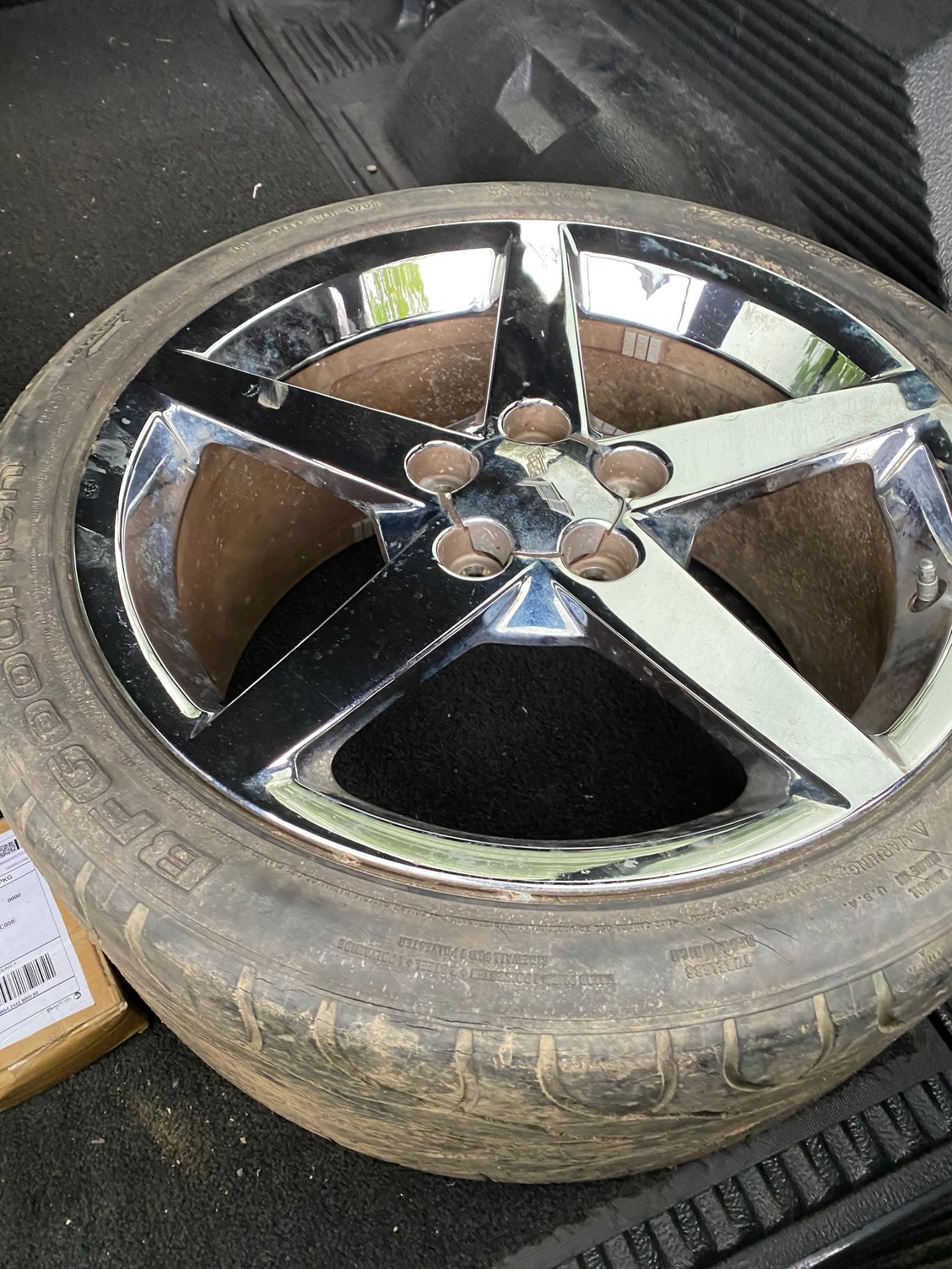

Heres the wheels i have. 9.5 & 10.5 width

I don't think so. I'm pretty sure those are from 2006-2008 in sizes:
  • 18x8.5 et 56 fronts: will need 1" spacers.
  • 19x10 et79 rears: will need around 1.7" spacers.

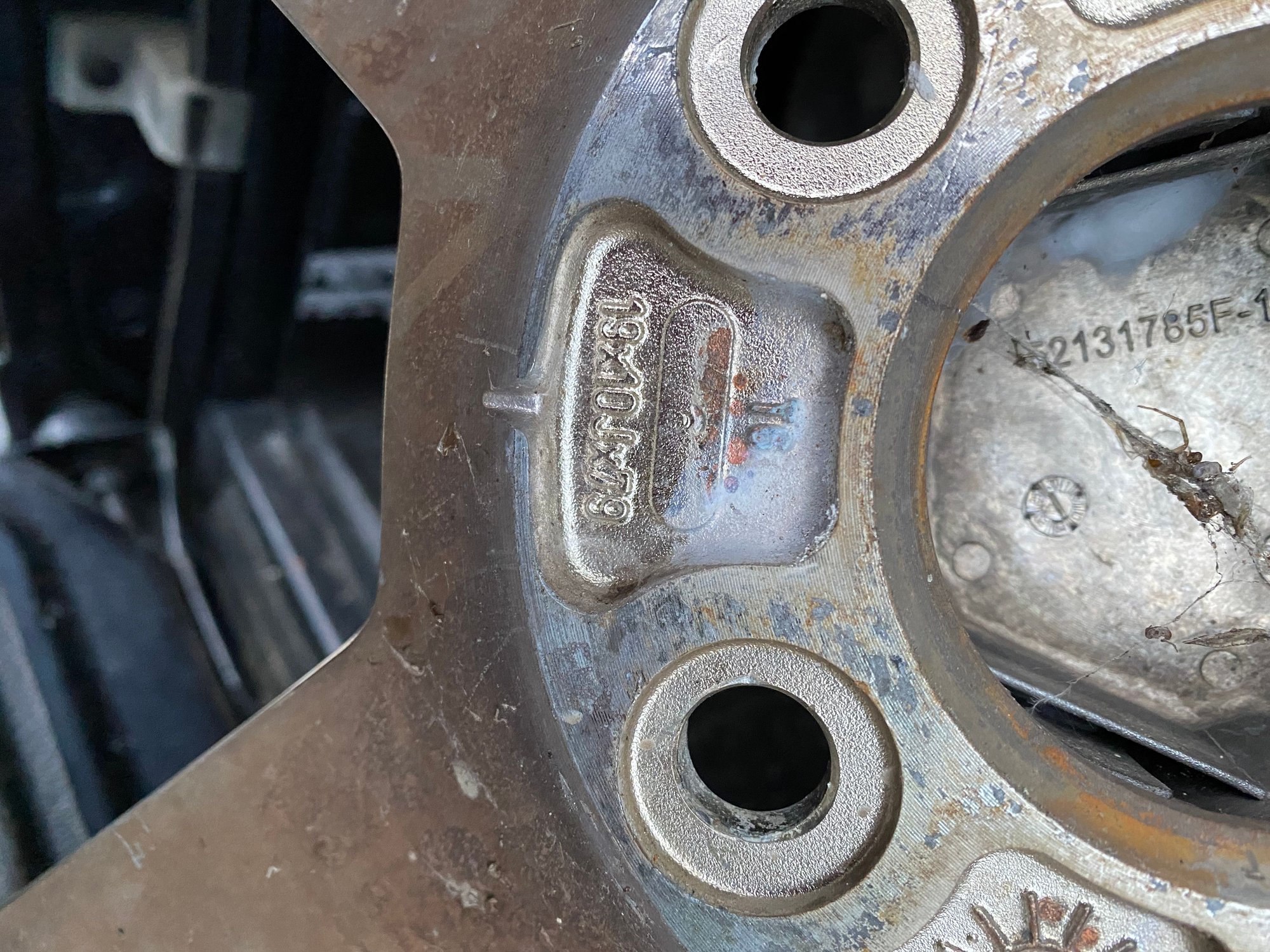

That is, these are the specs if those are legit original equipment Corvette wheels. If they're reproductions, then all bets are off. You should look on the back of the spokes for stampings that verify the exact size and offset. It's the only way we can give you certain advice. If you're not sure what numbers you're looking at back there, take pics and post them and we can help you sort it out.

Well. That made things easier. Lol

  • So to get the exact fender placement as stock, the front will want 24mm spacers (56mm-32mm). 1" (25.4mm) is completely fine, or you have wiggle room to space them a little wider with thicker spacers if you want (you can set them in a little, too, but that looks a little odd).
  • For the rear, the stock 9.5 had 38mm offset (I was off by 2mm previously, and I'll go back and correct that post). To center your 10" rears in the same location as stock 9.5s, you'll need 41mm spacers (1.61"). With that, you're getting pretty close on the inside, but you could push them outside a little more if you wanted, so perhaps 1.75" (44mm) would be easier to find and they'd work well.
I don't know what's available out there. For the rears, you're probably looking at adapters instead of spacers, so I think you might as well do adapters for the front, too. I'm sure 1" adapters for the front are plentiful, and I think 1.75" adapters will be out there as well. Show us a pic of the final product, and feel free to ask any other questions.
