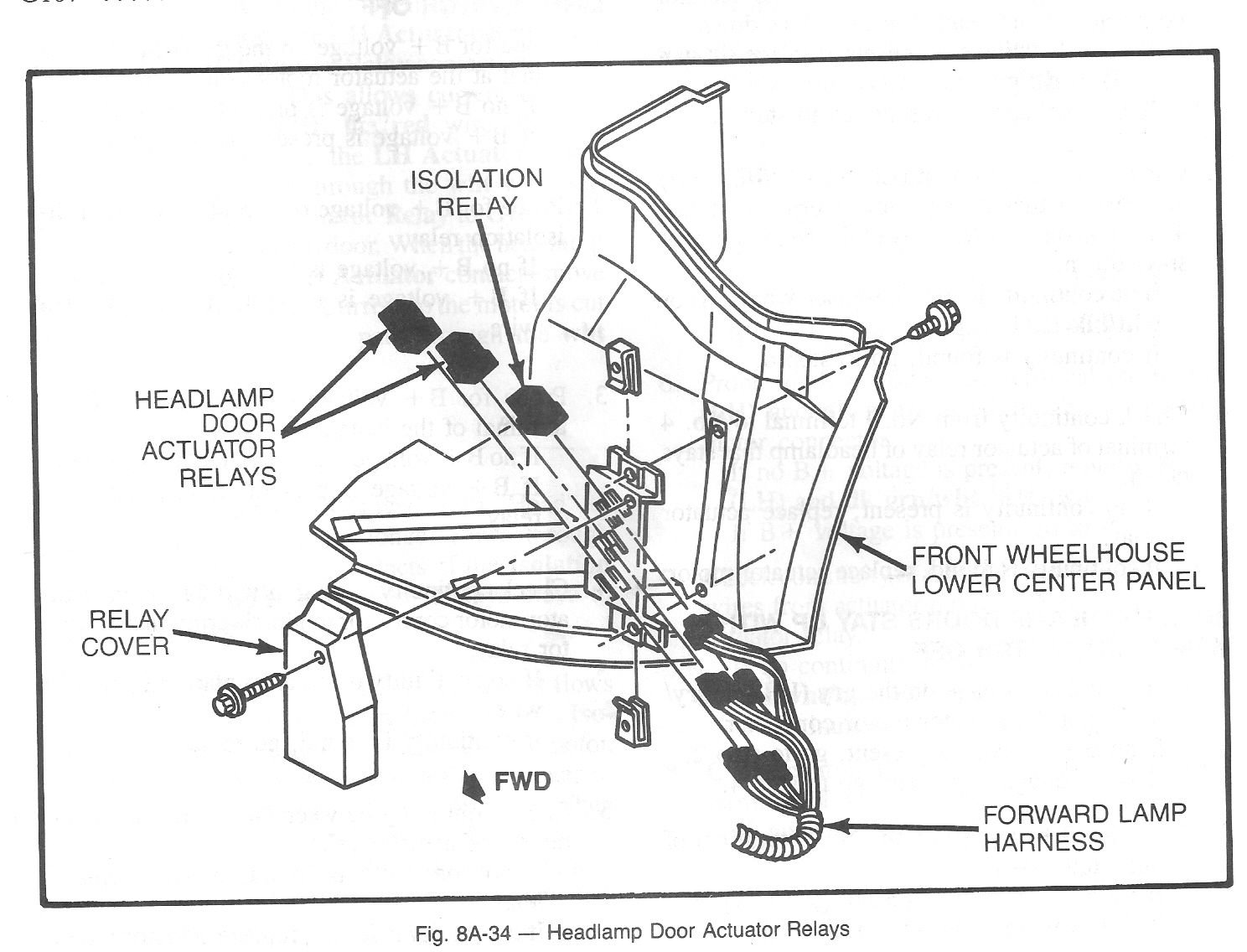

Unfortunately, GlenX has a '96, which has headlight door motors that are entirely different than your '86. Finding a good YouTube video on the '84-'87 headlight motors is impossible! To quickly sort out whether the YouTube video is correct (I haven't found one), the '84-'87 headlight motors have the manual control ***** on the BOTTOM of the motors. The '88-'96 have the control **** on the TOP.
Let's take this one step at a time.
1. Raise your hood.
2. Turn on the headlights. The doors should open.
3. Twist the **** on the bottom of the motor. Caution: The door may rotate quickly! Keep your arm out of the way!
4. If the motor spins, the problem is dirty limit switches inside the motor.
5. If the motor does not spin, you may have a bad relay or worn motor brushes.
6. Try exchanging the two bottom relays, which are under a cover in front of your LH wheel. Does this cause the other headlight motor to malfunction?

OMG Roy, thank you so much. This forum is awesome. I will try that and let everyone know what I found.
I found an outstanding utube video on replacing the headlight so I'm good there should I need to replace the motor. But I like the electrical checks first. I only have 58K miles on a 34 year old car, and I would say I used the headlights less than a 100 times b/c I rarely drive at night, so it's odd the motor would go bad.
I know when I was a kid, the starters in the 60's use to have sticky brushed all the time and would tap the starter w/ a wrench or hammer and it almost always worked. However I'm not hearing any noise whatsoever in the motor when I turn the headlights on, so I'm am leaning toward the relay. Exchanging them is genius. I'll update later.
