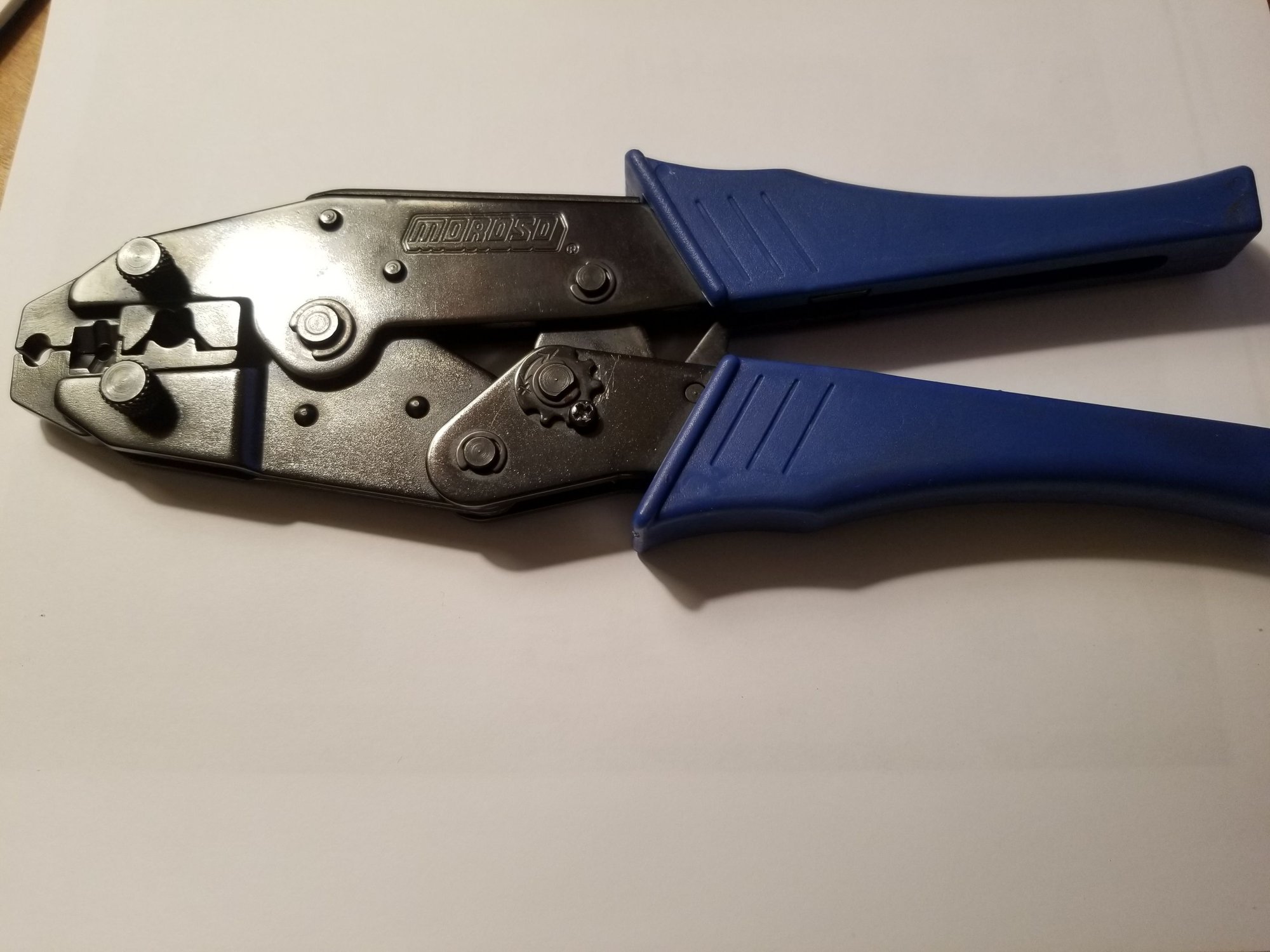

Like I mentioned above, the choice is yours. I don't worry about the price of any tool I have, even if I would only use it one time. If I need something to do the job right the first time, I buy it. I have collected a few tools that I know I probably will not use it again, but if I need it, I have it. The one you are looking at would probably do the job, I guess. I do not have any first hand knowledge of that tool either way. The terminals come either single or double like you stated and I prefer the double crimp and they can be a tad more finicky to install, but that's just me. After looking through the terminals that are provided by Pertronix, they are the single crimp type and the 50 pack of MSD crimps I bought are double. I just tossed the singles into a container. I measured each wire after making them and never saw more than 60 ohms per foot using the MSD 8.5 wire. I can not say that about the ACCEL 8.8 wires that I replaced which were all over three times that amount on all of them. Do I think that makes a huge difference? Not really, but resistance is resistance even with a large amount of voltage. I like having less resistance.
One more thing, I believe those boots are for 8mm wires? I have 8.5mm. If your wires are 8.5 or more, you WILL need some silicone to put on the wire to slide easily into the boots, once there you are golden. I tried some 8.8 wire into them with silicone and they worked OK, but a tad harder to get in. 8.5mm was OK for sure. Just thought I'd mention that. Good luck with your project.
Here is the double crimp pliers I have and work just fine on single and double crimp terminals.
